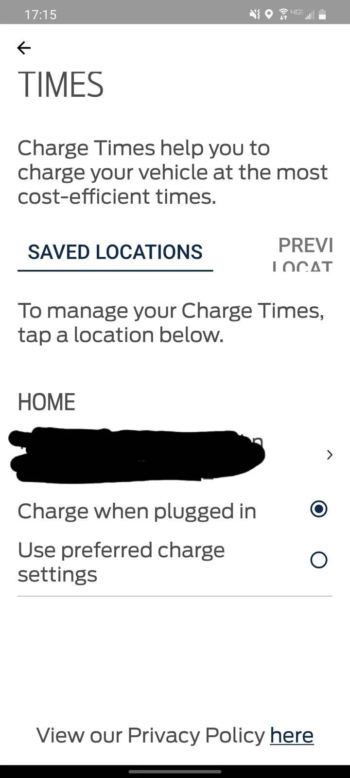

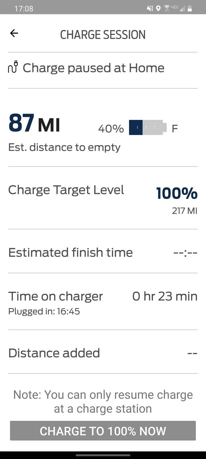

Having the same issue. Worked fine for several days. Using the supplied Ford charger, on a 240v.
Ford Mustang Mach-E Home Level 2 Charger Issues Screenshot_20210222-170834_FordPass
Ford Mustang Mach-E Home Level 2 Charger Issues Screenshot_20210222-171502_FordPass
fallguy
fallguy
Feb 17, 2021
213
321
The south
2020 Defender, 1968 Mustang, 2021 Mach-E GT
Federal
I'm not going crazy then. :(
Nope. However, good news is it charged. The charger was yellow when I took the photos, and there were no lights on the plug where you plug it in. When charging they are blue with the last one glowing.
Unplugged the charger from the 240v, plugged it back in. Turned to blue from yellow. The plug on car turned to normal blue. Car and app still said vehicle paused. Turned car on, back off. Car said charging. I checked it a few times last night and it was charging. Woke up and at 100%.
App still says paused and same percentage as in the pics I posted. My wife's app says the same thing. I have android and she has apple. I uninstalled app and reinstalled, same thing. I've reset every scheduled time and departure, and any other settings related to timed charging.
So it charges, just doesn't show on the app. Hopefully it corrects itself.
