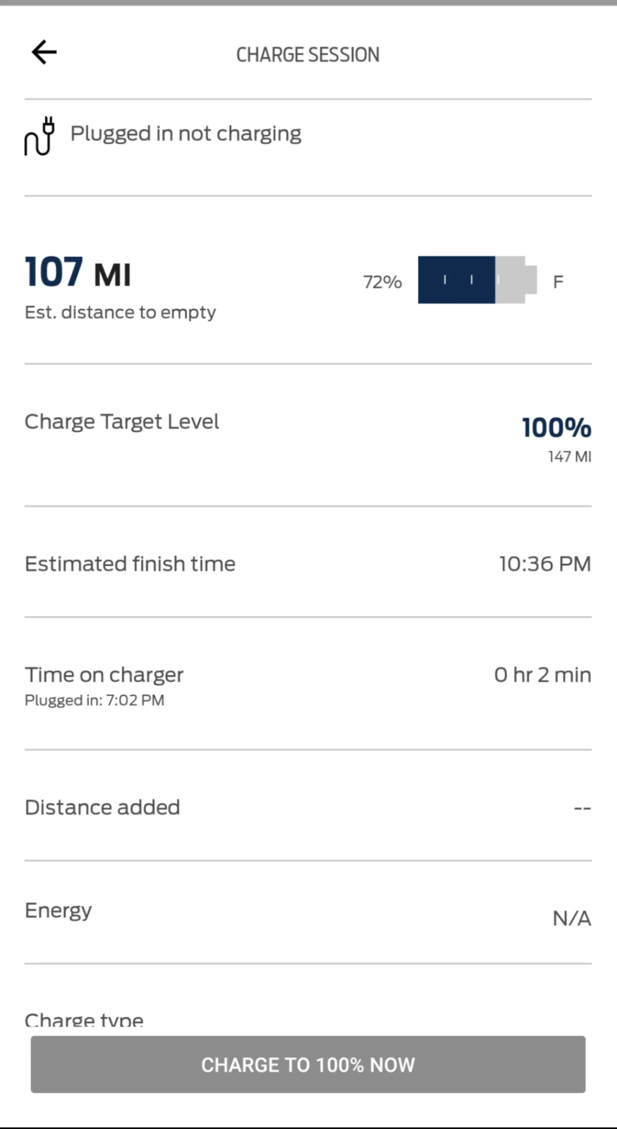

Good Morning,
Just figured I'd update for my particular situation. I have an FE that initially wasn't charging on 240v at all (home or work) but was fine on a standard 120v THEN stopped charging at all from the EVSE but would charge on public chargers fine. We had our car at the dealer for the last week, it was determined it was the EVSE and they gave us a replacement. It works on 120v fine both home/work, but it won't charge at 240v at our home but will charge on 240v at my work. Ford pass seems to be functioning fine and the car seems fine so chances are something is up at home. I will update if I ever figure out the issue.
