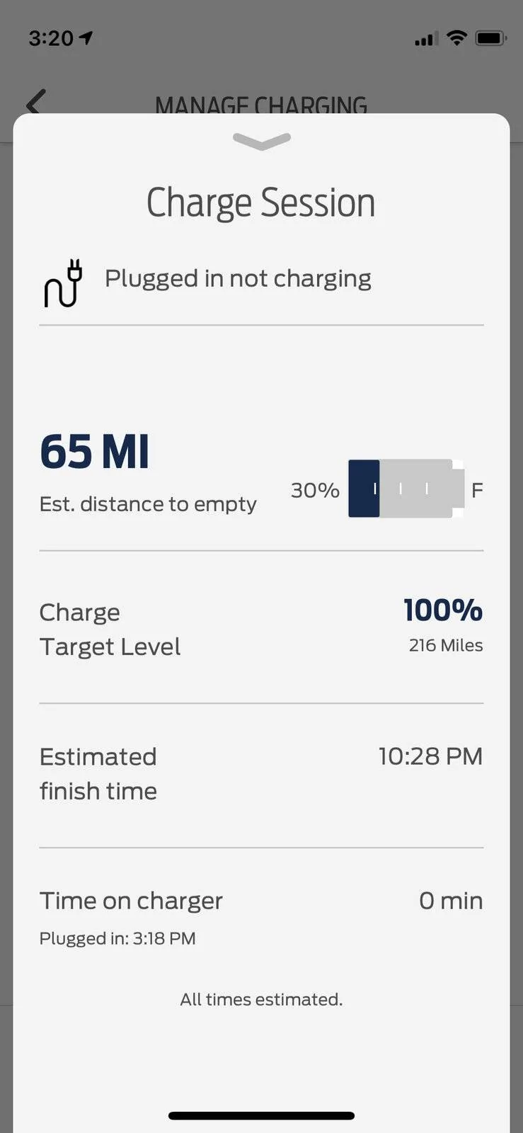

It is my belief that there may be multiple issues that are causing the same symptom of not being able to charge from home. To date, it seems like for me the Ford engineer is focusing in on why there is a lower voltage rate coming from the 12-pin on the EVSE that is not waking up the BCM but the same low voltage rate on the 12-pin connector with 120V is not an issue. I am going to be following up today with Ford to see where they are at. I am also under the belief that some of us are having charging conflicts related to software corruption (of the departure schedule). However, a few members have had their cars module firmware reset by the dealer and that did not fix the issue.

I heard back from Ford. They are replacing my Battery Control Module. It’s a two-three week lead time for them to get the part. I am not 100% convinced they know the exact issue but based on what the Ford engineer and Mach-E team is seeing, this is what they want to try. Guessing if this fixes the issue, there will be a path forward with people that have a similar issue. However, I think that some of us are also having a software issue relating to a corruption in departure schedule charging but that is my own suspicion and Ford does not think that is my issue.

I am getting between 244-248V and 60 hz frequency. It’s not the power. Based on what they saw on my set up is that the 12 volt trigger pin on the EVSE is a lower voltage then they expected. This is what communicates to the BCM to tell the car to accept the charge. The 12 volt trigger pin also measured low on the 120V charge but the BCM was accepting the charge. This is why they want to replace the BCM. This also correlates to your theory of why quickly switching between the 120V and then 240V is producing strange results. The BCM seems to be less sensitive when getting the 120V.
