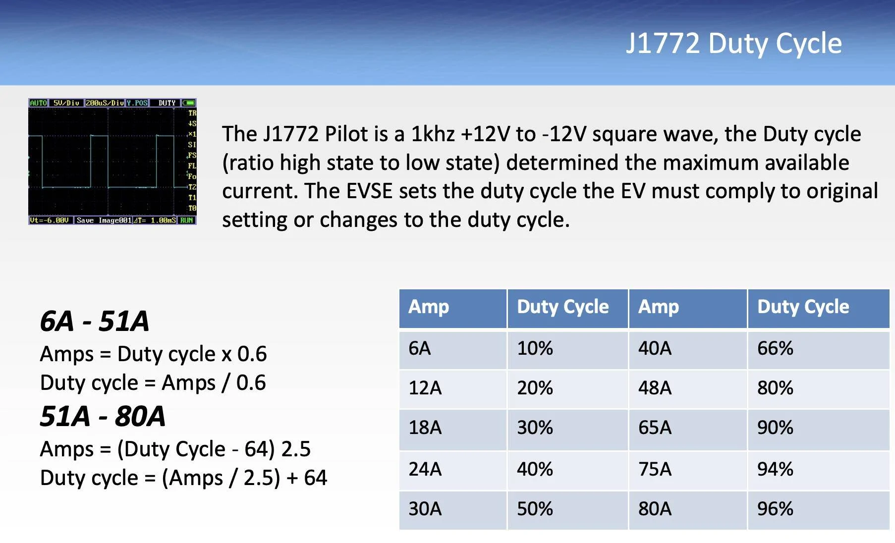

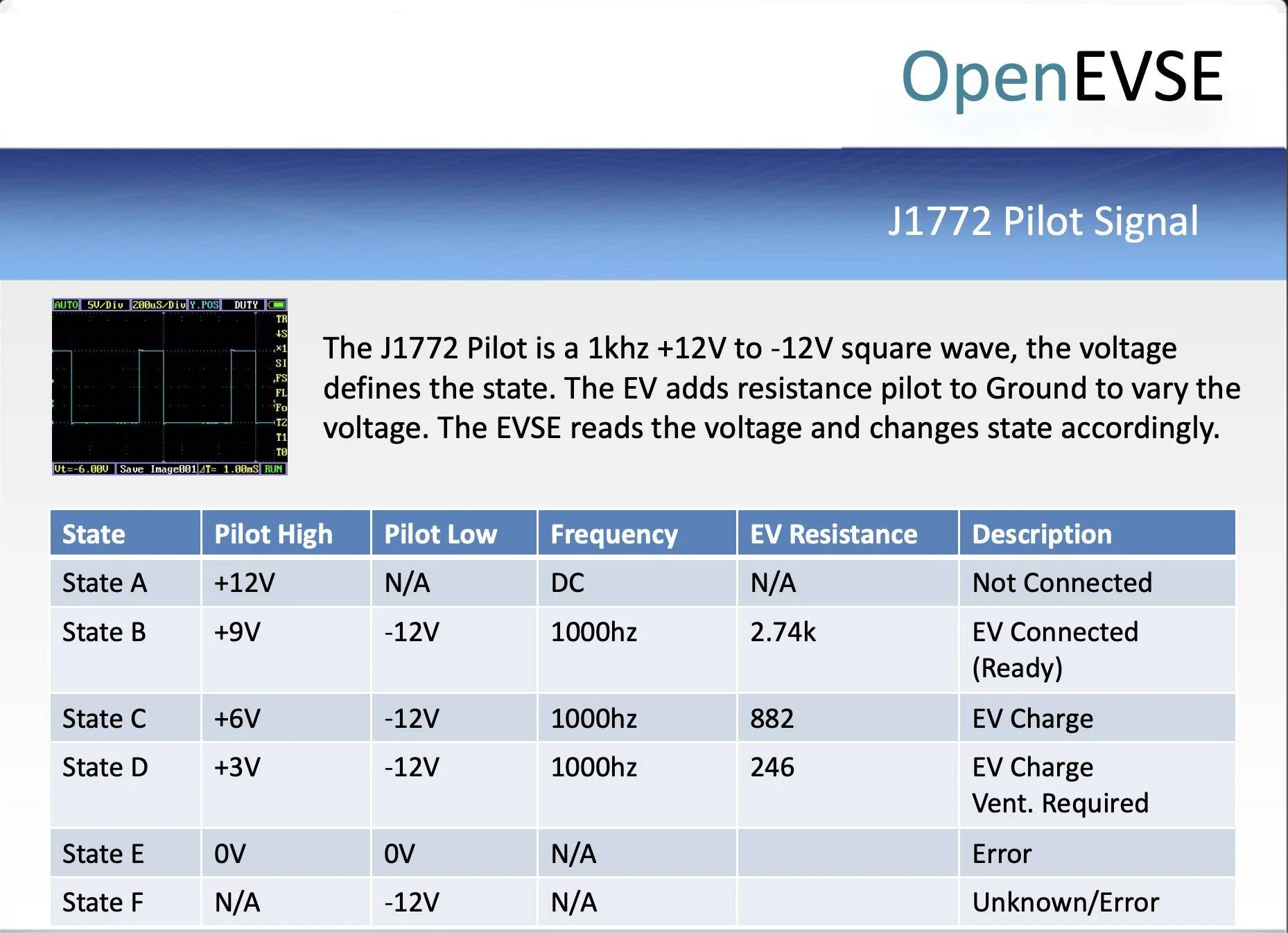

It's a little more involved than that ...
Been a while since I looked at the J1772 signals. I was just googling to find a chart for the post that asked about the duty cycle for 40A, and then I saw this slide about the various peak waveform voltages showing "state". I do not remember where someone mentioned a low voltage, but here it looks like there are several normal "pilot high" voltages below 12V. "The EV adds resistance (pilot to ground) to -cause- the voltage to vary, and the EVSE reacts to the voltage as measured by the EVSE, and then changes state accordingly ... The answer may be here; in some of these fail to charge scenarios, MME might not be making the correct changes in load resistance.
