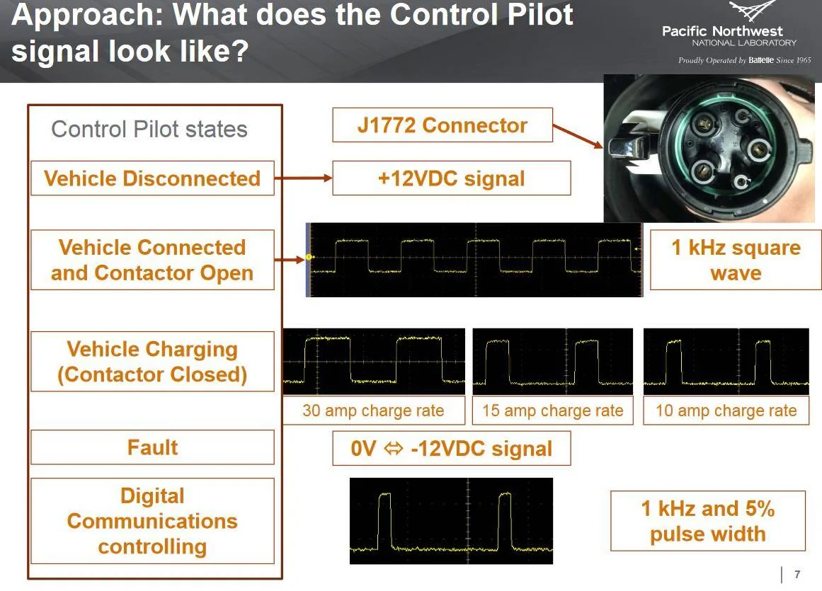

Yeah - it's not simply a 12VDC signal (graphic below). The problem must be how the car intreprets the 1kHz square wave. I could see perhaps if the generator was running (even not powering anything) may interfere with the signal (long shot).
It’s just strange. I would think they could fix this with software versus replacing the BCM. But what you just showed is exactly what the Ford engineer and Mach-E team was seeing but they couldn’t explain why the same measurement on the 120V, the BCM was allowing the MME to charge. To my limited electrical engineering knowledge a software update to the module could change/reduce the expected value threshold to allow the charge.
