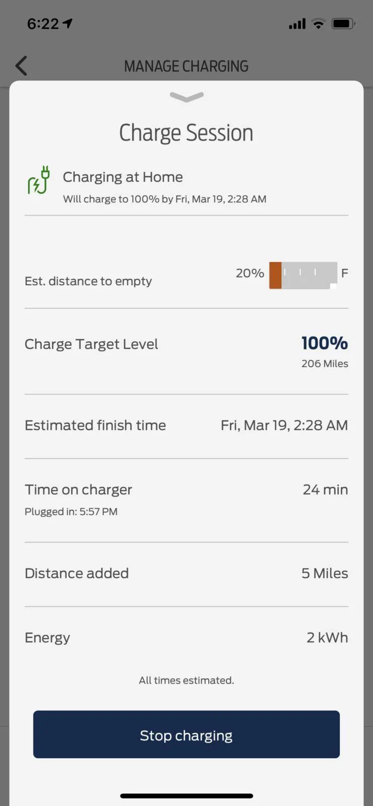

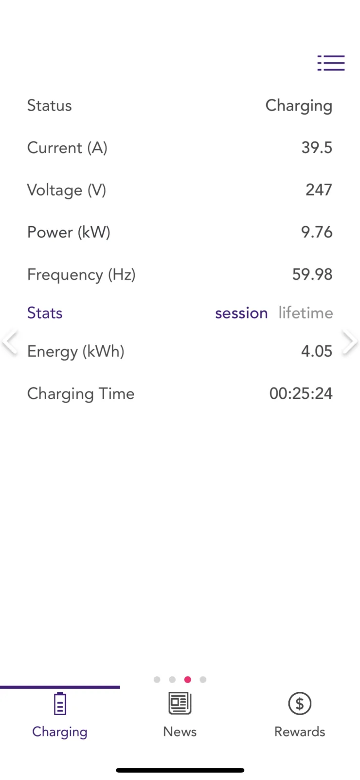

So after a long car ride yesterday I got home with 12% battery. I figured I would give the 240V a try and it worked!! I’ll post screenshots of what my JuiceBox showed but after about three hours I had to go pick up my daughter and the car was at about 25% charge. After picking her up, I came back home and it started charging again on the 240V. I am leaving town so I also was able to change the max charge to 60% and it uploaded the setting to the car just fine. However I did notice a message in Ford Pass (not the car) that I was charging outside of my preferred hours. What is weird is that I never set up charging or departure times.
I emailed the Ford Mach-E team last night to tell them that my car is now charging. They still have the token installed on my car, so they should be able to see the data and determine why it was now charging. They emailed me back and said they would forward my email to the battery and charging team.
Hopefully this provides them more data to compare. I am still waiting the new BCM that was ordered and they think they can install it 4/2. I still think this may be a combination of software and hardware issues.

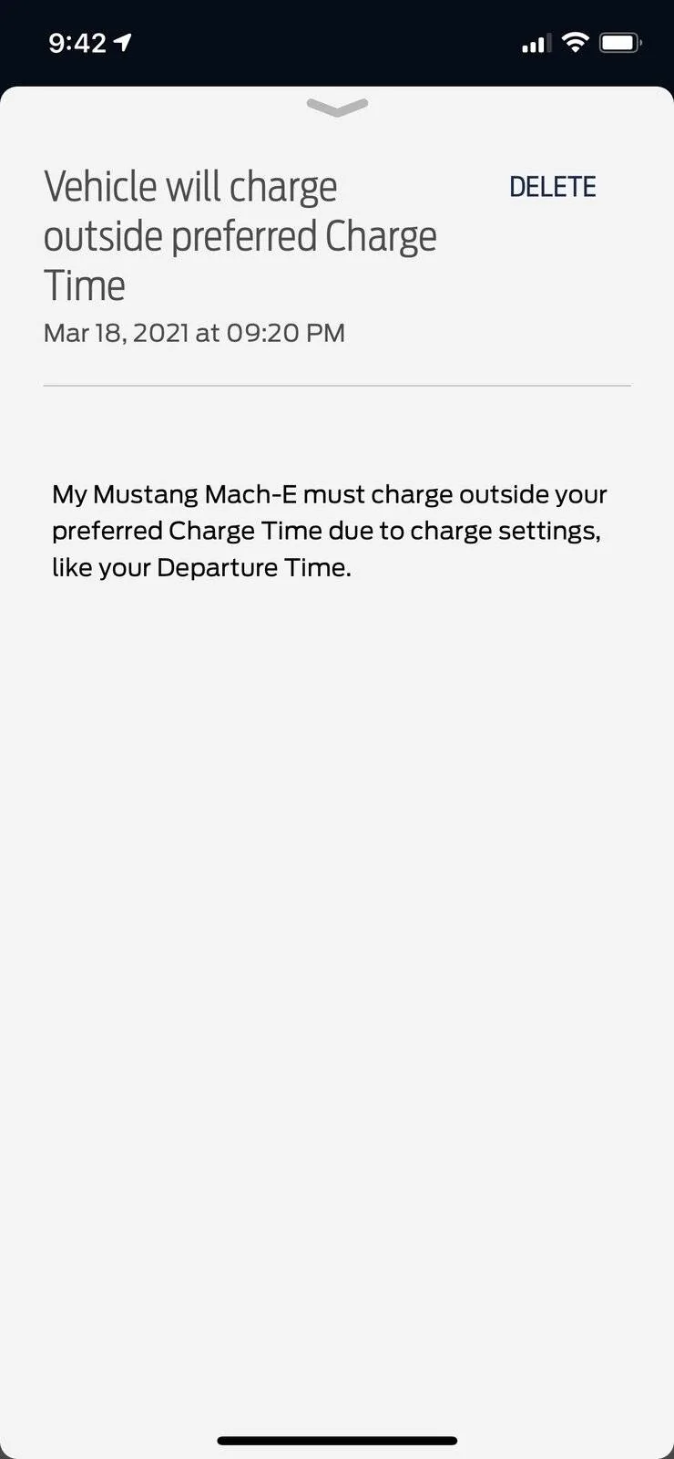

I am now starting to get the "Vehicle will charge outside Preferred Charge Time" message while driving. Message displayed yesterday from FordPass app and today on my SYNC screen.
Both times.....while driving. :rolleyes:
Wow, how long is your cord? ?
I should be able to try and charge on Sunday night with a low charge as I haven't had that scenario at home. Thank you for tracking down and running point with the engineering team. Please don't let them off the hook until they've got a resolution, I'd hate for them to punt if yours is starting to charge.
The vehicle learns your habits. As your habit is to continually driving your new MME it must now know you well enough to determine that charging at any time will be out of your preferred times. ;)
