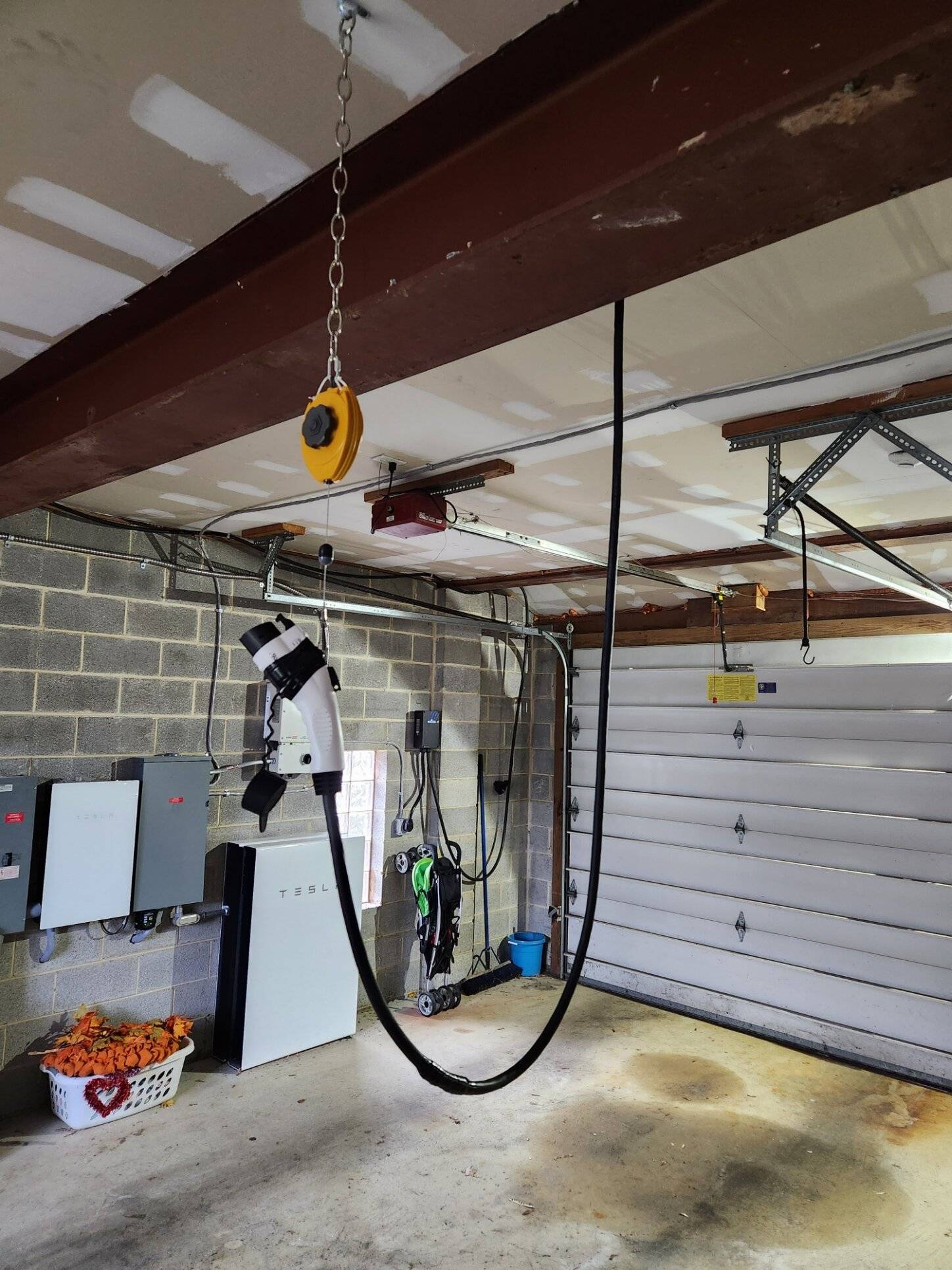

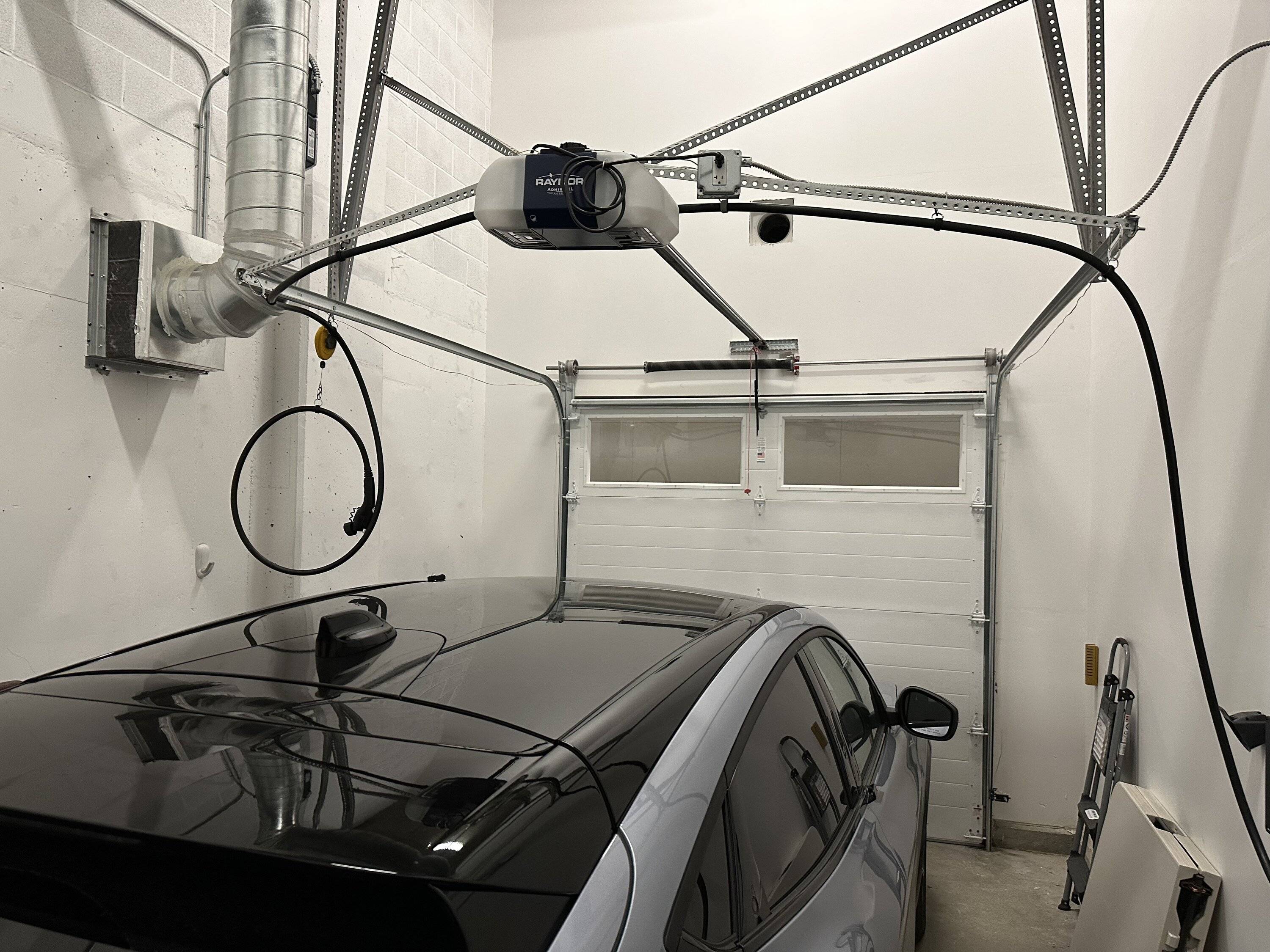

Grizzl-e off in the distance with the cable running along the ceiling...

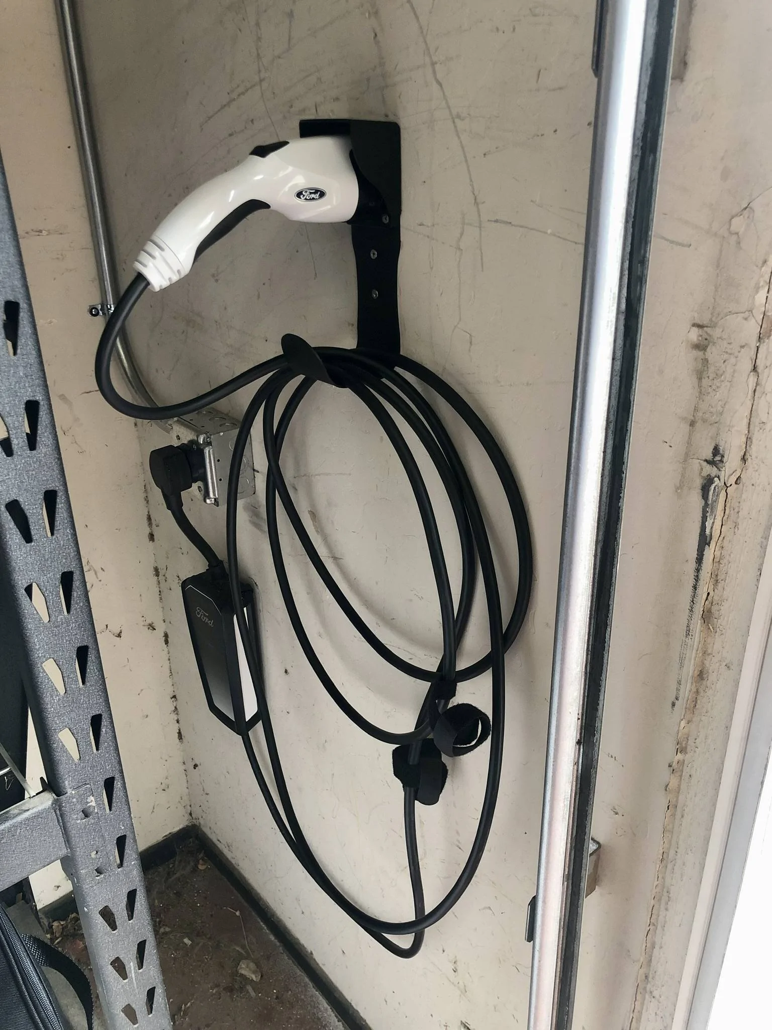

Mine is boring!

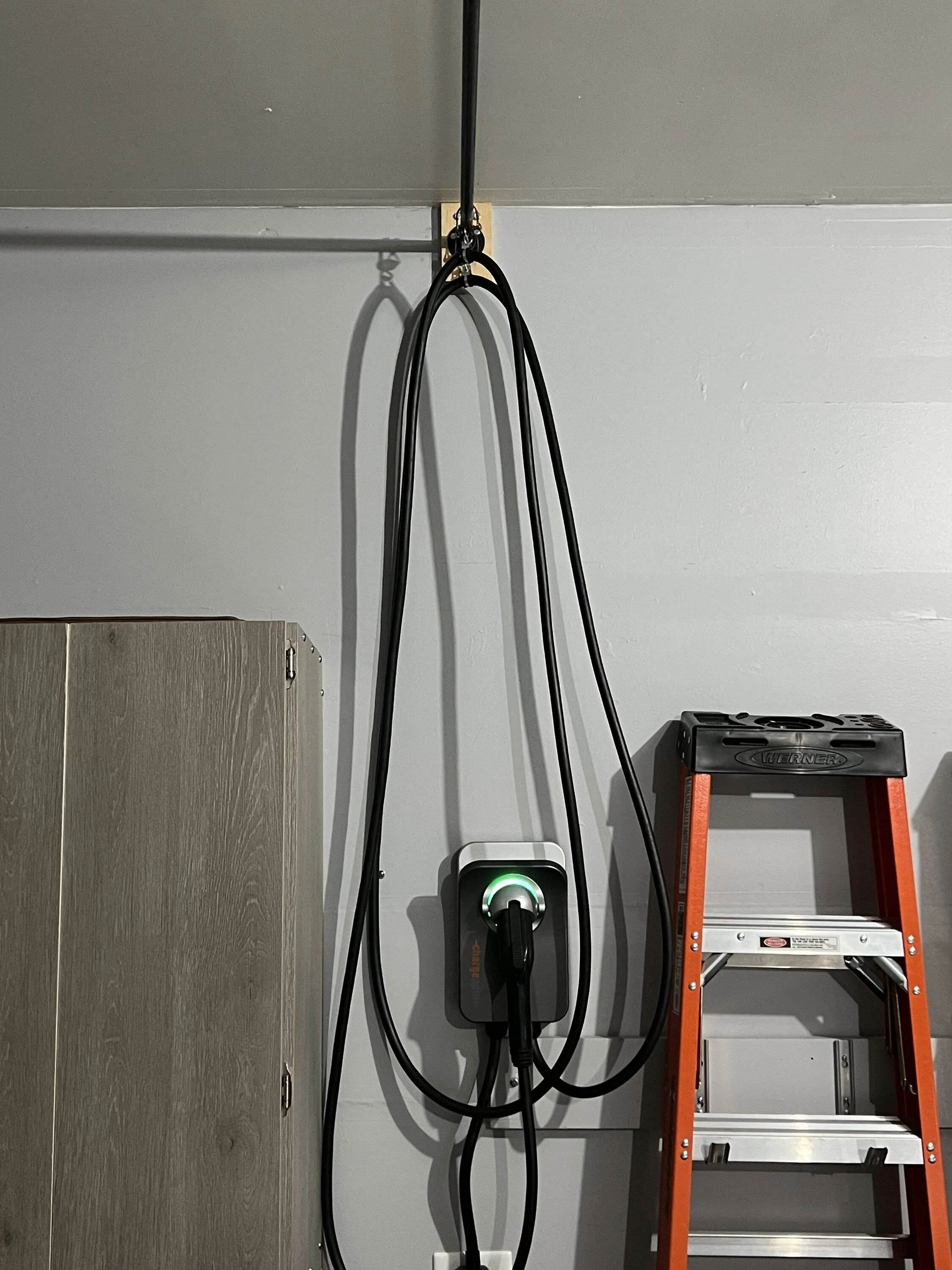

Clipper Creek. It has a lip and we loop (larger loops than shown by most in this post) the cord around it. It came with a plug holder which we plug into when not charging.
We have a movable cabinet protecting the cord and EVSE.
Ford Mustang Mach-E How Do You Roll (your charging cable)? 20210506_172005
3 car garage. Two spaces (stack: front to rear) to right of EVSE, one space to left. EVSE can reach three EVs, as long as one is the size of a Bolt.

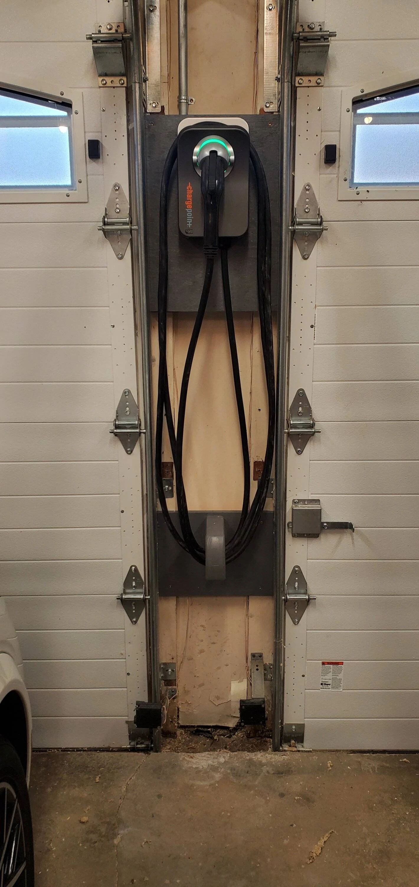

A little bit of a pain dragging the cable around the front of the car. But it gives me the ability to charge in the driveway or garage. Plus I only charge once a week for the most part.

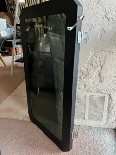

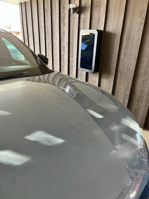

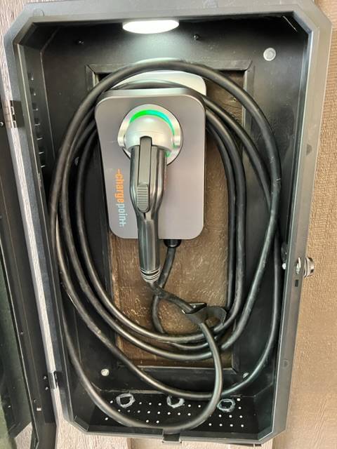

I mounted my charger in my carport, and looked for a slim cabinet to protect it. I ended up getting a cabinet for a Tesla charger and modifying it. The charger was between two fascia boards and I wanted the cabinet to stick out minimally from the wall. Also, my holstered ChargePoint charger sticks out a bit. So I decided to remove most of the back and install it over the top.
Ford Mustang Mach-E How Do You Roll (your charging cable)? IMG_0632
Removed the door and temperature gauge.
Ford Mustang Mach-E How Do You Roll (your charging cable)? IMG_0636

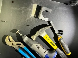

Removed the internal brackets with an oscillating saw, etc
Ford Mustang Mach-E How Do You Roll (your charging cable)? IMG_0637
Ford Mustang Mach-E How Do You Roll (your charging cable)? IMG_0635

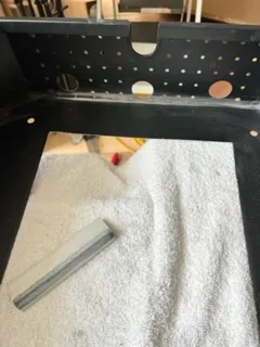

I measured my opening on the back and used a utility knife for a few hours to score it as heavily as possible.
Ford Mustang Mach-E How Do You Roll (your charging cable)? IMG_0640
Drilled a hole near one side and used the oscillating saw to remove material. I created tabs of metal which I could then break at the score lines.
Ford Mustang Mach-E How Do You Roll (your charging cable)? IMG_0643

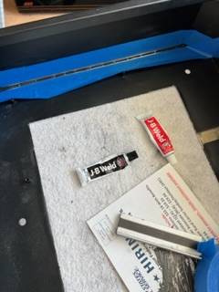

I removed the remaining metal, bending the tabs back and forth at the score lines. Unfortunately, the back bottom and top edge were merely edge spot welded and shook loose. So I epoxied those and painted.
Ford Mustang Mach-E How Do You Roll (your charging cable)? IMG_0645
Ford Mustang Mach-E How Do You Roll (your charging cable)? IMG_0647

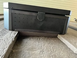

I put rubber edging over the newly cut metal and mounted it with some wood inserts and bolts. The bottom slugs also loosened so I siliconed those. I added a velcro cinch to fully retract the holster, otherwise the handle trigger gets pushed in by the door (it's that tight).
Ford Mustang Mach-E How Do You Roll (your charging cable)? IMG_0654
We have wasps, so I put some screen and a plug at the bottom. I also added small filler boards between the fascia boards top and bottom.
Ford Mustang Mach-E How Do You Roll (your charging cable)? IMG_0658
Ford Mustang Mach-E How Do You Roll (your charging cable)? IMG_0656
Ford Mustang Mach-E How Do You Roll (your charging cable)? IMG_0649

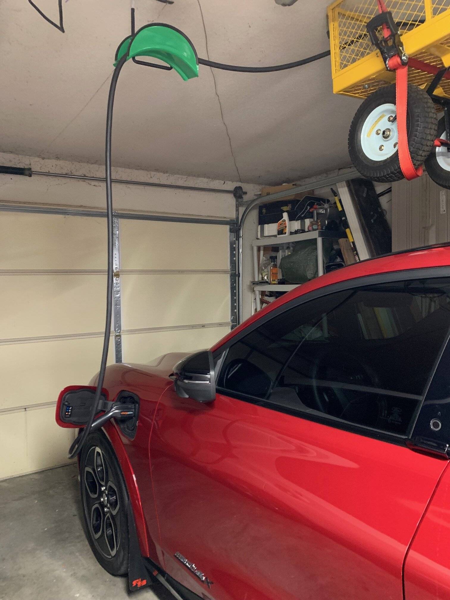

Over & Down
From the west wall over the top and down the center since I back into my side. I use a ChargePointe (direct wire 60 amp) so I can have the Ford Charger in the boot with my Modern Spare when on road trips.
