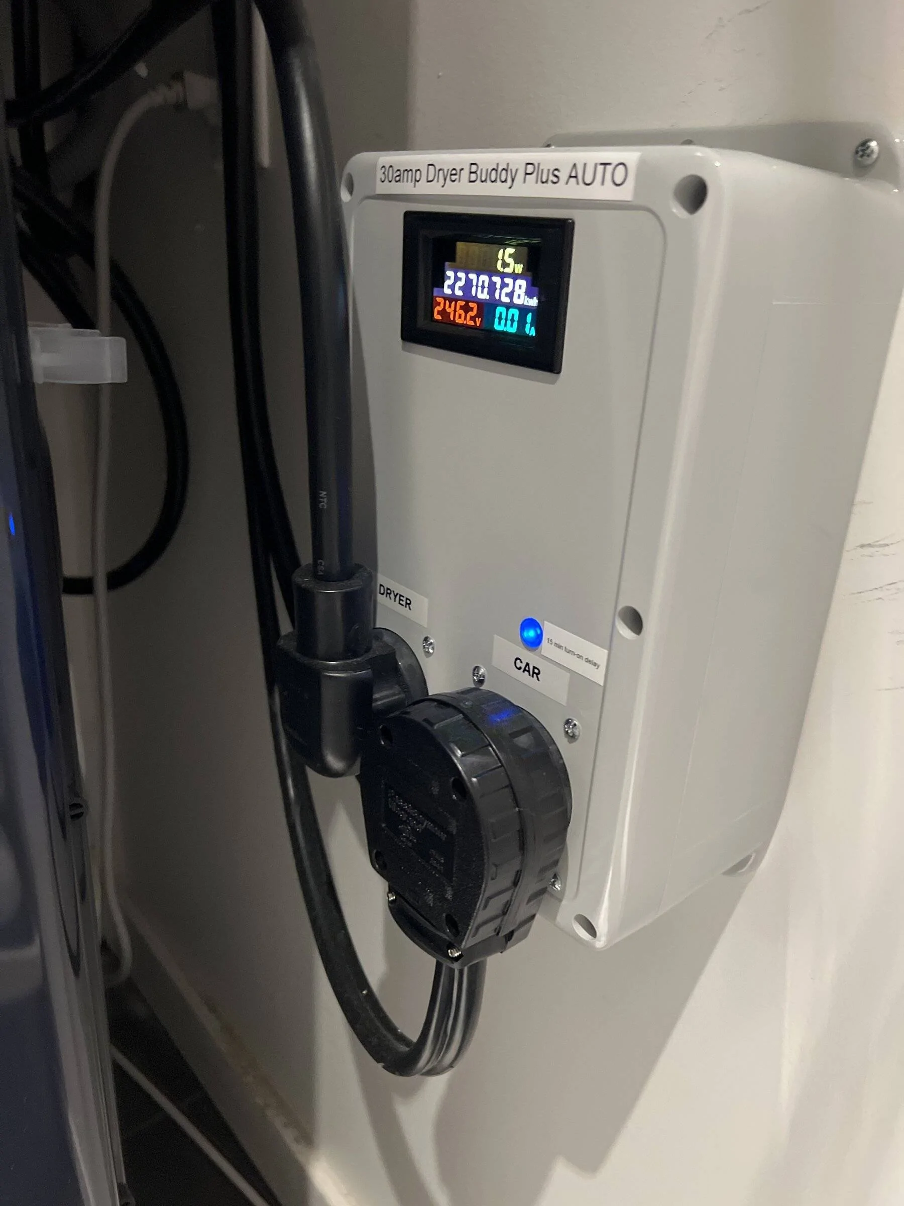

Check out Dryer Buddy https://www.bsaelectronics.com/collections/dryer-buddy-plus-auto.
The guy who makes these is really a great guy and it supports his family. He makes auto switching devices. This way you don't have to "manually" switch between the two. Set your charger to charge at midnight (doubtful you do laundry then) and you never have to worry about switching. Laundry during the day, charging at night. Also, you can install it yourself, no electrician needed. He'll make them exactly to your specification. Just explain the situation and he'll make a device that will work.
I am in no way affiliated with BSA. I was an owner of a Dryer Buddy when I first got an EV in 2018 and before I put in a dedicated circuit. My recommendation is from personal experience.
Best of luck!

There is a wall unit that you can plug into your dryer plug, and you plug your dryer and your charger into it, and will only run one at a time. if you want I can send you the link, it's 300 dollars though. but it's got some cool features, like tells what it's pushing to the car or, charger off, drying.
It’s called a Dryer Buddy. I’ve been using one for over a year along with a ChargePoint Home Flex Charger.
Dryer Buddy gives priority of the power to the dryer. And when the dryer is not being used it automatically switches 30amps to the car charger.

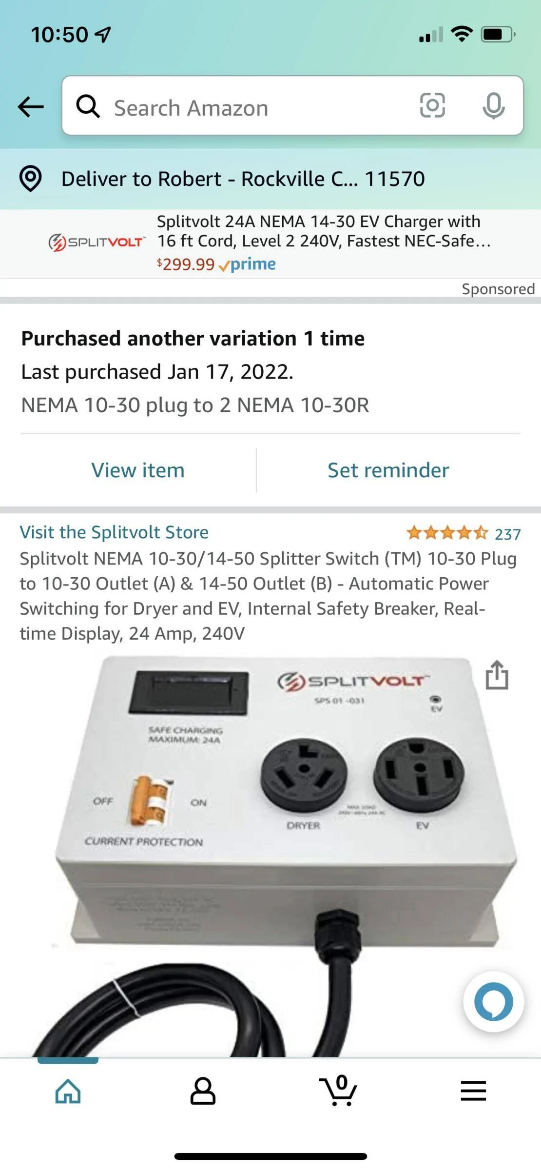

I was told today that the junction box coming to our house is only 100amps (not the breaker box on the house). I wanted to add a 40a so that I could charge my car coming later this summer, but the latest electrician said its not possible with what we currently have. I'm at a loss at what I can do and still be in code (regulations from the park). The guy today said he could install a separate box for the dryer outlet and the new outlet I want to add and just have a manual switch between the 2. This would mean everytime I want to charge my car or run the dryer I'd have to switch the box to which I want to use.
I'm hoping to find a solution before my car comes in July.
I had a 30 amp line in garage for a heater. I installed Split Volt splitter. Search it on Amazon. I just plugged my heater into the split volt then plugged my 24 amp charger into it. When the garage needs heat splitter powers the heater. When the heater turns off it switches to powers the car. I commute 100 miles a day and 24 amp charger is more the sufficient. Most people won’t need a 40 or 50 amp charger. You don’t wait for your car to go to zero before you charge. I typically will plug it when I have 40-50% left.
