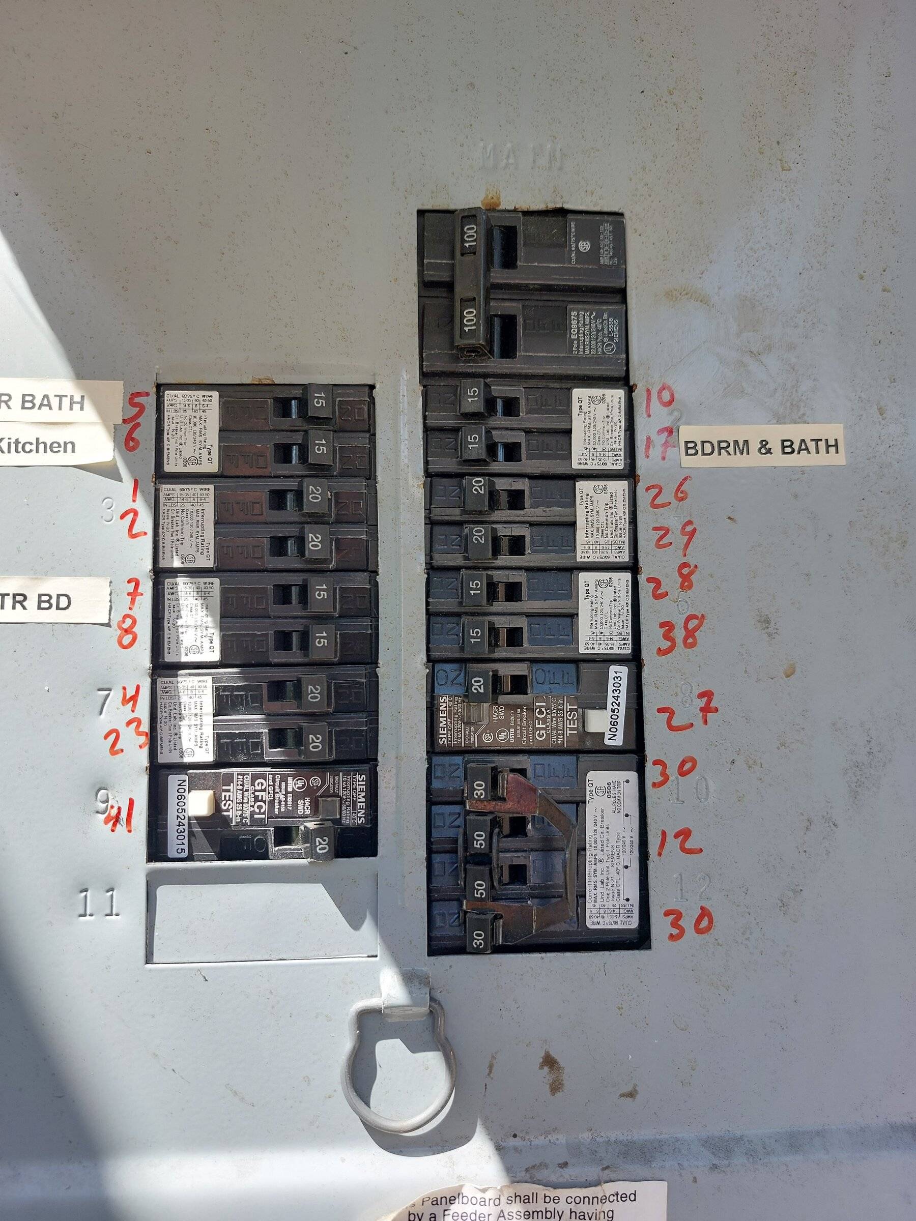

We live in a mobile home park and the power provided to the house is what they call a pedestal. The pedestal is only 100A so we wouldn't even be able to upgrade our panel to 200A. We don't have AC, and actually our stove and oven are gas. I looked at our panel at there is actually a breaker for an AC unit, so maybe there is hope.
What about a gas dryer. I believe you said you have an electric dryer.
11,366
25,029
In the picture I realized that #12 is to the nonexistant AC unit (30 is the dryer).
Yes this is a mobile home park with a 100A pedestal. The park does not have a way to upgrade to provide more power to the house. Can we tap into the AC breaker for the 40A outlet?
Yes, you can use the unused 50A breaker and install a NEMA 14-50 receptacle with 6 gauge wire. Your service can just barely support charging at 40A/9.6kW, that is the max. This is assuming the dryer is the only 240V load.

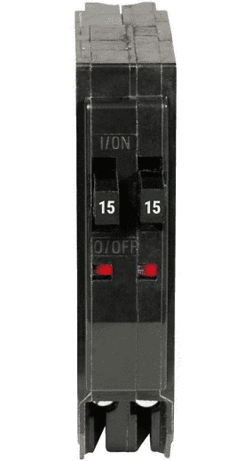

Even if the panel is full, if they are modern breakers, chances are some can be doubled up with a modern dual breaker or two. Something like 4 of these:
This will enable a 40A larger double breaker to fit.

Yeah I was hoping to see a panel full of non tandem breakers. Unfortunately that doesn't seem to be the case.
I see a free slot available. Move the GFCI breaker from slot 9 to slot 7, replace the breaker/circuit that was in slot 7 with a tandem 2-slot 20A/50A setup: 2 individual 20A breakers coupled with a dual-pole 50A breaker. Still have the unused 50A breaker in slot 12.
