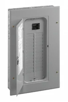

Is it an option to just replace the panel with a new panel that has more breaker openings?
Still keeping it 100A, just more available breakers. Like this:
