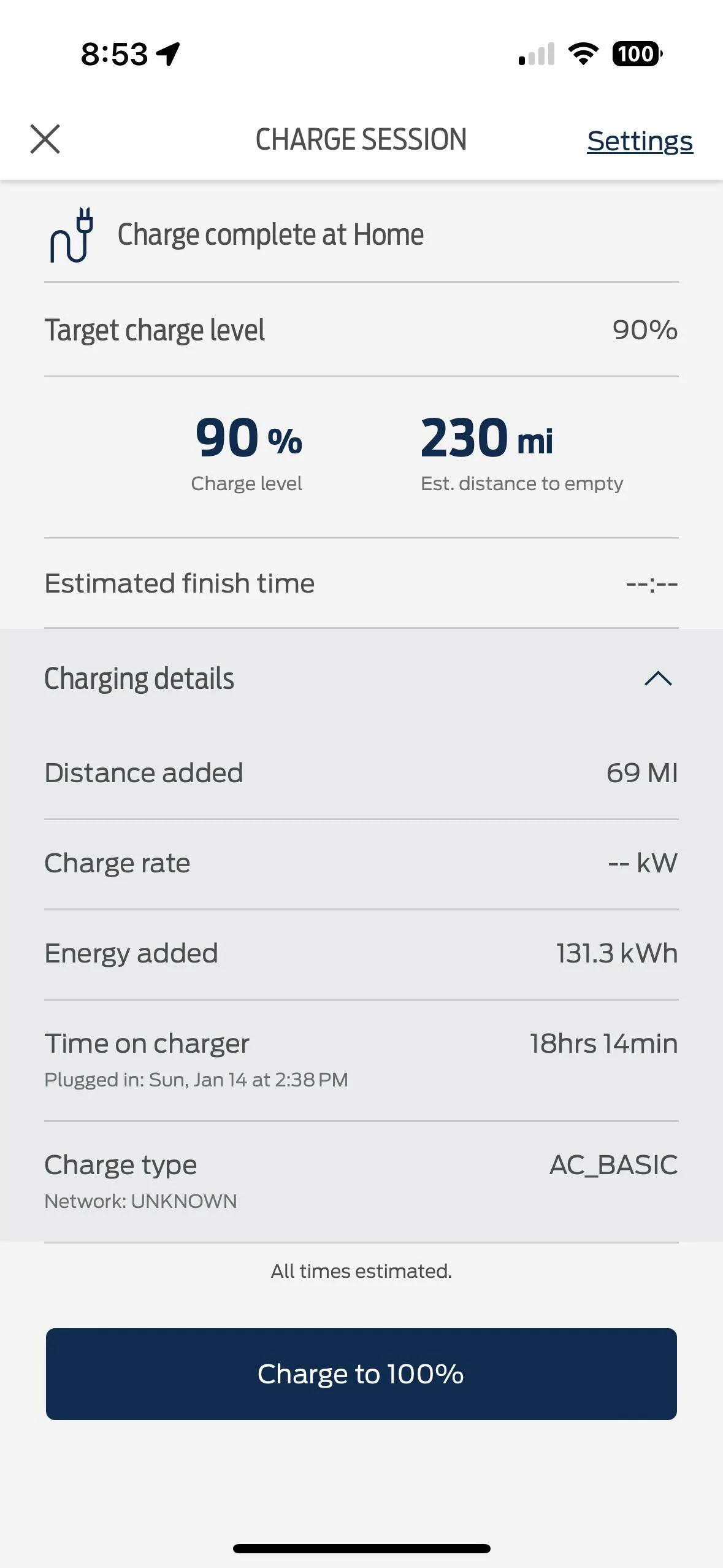

I have same problem. Left mine plugged in last night. Charged to 90% well before 10pm. 198KWh used this morning according to FordPass.

So, Reddit has some folks seeing what I’ve seen related to this post. I had a power bill that was well more than double I had ever seen a couple of months last year, and I finally saw this when I woke up. According to Reddit, some non-ford chargers (Grizzl-E is what I and one other victim used) were seeing massive energy draws with little to no charging. The fans/pumps stay on even though no charging is happening. I am in cold Colorado, but I also do not believe that the above power draw could be possible for cabin preconditioning over that period of time. That is over 10x my home usage just going to this charger for the time period.
I didn’t see a fix on Reddit, does anyone have an answer from Ford?

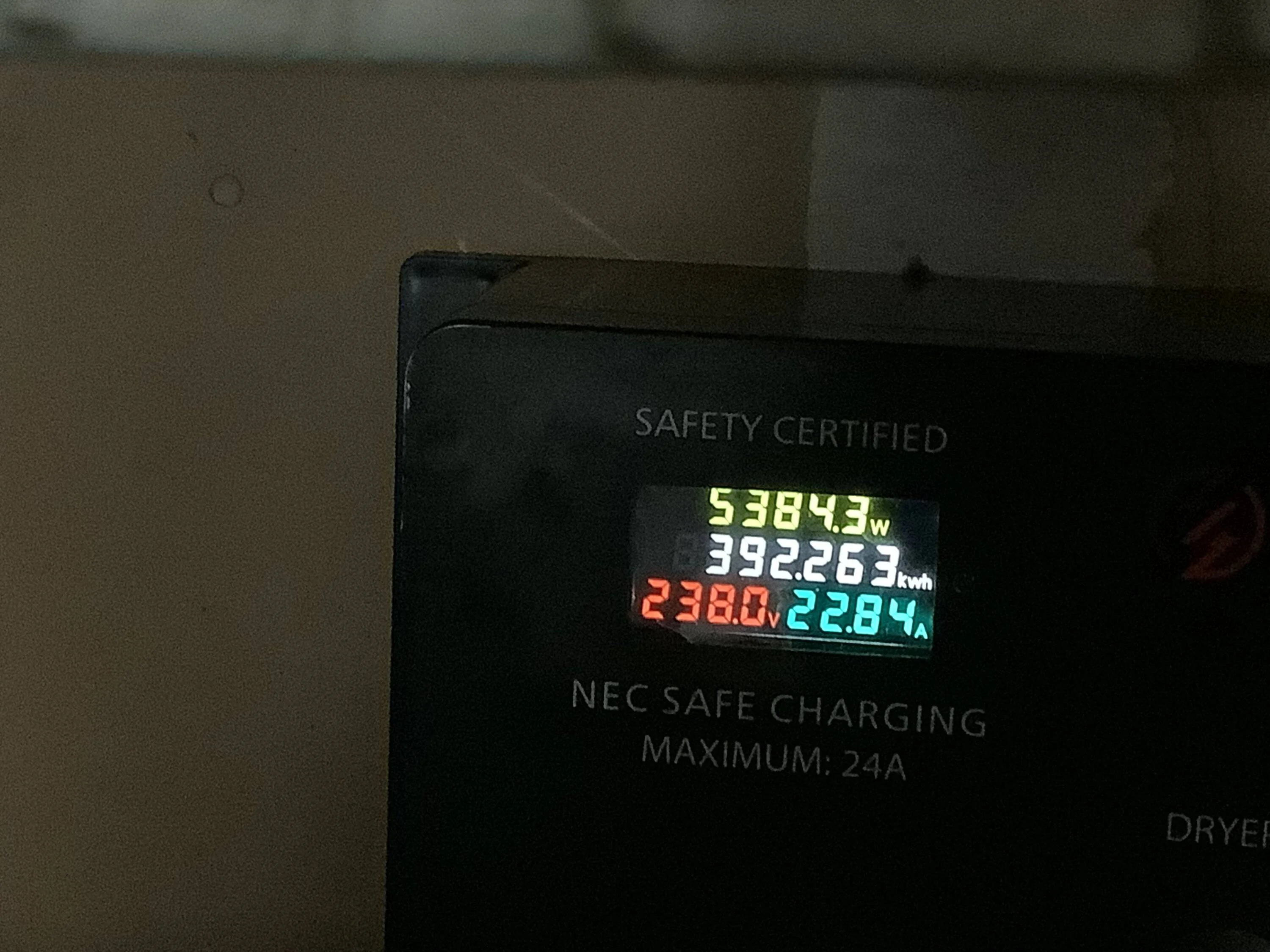

Since it has been below 32 degrees I have left mine plugged in and when it gives the Preconditioning for Drive on Ford pass it is drawing about the same current it does when charging from my SplitVolt splitter. I doubt that mine comes on as often as it would if below 0 since we only got down into the teens overnight. When it is plugged in and idle it draws around .6 amps so there must be some things that are on if it is plugged in that might not be left on if it was not plugged in. So even at above freezing it will still draw some current when plugged in but that would be minor compared to when it is actually charging. I added a photo of the SplitVolt display when it was in preparing for drive mode.

Okay, I am 99% sure the car is not actually taking energy and it is FordPass assuming a constant 7.2 kw/hr draw because the Grizzl-E is steady green when plugged in during the time the app is saying it’s still taking energy. Maybe my previous high power bill was unrelated.
