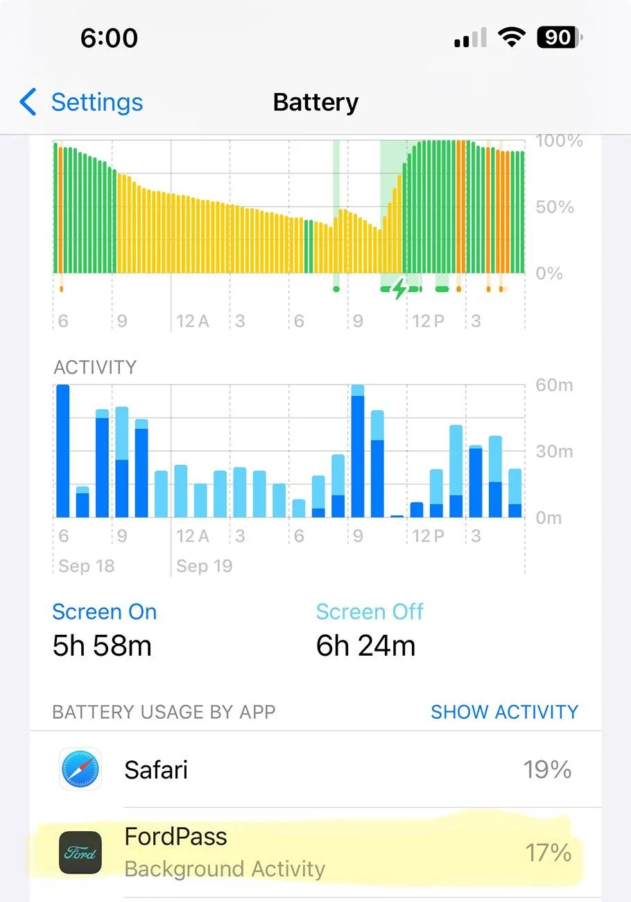

I hadn't noticed, but yes, me too (iPhone 15 pro, iOS 18). Ford Pass is #1 for past 24 hours and last 10 days.
Ford Mustang Mach-E iOS18 FordPass Battery Drain 1727822792577-k

FordPass 5.6.0 and iOS 18.01 has solved both force closing and battery drain for me. 18.01 on its own didn't help that much, so I'm guessing it was mostly something in the FordPass update. I left the fob at home today for the first time since installing 18. FordPass battery usage is 3% even with PaaK.
