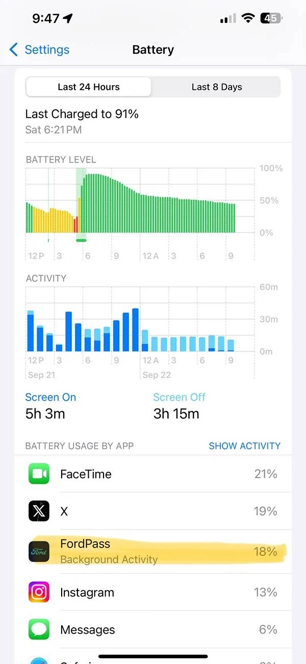

Alright, between managing my child and a pregnant wife I finally remembered to track this properly. Some quick stats:
iPhone13 Pro Max
Battery replaced 1yr ago at Apple Store, 95% battery health
WiFi connected and Bluetooth is on
Apps running recently used when going to bed:
FordPass
Sonos
Instagram
X
DraftKings
Phone locked at 12:06AM @ 71%
Grabbed phone off bedside table at 9:45AM @ 45%
Ford Mustang Mach-E iOS18 FordPass Battery Drain IMG_3306
FordPass used nearly as much energy as a 45 minute FaceTime over the last 24 hours.

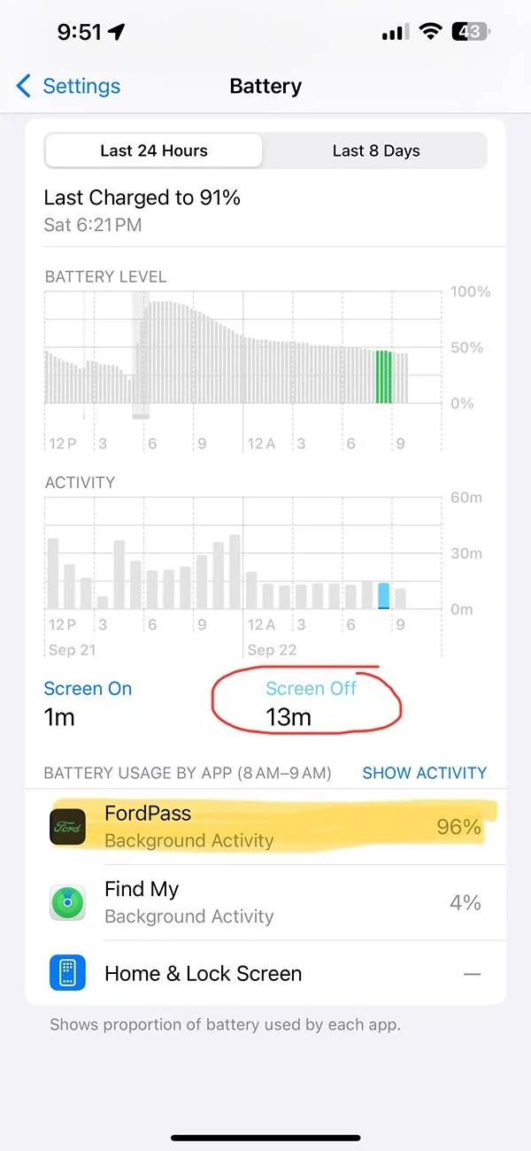

Interestingly, when tapping on the bar chart you can see specific battery usage for that hour. In the 8AM hour (phone wasn’t touched) FordPass comprised of 96% of all battery usage! It looks like FordPass is waking the device in the background every 4ish minutes (as seen in the 13min Screen Off time). Each overnight hour looks very similar.

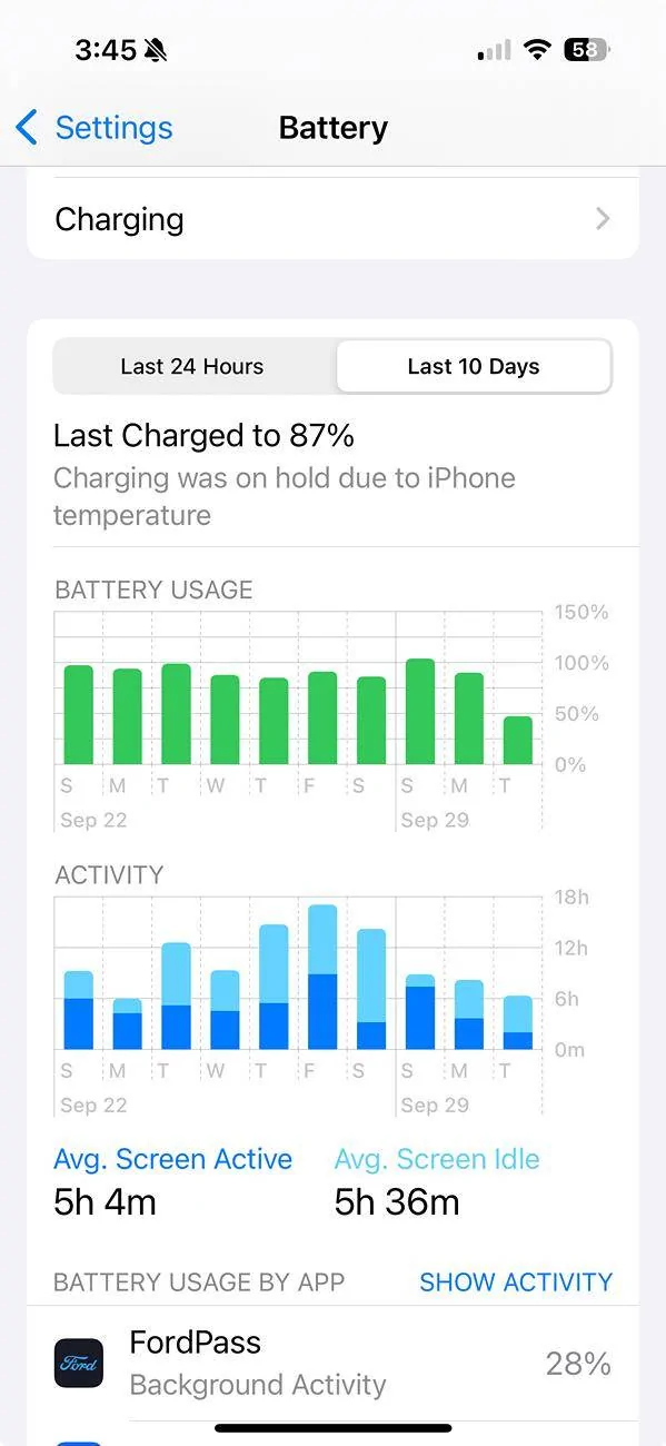

I hadn't noticed, but yes, me too (iPhone 15 pro, iOS 18). Ford Pass is #1 for past 24 hours and last 10 days.

FordPass 5.6.0 and iOS 18.01 has solved both force closing and battery drain for me. 18.01 on its own didn't help that much, so I'm guessing it was mostly something in the FordPass update. I left the fob at home today for the first time since installing 18. FordPass battery usage is 3% even with PaaK.
