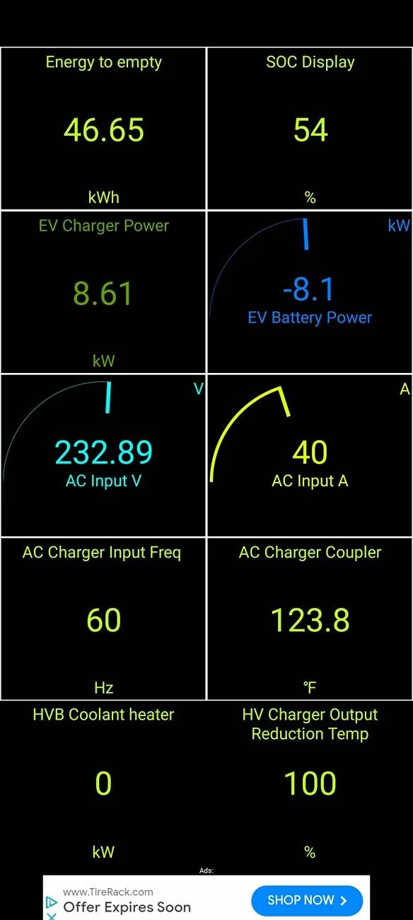

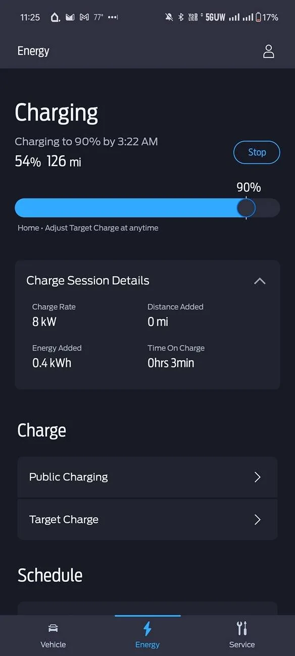

Here is an update. I installed a new 48a Emporia charger (it's currently plugged in NEMA 14-50 and set to 40A) that performs like the old 40a Juicebox Pro. I'm still happy to have decided to get a new one the cord seems more flexible and the WIFI was broken on my juice box. Tomorrow I will try to use my OBD2 scanner to show what going into the car but it appears 40a EVSE will show 8kw when charging. In my opinion, my car does not have a problem like some others have described. Based on my results the charger is unlikely to be the problem
I do want to point out that it's 11:24pm. The charger is brand new to be and it's been plugged in for all of 5 minutes. I will do more testing but I haven't gotten to it yet. My point is it appears loose connectors or not = the same result.
I suspect that both chargers are working normally and Fordpass shows 8kw with a 40a charger,

Here is an update. I installed a new 48a Emporia charger (it's currently plugged in NEMA 14-50 and set to 40A) that performs like the old 40a Juicebox Pro. I'm still happy to have decided to get a new one the cord seems more flexible and the WIFI was broken on my juice box. Tomorrow I will try to use my OBD2 scanner to show what going into the car but it appears 40a EVSE will show 8kw when charging. I think this is normal
Hope you solve your problem by throwing money at it. Your picture however does not show much. No distance added. Mine always starts at 8.X and then quickly derates. It is not that the charger can not deliver 40 amps it is the car does not want it.

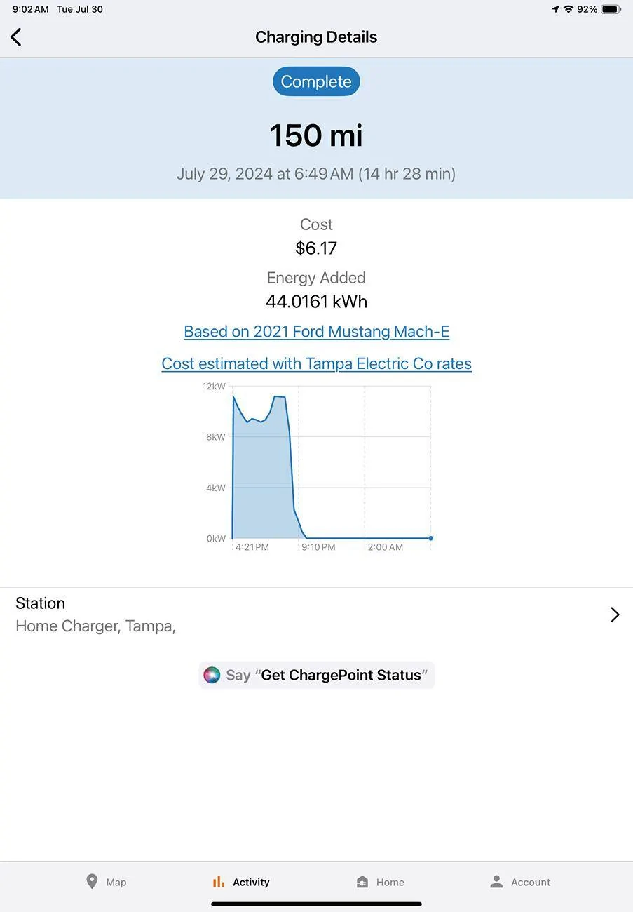

Just installed a ChargePoint Home Flex. Haven’t done a full charge yet but this was the other night. Charger is hard-wired on a 60 amp breaker with charge set to maximum of 48 amps. The session started out at what seemed like the correct maximum of 11.5 kw. Stayed there for maybe 20 minutes then started to bounce up and down from about 8.5 to 10ish. Then later on it rebounded to 11 for most of the last portion of the charge until it dropped off at the last, finishing 1%.

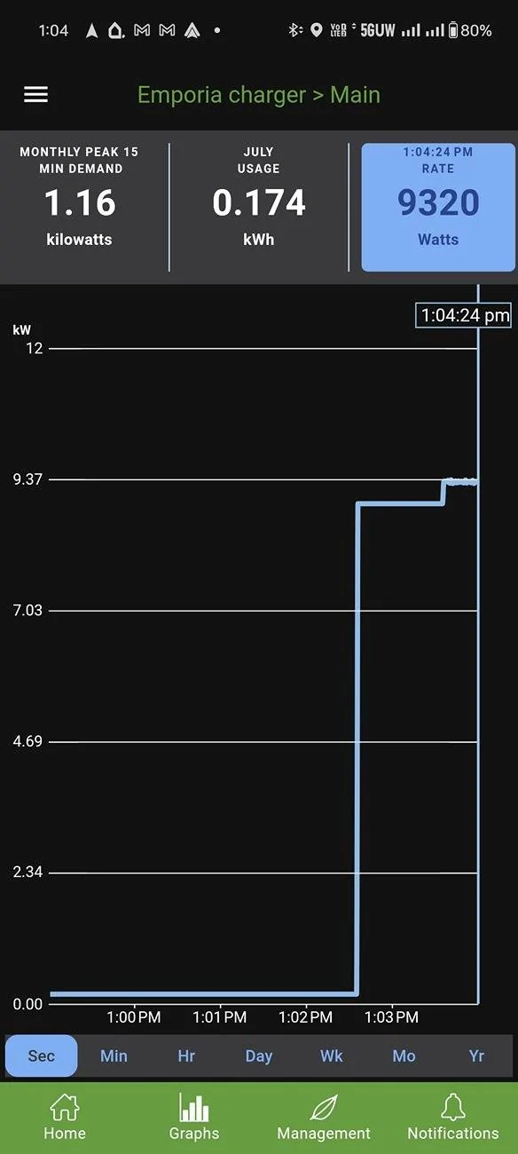

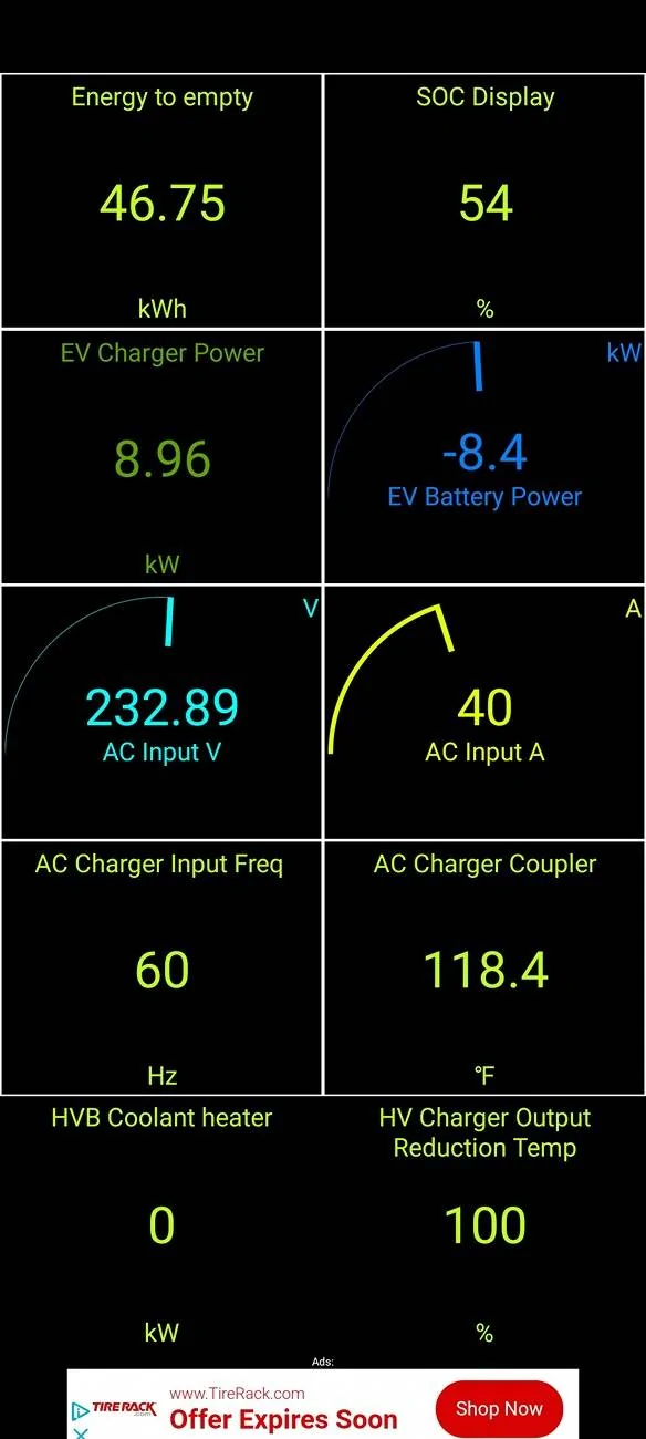

Here are the update from my OBD2 and Emporia app. There's a small difference in speed due to the loose cable but not a huge difference in my case. YMMV on this I don't think my cable was very bad.
From the Emporia app
Ford Mustang Mach-E L2 charging speed recently dropped 33% Screenshot_2024-07-30-13-04-26-64_55c0070d8632d0f0143043b6e1e8cb96
This is the new Emporia EVSE

This is the old Juicebox EVSE
Ford Mustang Mach-E L2 charging speed recently dropped 33% Screenshot_2024-07-30-12-59-33-52_3d9111e2d3171bf4882369f490c087b4

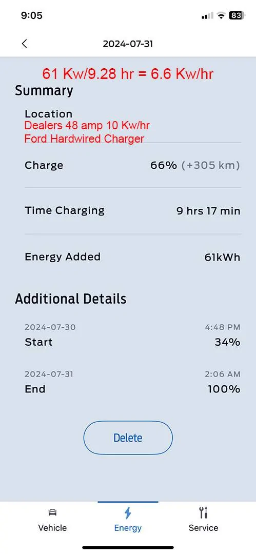

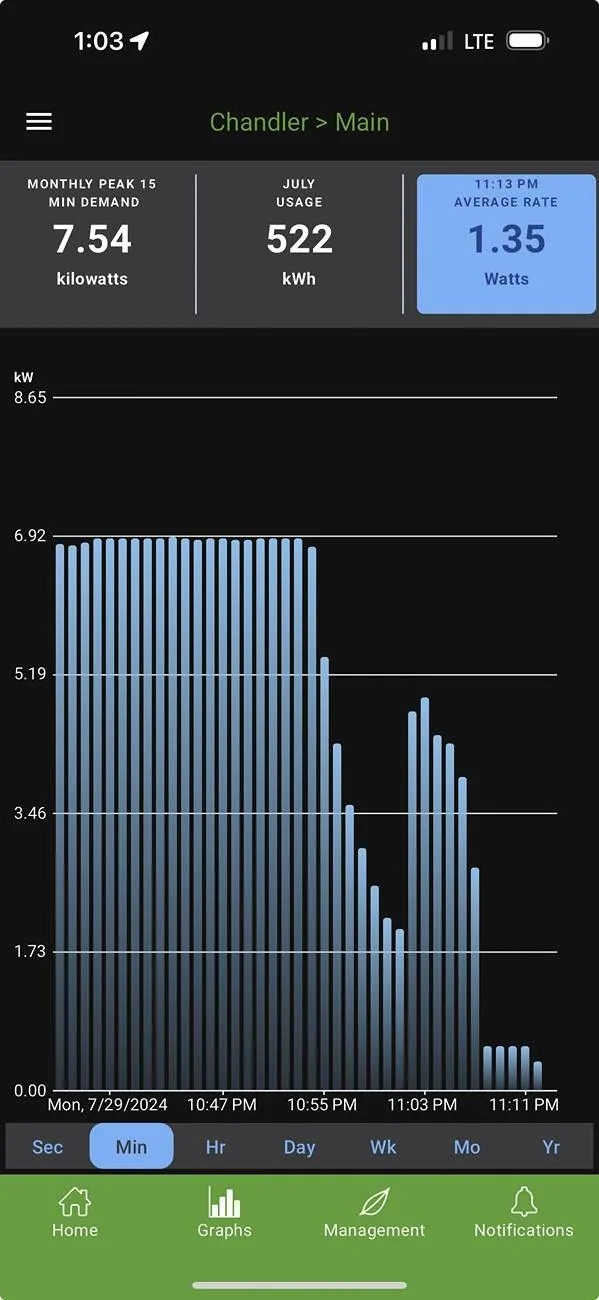

Well we have a step in the right direction. My service guys FINALLY plugged it into their 48 amp Ford hardwired L2 charger. Started at 8.3 KW and within a minutes it was charging at 6.3 KW (not even 32 amps). Not close to 10 KW at 48 amp like my sales agreement states. Software is on hold and no fix or acknowledgement from @Ford Motor Company to date but still a small step after 14 months. Oh guess what not the charger DUH!
azerik
Jan 8, 2023
4,545
4,558
Chandler/Flagstaff, AZ
DevSecNetOps, General PITA
Ford Mustang Mach-E L2 charging speed recently dropped 33% IMG_9BAB92375B92-1
