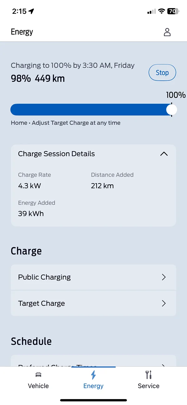

Yes it has been to the dealer and as noted a page ago it took 9.28 hours to charge it 66% there on a 10 Kw Ford hardwired charge. Here it is charging at home this morning trying to get it to 100%
Got to a 150 kw fast charger switched once but could not get it over 60 kw. When it hit 80% it drop to 40 Kw. Understandable must have been burning up at that 60
You realize the charge rate is going to decrease as you approach 100% right? You're at 98% so 4 kW seems right to me. Set your limit to 90% instead. Charging to 100% takes an extra hour or two because of the taper.

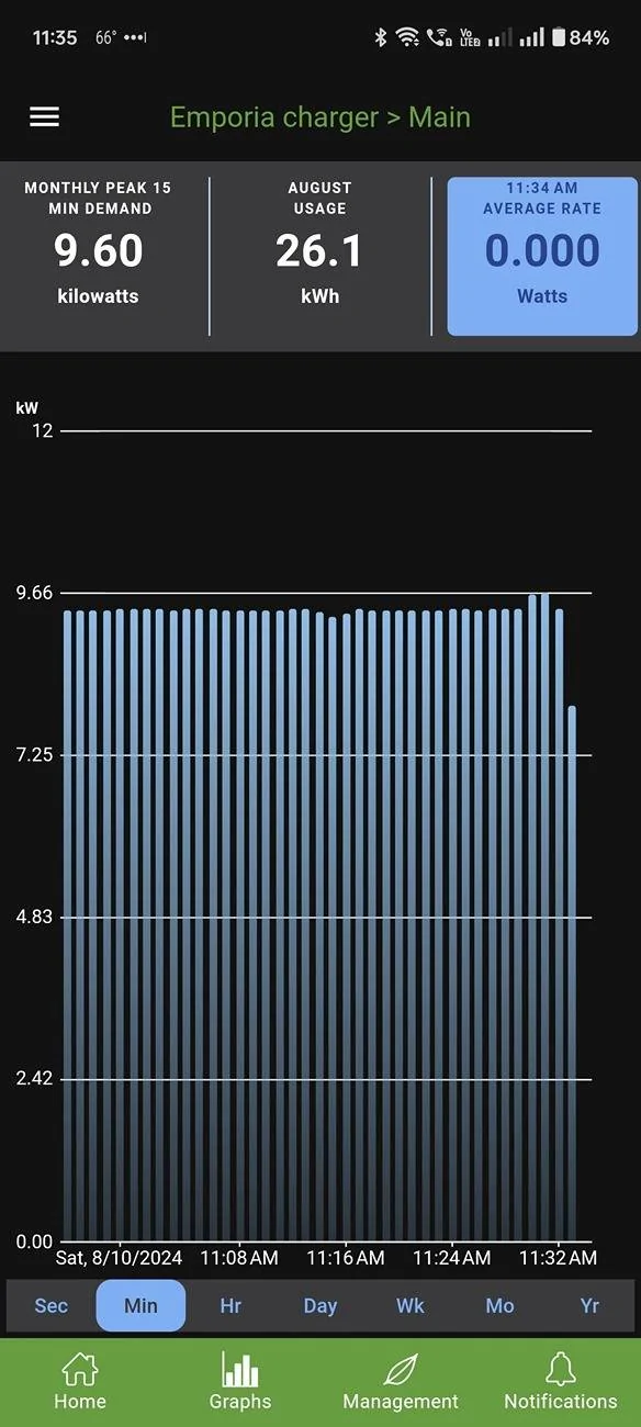

Here is my car charging with the new Emporia and updated module. I did a 50-90 and it held steady
Ford Mustang Mach-E L2 charging speed recently dropped 33% Screenshot_2024-08-10-11-35-54-69_55c0070d8632d0f0143043b6e1e8cb96
