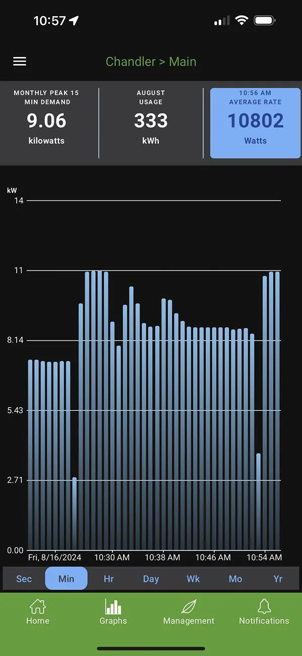

Can’t say the latest software in the car resolves this either.
Ford Mustang Mach-E L2 charging speed recently dropped 33% IMG_6833
Reading left to right, 32amp > stopped and started charging again at 48amps, then it dropped and yoyo’d. And even went down to 3kw annd started again. That second dip wasn’t me at 10:52. Only been 18+ months, I hear the fix is soon.

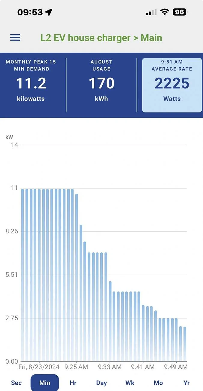

Emporia consistently has been delivering full 11kW (48A) for 2 years (Lightning and Mach E).
Have not seen any drop.
Charge curve below - shows tapering off over 90%:

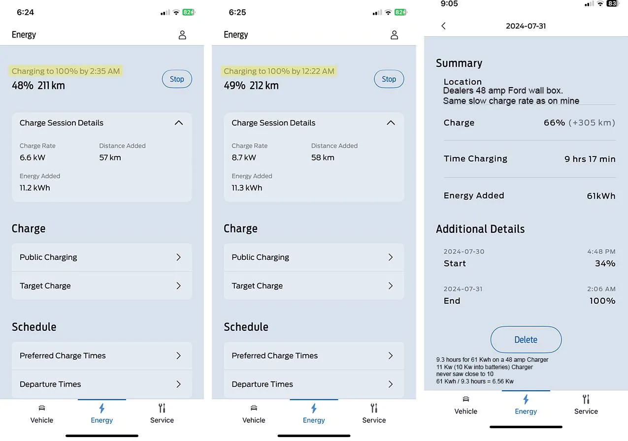

So this is where I am at this stage of trying to get this fixed. The dealer has now reproduced it and acknowledged it.
Here is the final invoice at first they wanted to say all was good and at the end this is what I got.
Ford Mustang Mach-E L2 charging speed recently dropped 33% Invoic
And here is the charging event at their service garage.
Ford Mustang Mach-E L2 charging speed recently dropped 33% Combined
Any suggestions what my next step is in getting this fixed would be appreciated.
