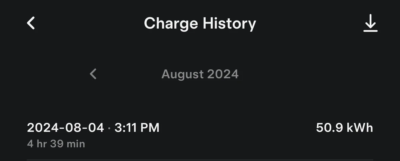

No problems using a Tesla Wall Connector at 240V/48A.
Ford Mustang Mach-E L2 charging speed recently dropped 33% 1000003252
Ford Mustang Mach-E L2 charging speed recently dropped 33% 1000003251
