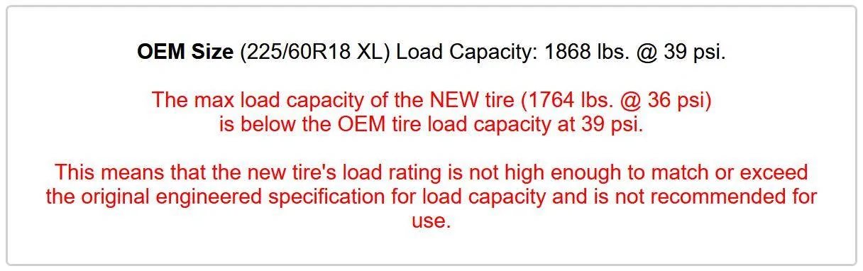

I was looking at the Ford OASIS info for mine and it shows 100H.
Ford Mustang Mach-E Load rating 100 tires meet spec, why are 104 "required"? load

2022 California Route 1 AWD ER
Front GAWR: 2260 lbs
Rear GAWR: 3255 lbs
P225/60R18 standard load 100: 1764 lbs
Two tires per axle: 3528 lbs
Standard tires exceed the rating of the heaviest axle by nearly 300 lbs.
Can anybody point me to ford documentation clarifying their position on 104 load tires. Are they "recommended" or "required"? Does anybody have insight what specifically is wrong with standard tires that exceed the maximum gross axle weights? I've seen many enthusiastic claims - "standard tires can't handle the weight". But, they are rated to do exactly that.
