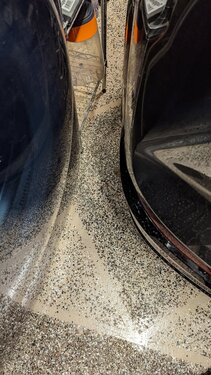

My theory, as I thought originally, of an electrical interference of some sort or large metal object (my dryer) might very well be the cause according to how I read Mach-Lee's comment. In addition, I found this interesting read.
Either way I have a ghost tracking device on it now. We'll see how it goes.
Here's the distance between the dryer and car.
Ford Mustang Mach-E Logs?  Trunk Open PXL_20220108_071252933

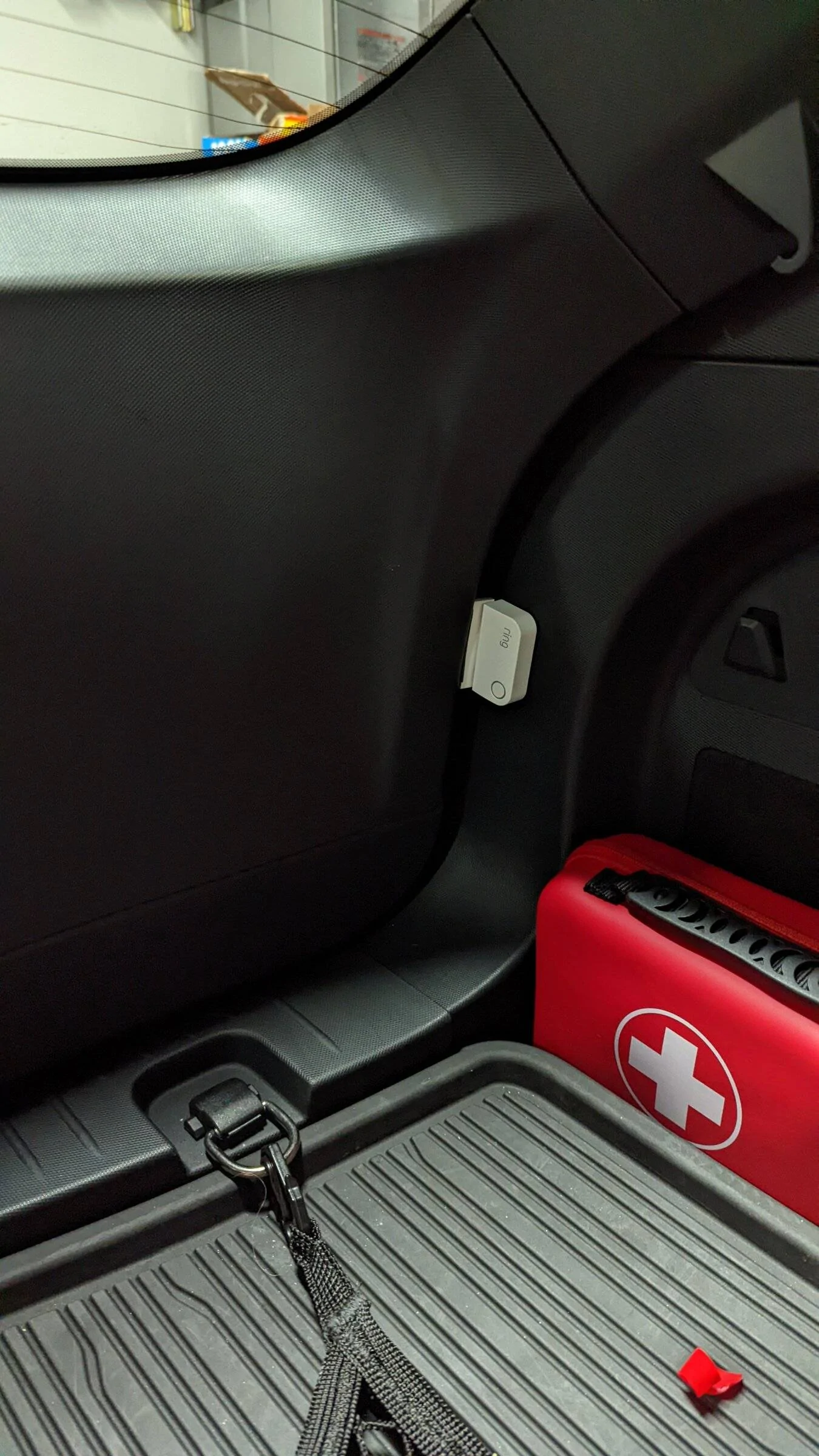

Here's the zwave sensor
Ford Mustang Mach-E Logs?  Trunk Open PXL_20220108_065220642

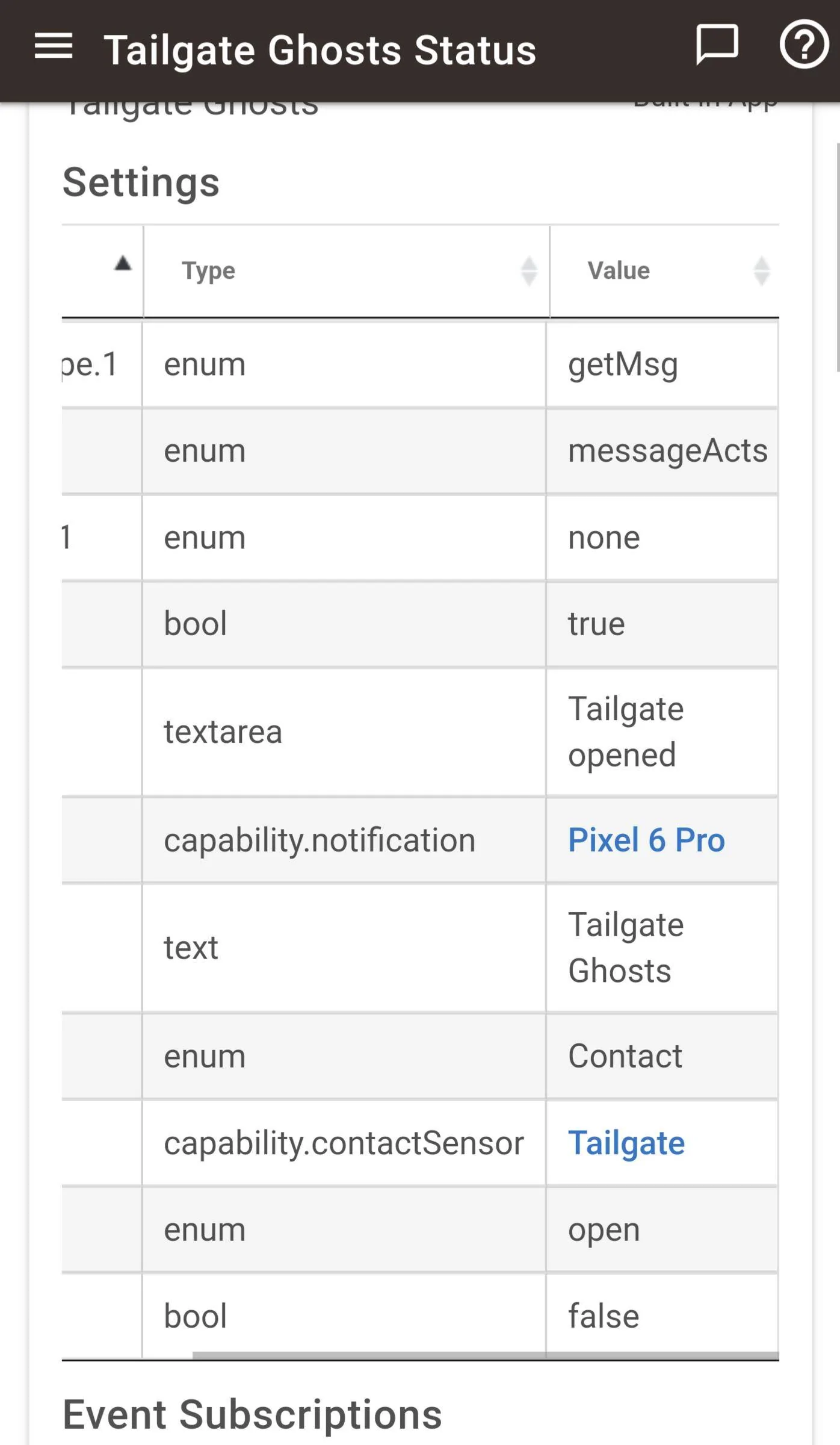

And here's my action to notify
Ford Mustang Mach-E Logs?  Trunk Open markup_26690
