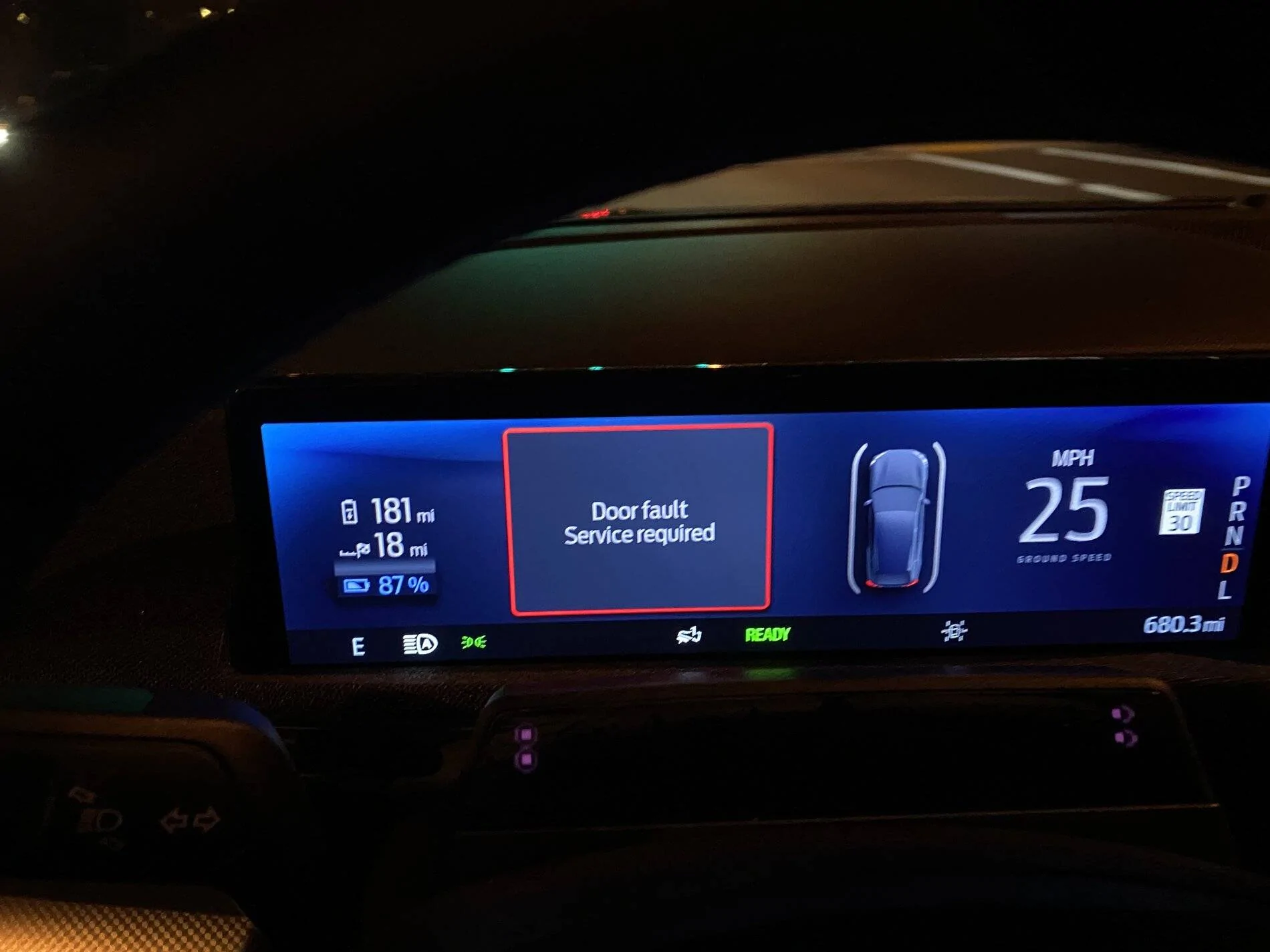

Has anyone experienced this fault? Doors seem to be working fine...
When you got this error what was your location (parked etc)?
In your home garage in parking lot etc?
Did you get it while driving?
Mantooth
Aug 11, 2020
127
323
Seattle
Noticed it just after I pulled out of a parking garage after getting dinner. It is intermittent.
machefan
Jan 14, 2020
1,719
2,450
NJ
IT
So the error comes and goes?
What does the FordPass say the errors is?
