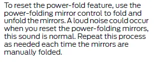

My mirrors are not folding in when I lock the car, despite having this setting turned ON in the car settings. I've turned it off and on multiple times, and it's just not working.
Have you tried this?
