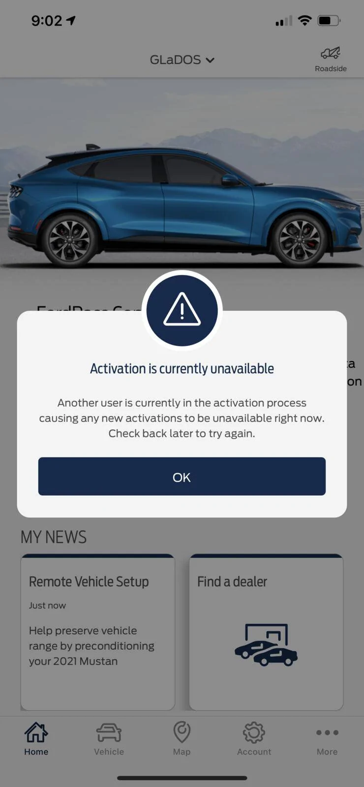

Didn't want to update the main wiki as two of my issues are already confirmed by many. I have the screen whine in the instrument cluster screen and my drivers door has a panel gap issue where a part of the front drivers door rubs on the front fender.
The other two issues I had are with the PDI inspection not updating all the computers in the vehicle before sale and failing activation in ForPass. I am only posting this see if anyone else has issues with the FordPass activation where, in the app, you select activate and I get the error that "Another user is in the activation process causing any new activations to be unavailable right now..." I called Ford and spent an hour troubling shooting before they said to take the car back to the dealer to have them reset the computers. They said that the cars modem was not giving a correct response to the server.
I know the modem is working because my remote profile setup completes without issues. Interestingly, when I enable the app link and open the FordPass app on the Sync screen I get the prompt to activate but selecting activate does nothing. I can kill the app on my phone and re-open on Sync and get the activation prompt but the activate button in the iPhone app still errors out.
I had exactly the same error message when trying to activate at the dealer. I brought the car home and fiddled with it for a while. Eventually I fully deleted the FordPass App off my iPhone, re-installed it, and re-added the vehicle to the App (using the VIN) while I was sitting in the car and the car was on. It finally worked. If you haven’t already, you might try deleting and reinstalling the phone App.
Thanks. Tried that several times. This is what the sales guy and the Ford support number people had me do. A few hours later and still no go. I even tried resetting my phone to factory and trying a different device. I also tried updating the cars modules and resetting their configurations. It's defiantly something strange. I did notice that when updating the modules and resetting them that the configurations would take awhile to stick. For example, when resetting the APIM modules the dash chime would sound like the one in my Flex. I don't know exactly when it corrected itself but it took a few hours before the dash chime returned to "Mach E" normal. There are some bugs to work out for sure.
