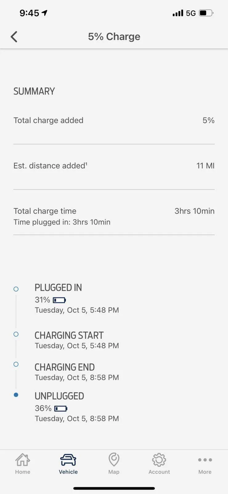

where does it show that in FordPass? See photo here:
If you look at the current charge while the car is still plugged in and charging it should show. You have to scroll down. But with this you can do the math. 5% of your usable battery is either 4.4 kwh or 3.3 kwh. I’m guessing you have the smaller battery.

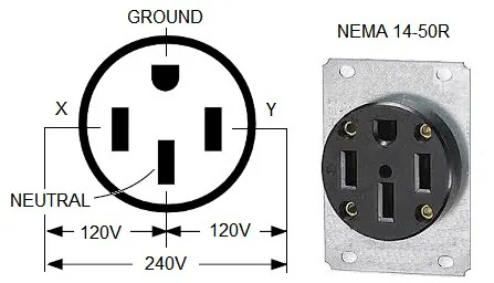

This is what I think as well, he probably swapped a neutral and line around so the charger is only getting 120V instead of 240V. Easy to do if you're not paying attention to the terminal labeling. Because it's getting 120V it might be trying to charge at the L1 rate (3 mph) instead of L2 rate (20 mph).
Ford Mustang Mach-E Mach E Select - Charging Slowly 136290_NEMA_14-50
With a multimeter, check that there's 240V between the left and right (X and Y) slots. X and Y to neutral (center slot) and ground should be 120V.
He could have a loose connection somewhere too, that will prevent it from charging at full rate due to high voltage drop. Last, plug might not be fully inserted into charger or charger could be defective.
