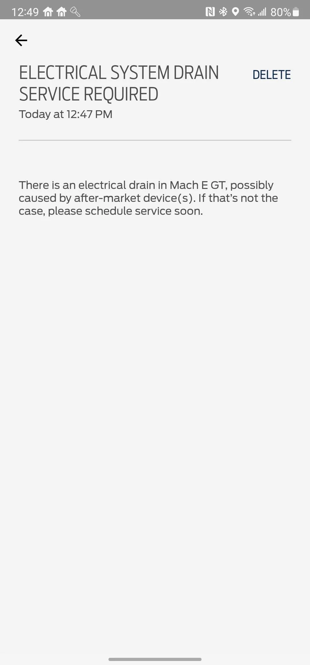

Update and it's not good.
Took the car out to dinner the other night, 30 minute drive. The screen went off and on at least 20 times. Brought it home and scheduled service. 1 wek is first available. Even though screen has had issues, car always drove fine. Don't have an extra car.
Today , heading to the airport, went out to car. Stone cold dead. Assuming something drained 12v battery that was causing other short with sync. Fordpass app says car is in deep sleep and need to start it manually. Well can't even open the door. Will have to deal with it when I get back.
Had to scramble to find ride to airport and will have to spend $100 uber to get home when I get back in 4 days.
Then about 20 minutes ago I get a ford pass error
Ford Mustang Mach-E Main screen DEAD.......AGAIN!!!!! SOLUTION!! Or NOT Screenshot_20220220-124932_FordPass
Ford, I hope you are watching this. Had my car since Oct 31st and it's had electrical problems nearly the whole time. Extremely disappointed. Should of known better.

Car completely dead. Jump box won't power up car. Guess I'll be getting roadside assistance tomorrow to tow from garage to dealership.

Dealer said couldn't find anything wrong with it. Then when they went to back it out screen died. Ordered some new module. Said 12v battery was fine. Then about 20 minutes ago fordpass sends an alert that my 12v battery needs to be replaced. Will call dealership tomorrow and tell them.
And then there's ford. Rep reached out to me and got a case number, but of course nobody has called. Typical.
When I get car back and it does it again I will lemon law it and be done with Ford. Almost cost me a lot of money the other day when I almost missed work. I can't afford for that to be over my head everytime I go to the garage.
