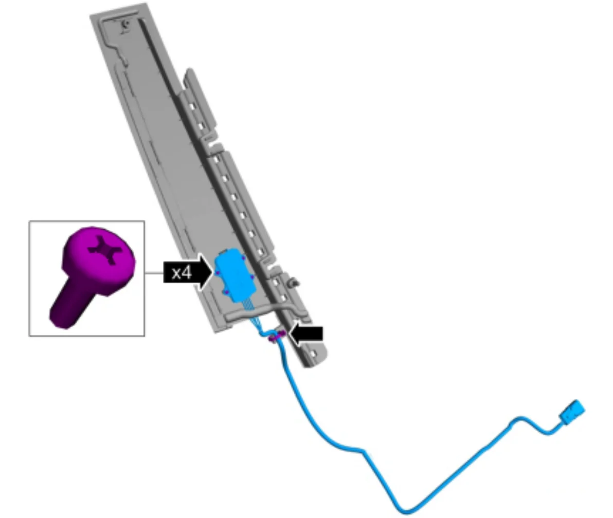

The keypad can be disconnected. The wiring is inside the door.

Looks like the keypad and button are all one 'piece' so if you do manage to unplug it you won't have a working door button either.
Ford Mustang Mach-E Multiple burglaries using keyless entry with keypad code Screenshot 2024-08-05 at 8.56.06 AM
