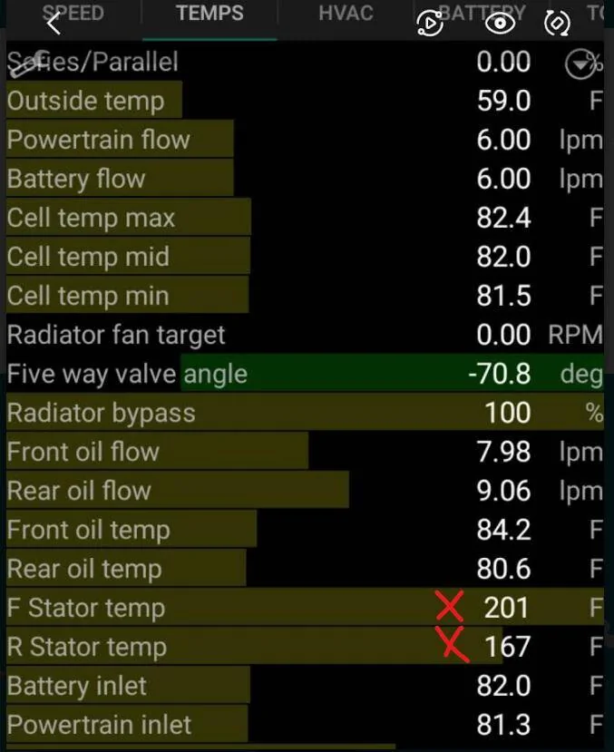

One thing Tesla has done to take advantage of the front induction motor is to pull the extra heat from it, when needed for supercharging and preconditioning the battery. In this screen shot you can see the front stator motor being able to generate much more heat than the rear stator motor.
When the Model 3 or Y is parked and preconditioning, both the front and rear motors pull 3.5 kWh to generate a non-motive waveform of energy to generate heat. When the vehicle is in motion, the rear motor generates heat naturally but the BMS will still have the front motor generate heat, requiring about 2.0 kWh of energy. There was a recent update around March that allowed the BMS to begin the preconditioning process much sooner than previous software allowed. The old software would only start preconditioning 20 minutes prior to the destination. The latest software, it can start 50-60 minutes prior to the supercharger destination. It's a great design in both the hardware and software, something most Tesla owners will never realize as to what's going on in the background. The other thing with the front induction motor is that it's not active unless the car's rear end loses traction, and/or power is needed. It's 100% RWD until needed, so that helps with efficiency.
