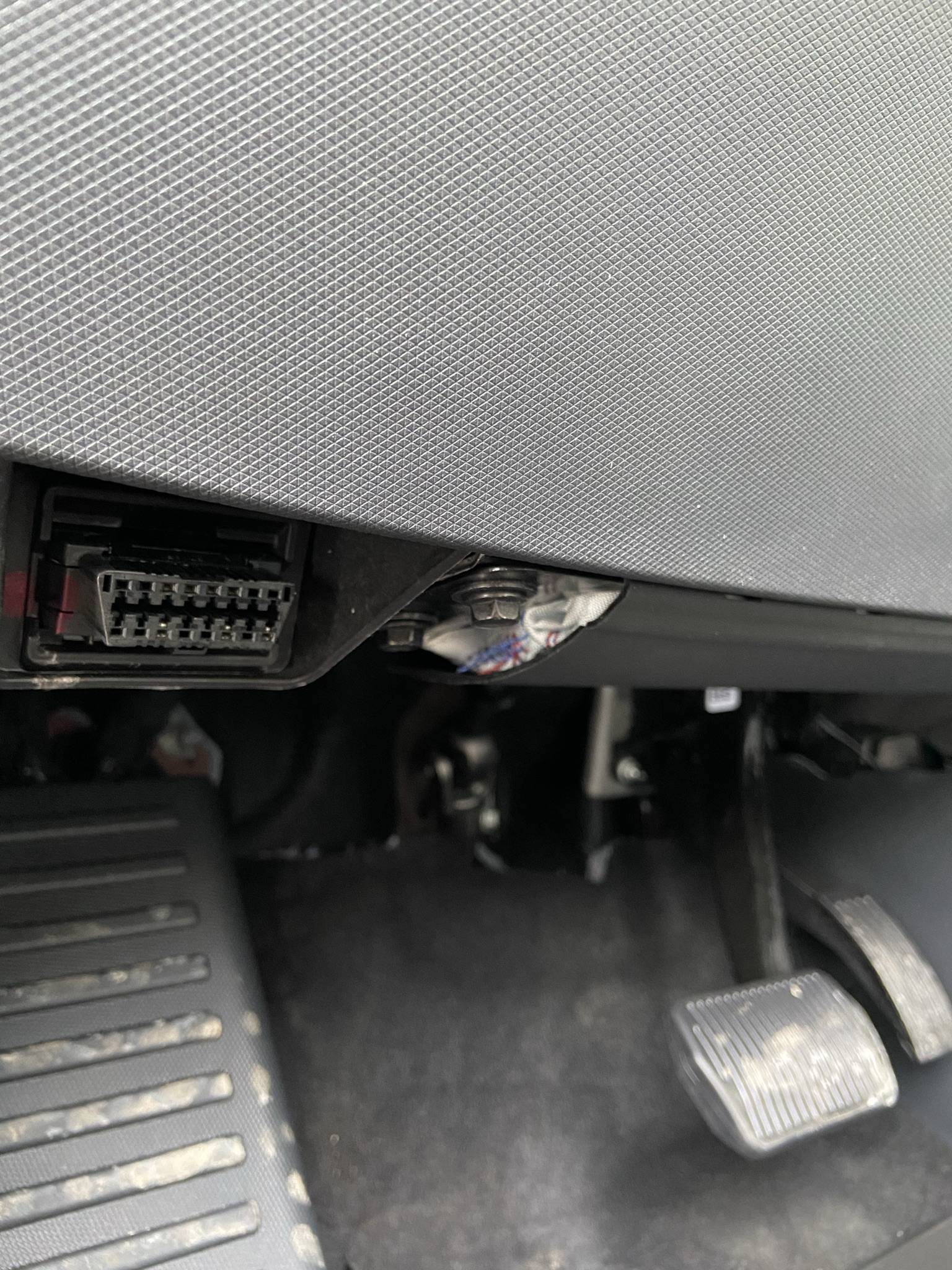

"Easy to install in your car OBDII port" - where is the port in MME?
Below the steering wheel to the left. Same spot it is on most vehicles.
