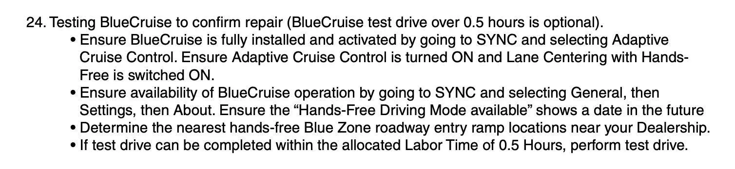

I have a couple of 21G01 questions:
Ford Mustang Mach-E Optional Product Improvement Program 21G01 - BlueCruise Programming Screen Shot 2022-04-11 at 4.29.56 PM
1. Is step 24 correctly written? Bullet #1 mentions "Lane Centering with Hands-Free is switched ON"
Is there actually a switch for this or different indication on the Driver Assistance screen?
Also, for Bullet #2: Where does one find the "Hands-Free Driving Mode available" and date?
1: The Lane Centering toggle under cruise control gets renamed to Lane Centering with Hands-Free with one of the APIM updates
2: You can view the BC expiration date in Settings>General>SYNC Version
2: You can view the BC expiration date in the Settings>General>SYNC Version

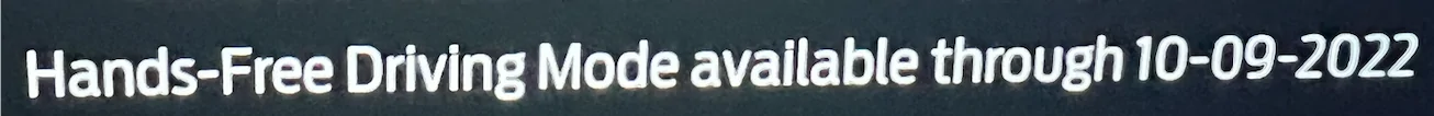

Too many threads on this topic as some of this info is already in another thread.
What was not discussed was how to enable it while driving. I actually find it tricky to get going but it's because I don't normally use the lane assist feature. One thing I did notice is that when you enter a BC location it will popup on the screen that it's available for use.
Ford Mustang Mach-E Optional Product Improvement Program 21G01 - BlueCruise Programming Screen Shot 2022-04-12 at 10.07.29 AM
