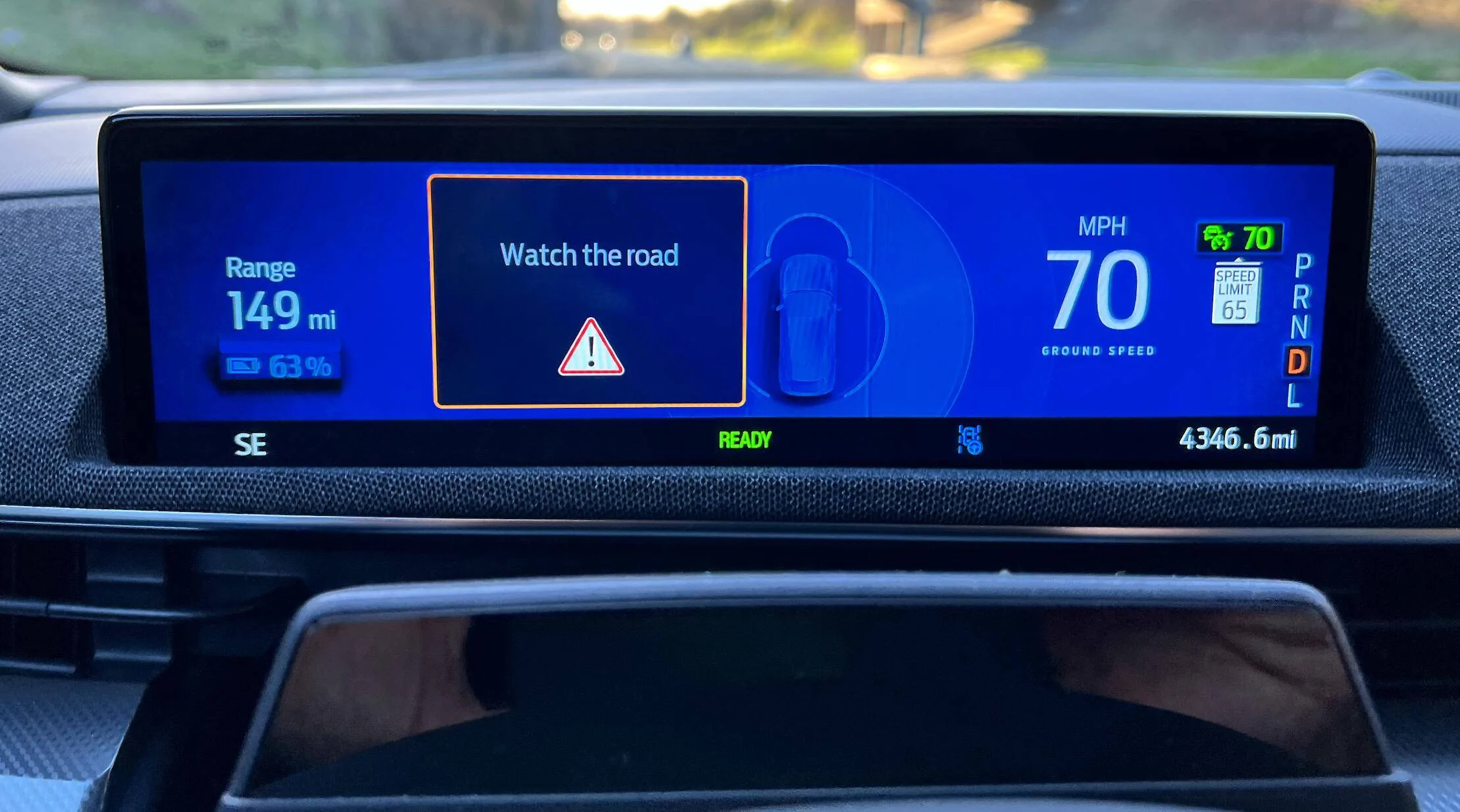

You will. Even when you're not using BlueCruise, the eye nanny is added to the mix once the driver monitoring camera is updated.
I think I pay attention to the road pretty well. I hope it doesn't bug me even when I am actually looking ahead. Is the nanny accurate? Does it only come on if the driver is looking elsewhere?
The eye nanny appears to be very accurate. Seems you can look away for about 10 seconds before it nags you.
It's been accurate for me so far. But if you look at the infotainment screen for a little too long, it will nag you.
Okay. Thanks. No issues for me then. ?
And if so, then I am not as safe a driver as I think I am. :)
Or even looking at the IPC too long, it will nag you.
Like when you put your phone (AKA camera) in front of it to take a picture. One thing I was wondering before today was how it would respond to my sunglasses. I experienced no issues with it at all.

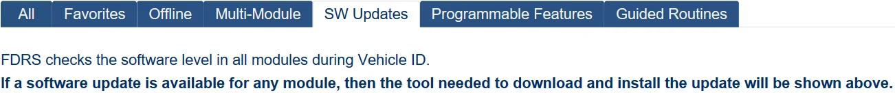

Day 7 update: Still no BC. My car is sitting at the dealer and hasn't actually been touched since the 7th.
The good news: I received a call from Ford and have a tracking number. Something was done on the server side to ping my car and I am hopeful the missing update will show up in FDRS when the dealer tech checks my car in the morning. Fingers and toes crossed.
The dealer indicated the job 1 F150's and MME's are piling up for them with the same problem. Because the Squeaky wheel gets the grease, the more this squeaks the faster it will get solved.
The Bad news: Another day buying gas for my loaner. (you really appreciate the MME when you drive something less again!)
The score is still OTA 0 Dealer 0 but there is the light at the end of the tunnel.
I really hope they see something tomorrow because it looks like it hasn't populated in FDRS so far
Ford Mustang Mach-E Optional Product Improvement Program 21G01 - BlueCruise Programming Screen Shot 2022-04-11 at 3.55.16 PM
If it's any consolation, I am in the same boat. no updates for my car either
