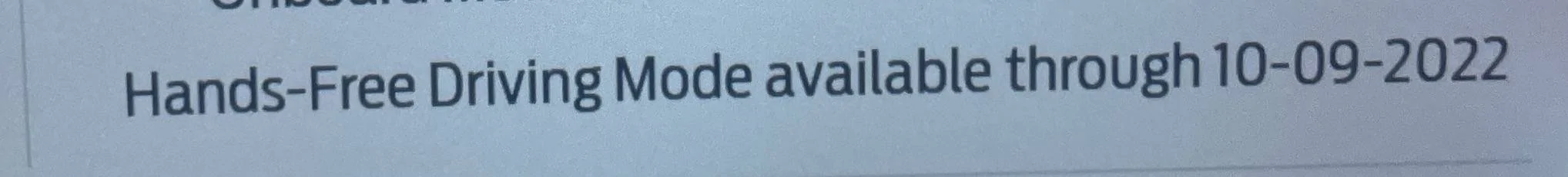

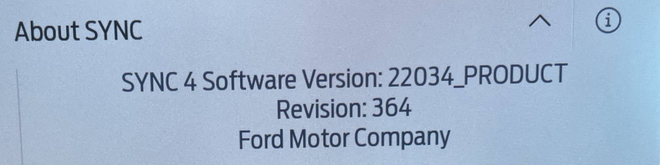

Persistence paid off -- sort of. With multiple tries they got the final APIM installation to work. However, now it's good news and bad news.
Good news:
Sync says v364 and Hands-Free available

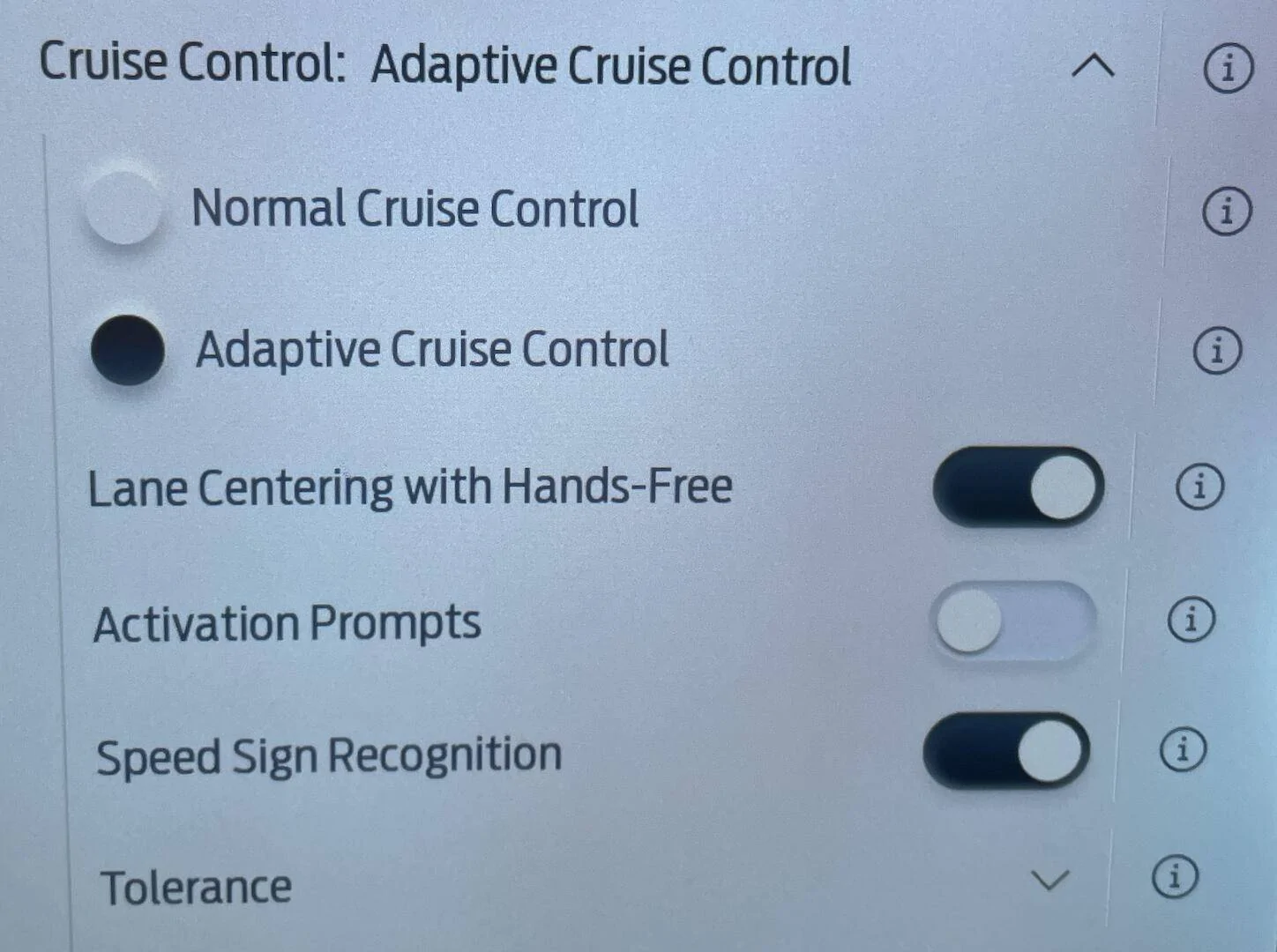

Hands-Free is turned on

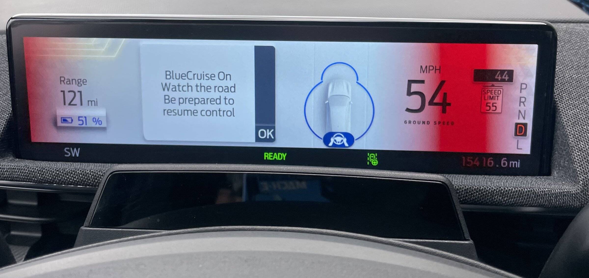

Instrument Panel says it has BlueCruise is on:

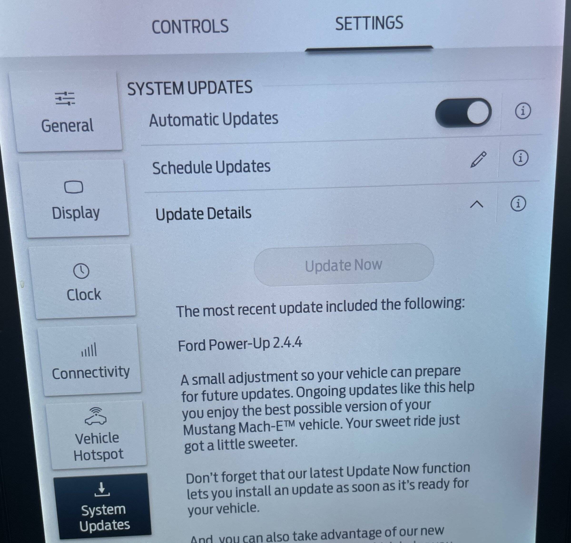

Marlin think he's on Power-Up 2.4.4

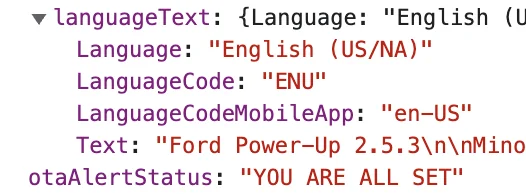

JSON says 2.5.3

At this point I'm hoping the rest of it resolves on its own, through finalizing the pending 2.5.3 update, or perhaps on the Ford end. I have Marlin back home.

Sync and Hands-Free available are in the Sync info on the General Settings page.
Hands-Free on is under Adaptive Cruise Controls on the Driver Assistance Settings page.
Power-Up number is on the System Updates Settings page.
