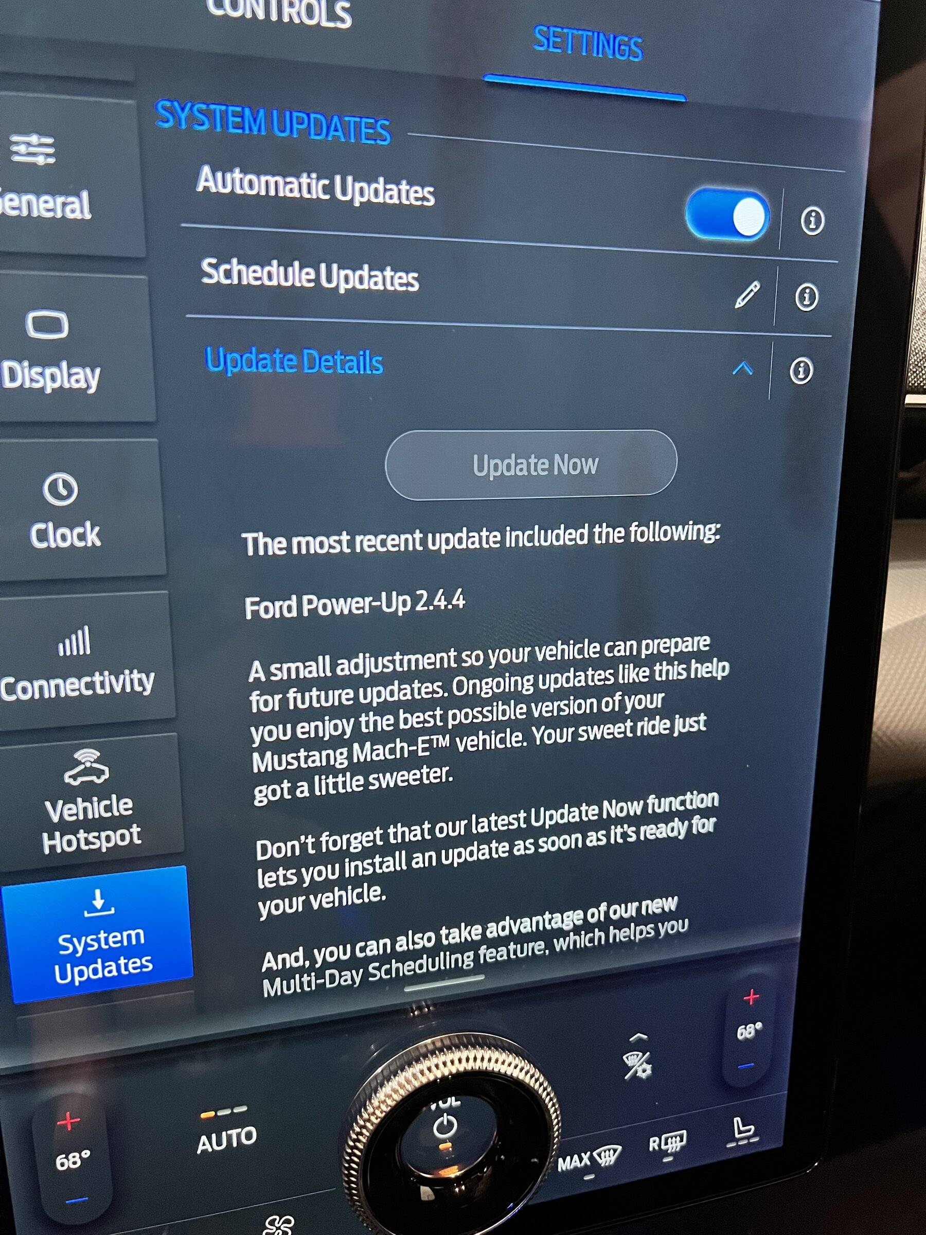

Sync and Hands-Free available are in the Sync info on the General Settings page.
Hands-Free on is under Adaptive Cruise Controls on the Driver Assistance Settings page.
Power-Up number is on the System Updates Settings page.
You are good, the power up is still on mine too and I have Blue "Cheese" working. I think because our updates were not OTA and it's just reporting the last update that was applied. So really we won't see that go away until something supersedes it.

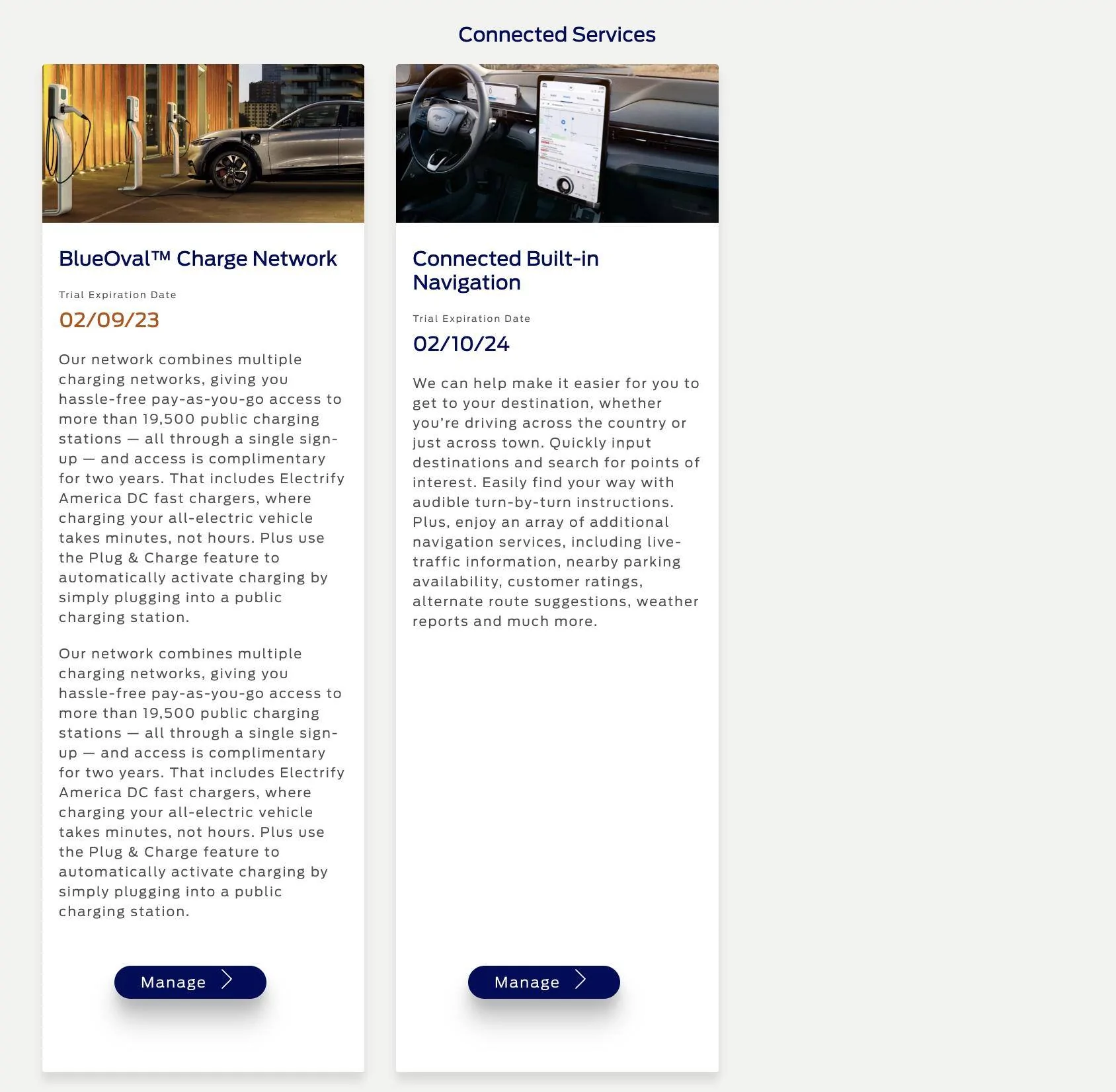

The question is still what is holding up my BlueCruise? It doesn't show up in my Connected Services:
Ford Mustang Mach-E Optional Product Improvement Program 21G01 - BlueCruise Programming Connected Services - no BlueCruise 2022-04-12 at 2.50.22 PM

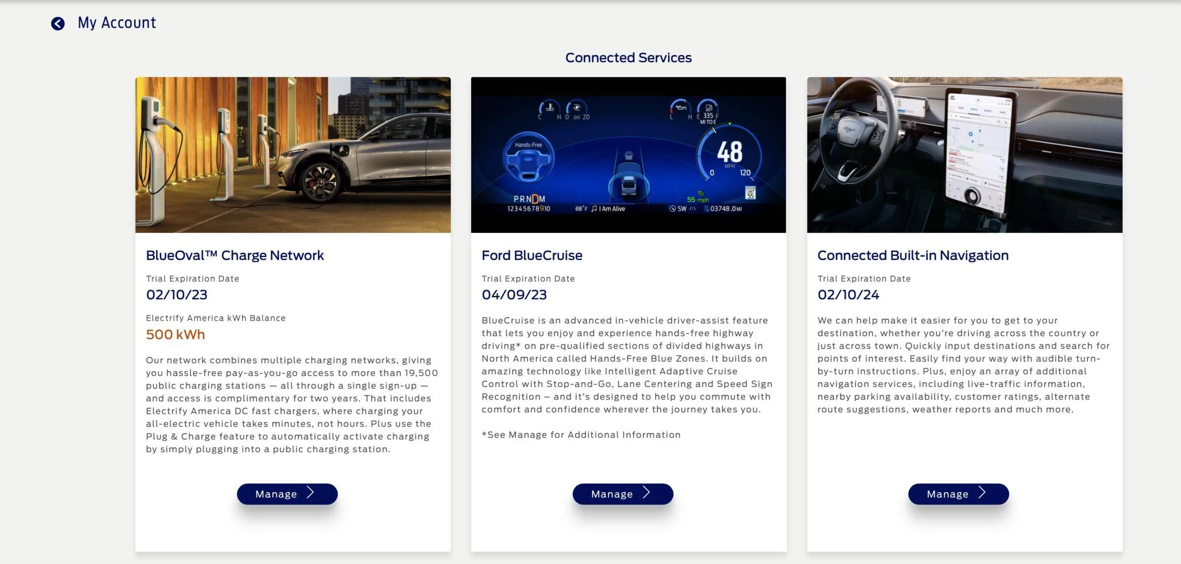

This what I see, I want to note that it took about 3+ hours after the last update for it to show up.
Ford Mustang Mach-E Optional Product Improvement Program 21G01 - BlueCruise Programming Screen Shot 2022-04-12 at 4.24.17 PM
We are both in the same boat. The technician is so frustrated at this point because he feels he has done everything possible. I think I will pick up my vehicle and hope that in a few hours Blue Cruise will show up in my Connected Services.
