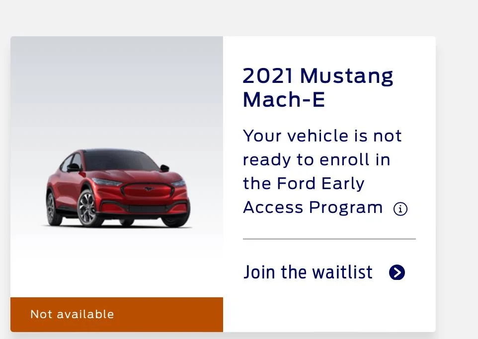

Thanks, you just helped me make my case that you don't need to be in EA to get BC to work.
He said he signed up for it though? If you've signed up for it before that might be enough even if you weren't let in? It wouldn't surprise me if the VIN lists that got sent to the server also included waitlisted cars due to an oversight. I think we should be asking if people are on EA waitlist, admitted, or never signed up.
I just signed up again! :)
Once I accessed the EA webpage, it jogged my memory. When I tried to sign up last year, I got that same screen. I signed up for the waitlist. AFAIK, I was never enrolled in EA.
