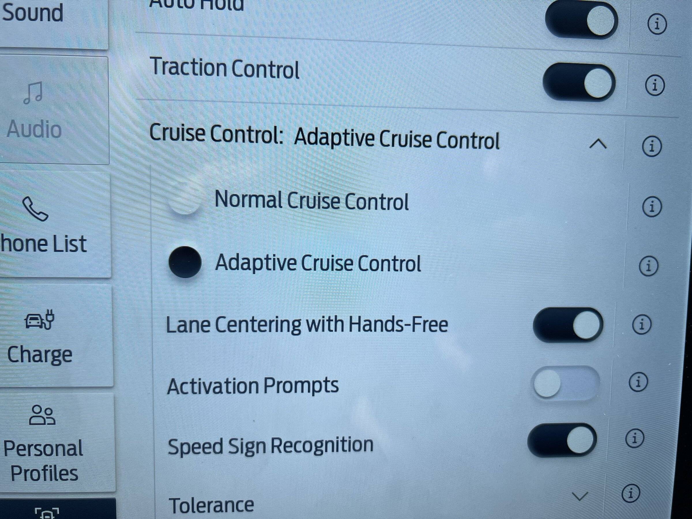

Well I ran the GWM update and once that finished, the APIM update appeared. I ran that update, reset the APIM twice and...
Ford Mustang Mach-E Optional Product Improvement Program 21G01 - BlueCruise Programming IMG_0274
Ford Mustang Mach-E Optional Product Improvement Program 21G01 - BlueCruise Programming IMG_0275
another non Early Access success!
why Ford's servers just barely figured out what was going on with my car I will never know, but they are getting there, slowly but surely.
SOOOO Gooood! Now if this can be repeated by my dealer...
Was the GWM update available in FDRS or did you get it through PMI?
It was in the SW Updates list first thing this morning. no PMI required
