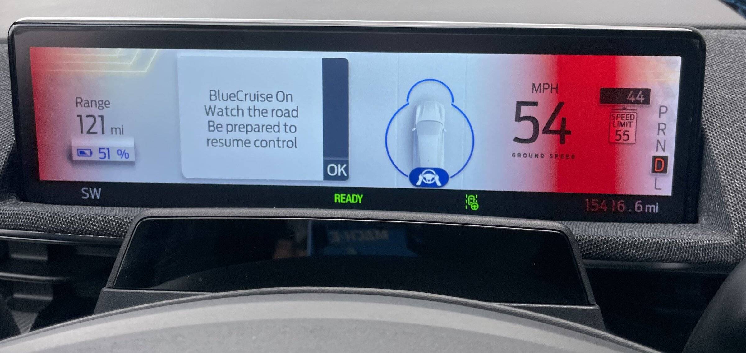

I did the same thing when I went in on Monday. Marlin was at Sync 258 so the last update wasn't there. Having a tech who had never used BlueCruise test it was the real mistake. He took it out for a test drive not knowing what to look for and after having missed the step that should have shown him there was no Hands-Free to turn on. I think he was fooled by this screen:
Ford Mustang Mach-E Optional Product Improvement Program 21G01 - BlueCruise Programming BlueCruise On - sort of
Nope. That's not Hands-Free!
