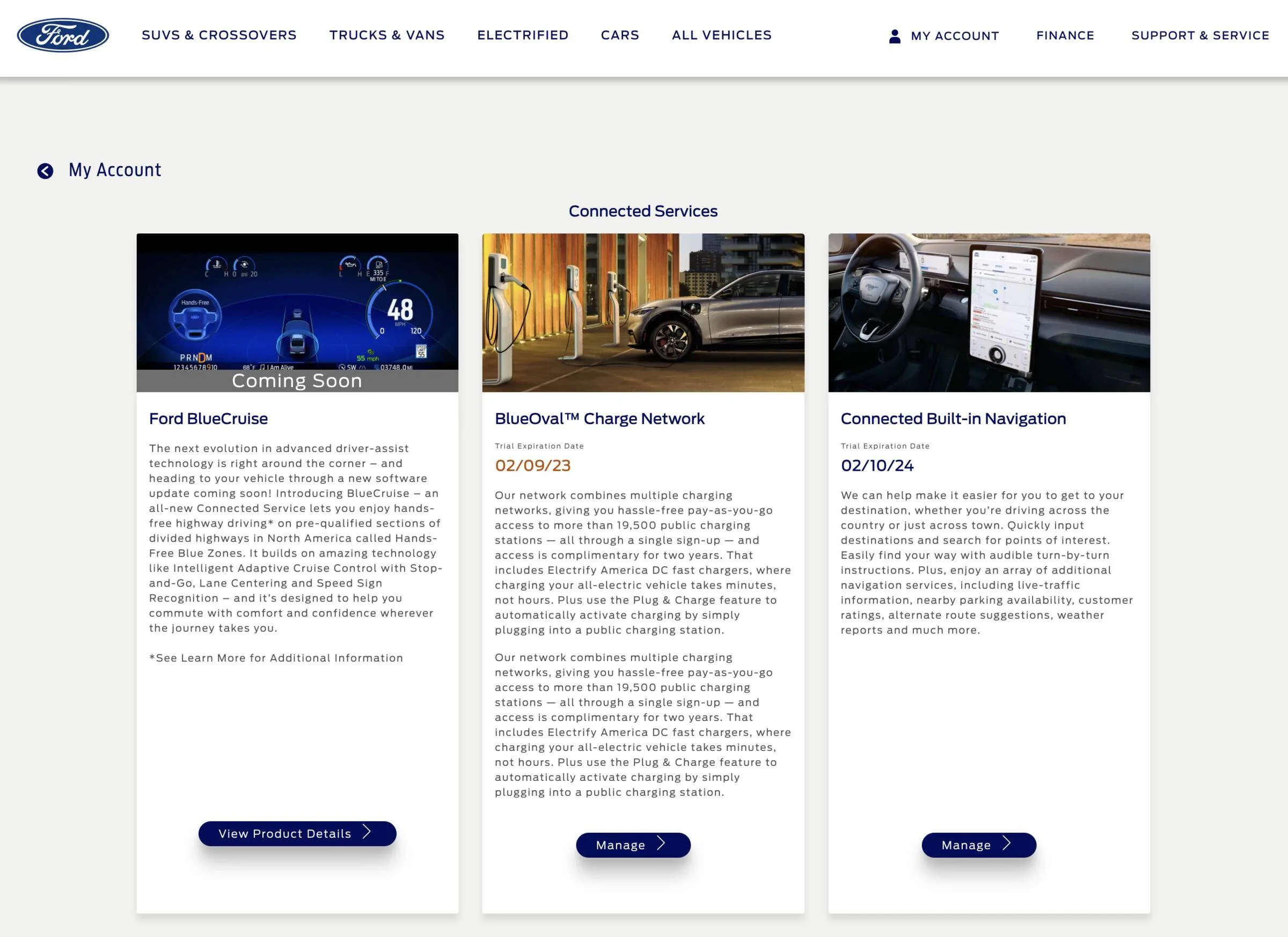

Same thing for me. I just checked and says "coming soon". Is Ford updating their list or something?
That's where I am as well. The dealer thinks they did everything but I never received an activation invite from Ford Pass. My Connected Services had no Blue Cruise but now the ad for BC is back but still not activated.

2. Log into your Ford account with a desktop browser, click "connected services", and verify your Blue Cruise subscription started (it should be recently activated)
Yeah. When I log into my Ford account it just says BlueCruise coming soon, which is why I'm fairly certain I'll be one of those with a tech that thinks that lane-centering is BlueCruise and probably end up on 358. Just wondering how long I want to keep my car in the shop for them to try and figure this out.
