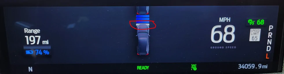

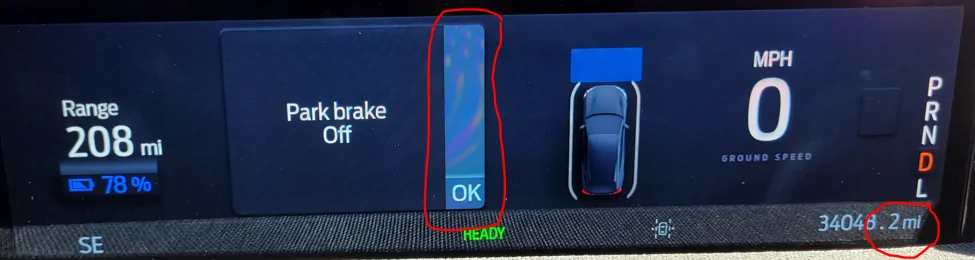

I got my car back finally. Whoo Hoo!
Noticed some changes. I got my tenths back on the odometer. The alert messages have the bar on the right side and now all 4 ACC distance bars remain but some are blue and some are white.
I haven't noticed anything else different. Other than the outgassing from the urethane adhesive used to reseal the pano roof. That stuff stinks. It's kinda a good thing that I didn't get my car back on Monday because I am sure the smell was much stronger back then.
So anyway....
No BlueCruise for me. It didn't work. Dealer doesn't know why. Ford Hotline was of no help. They are totally baffled.
The really funny part is the paperwork says "UNABLE TO COMPLETE FSA 21G01 AT THIS TIME. CUSTOMER REQUESTS TO TAKE VEHICLE AND WILL BRING BACK AT A LATER DATE."
The first two parts are true. I never said I would bring it back. That is just wishful thinking on their part. This whole fiasco has already cost me $55 in fuel for the loaner car and 5 hours of my time.
