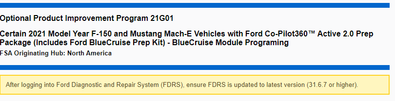

I see they added this to the notice when a dealer goes to look at the documentation for 21G01.
I guess its something, but feel like the actual step by step guide should have been updated with this as well.
