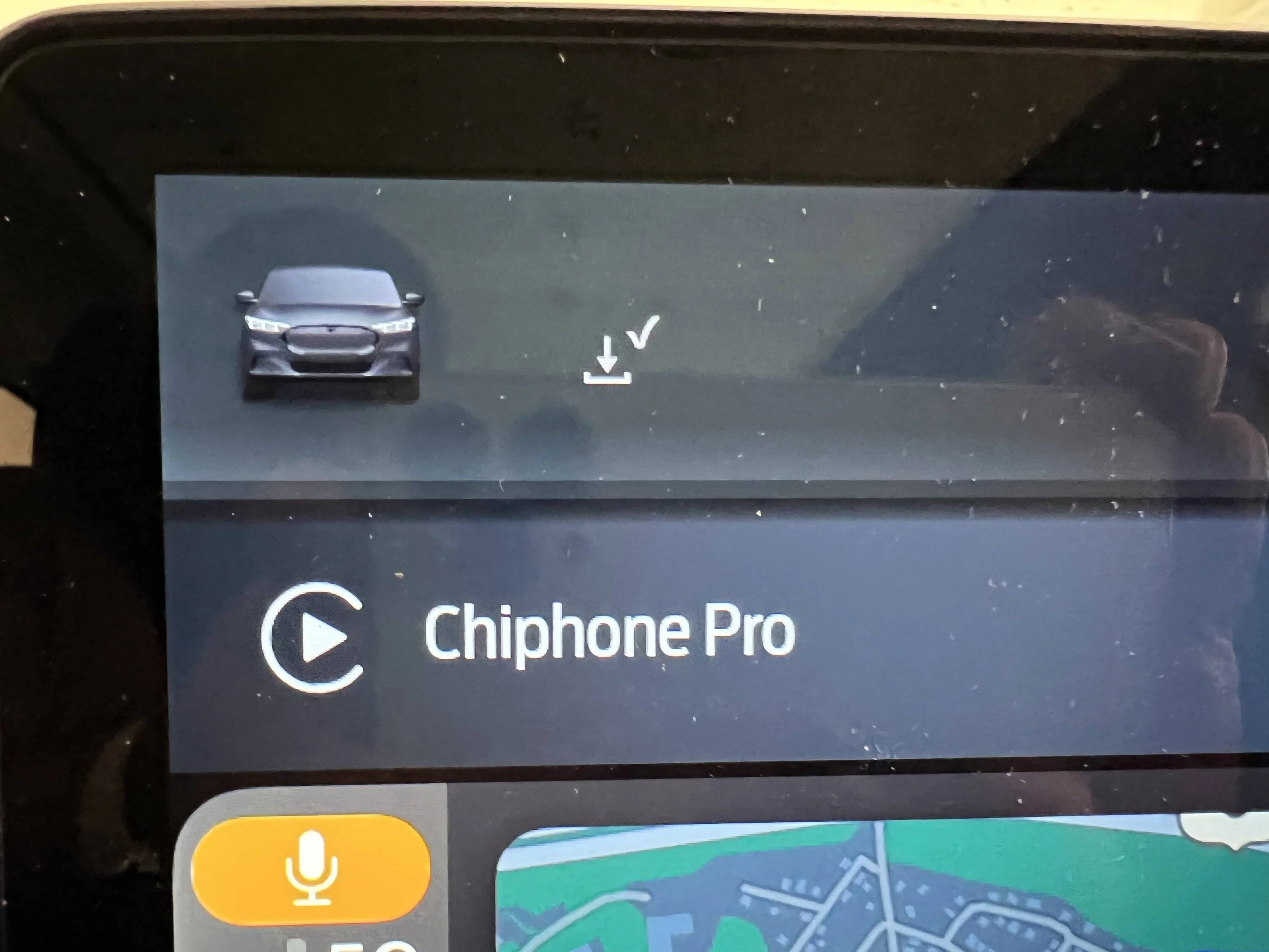

Where do you see these update notifications? Through FordPass app or in the car's screen?
Yes, both.
In the car there will be a check mark icon in the upper left and in the app a banner will appear with a green check mark.
