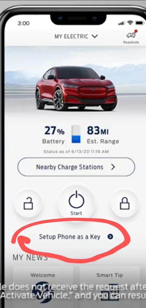

At least you have Paak. I can't get the option on Fordpass to even show up (I'm missing the circled option). I think it may have to do with Android Auto also not working. Very frustrating.
