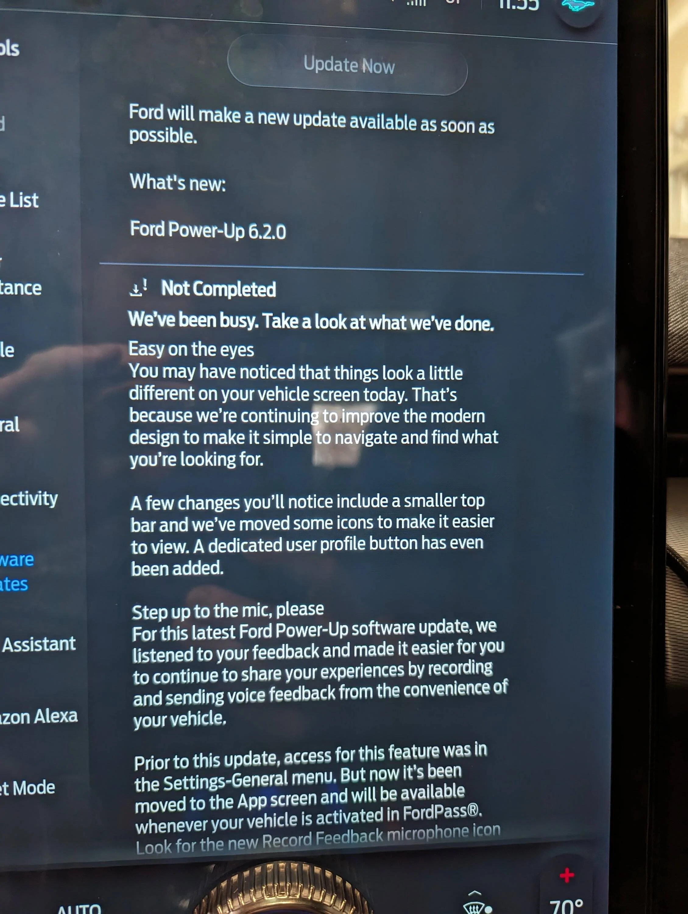

Werid. Mine stuck in 6.2 that will not install m
To get past that, I had to put a 12v battery charger on my car ('23 GT Perf) and top it off. Then 6.2.0 finally applied.
HOWEVER ... once I got 6.2, I never got anything newer and it's been about 10 days. I was surprised when more than a week elapsed with no attempt to advance to the next update.
I been thinking about trying this.
Are you in the EAP? Nothing past 6.2.0 has been pushed to non EAP vehicles AFAIK
EDIT: It has since been pointed out to me that at least some non-EAP '22 vehicles have 6.4
