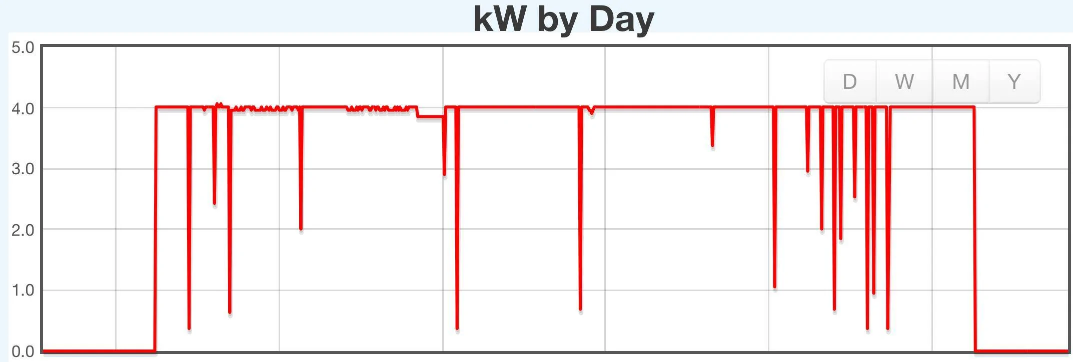

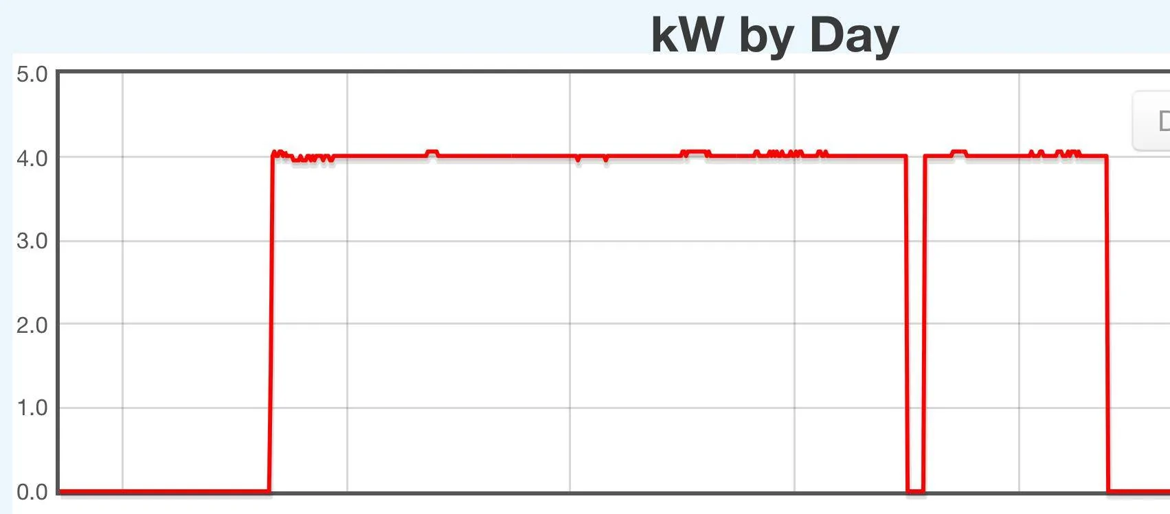

I first noted the problem when my charge profile went from this
Ford Mustang Mach-E Power Up 6.x Poll 1703890271836
To this,
Ford Mustang Mach-E Power Up 6.x Poll 1703890299379
What the heck was going on, I reduced the charge from 4 kWh to 1.4 kWh and guess what? The battery SOC went from 70% down to 68% overnight!!!
I believe the dips in the charge profile are when it switched between cooling or heating.

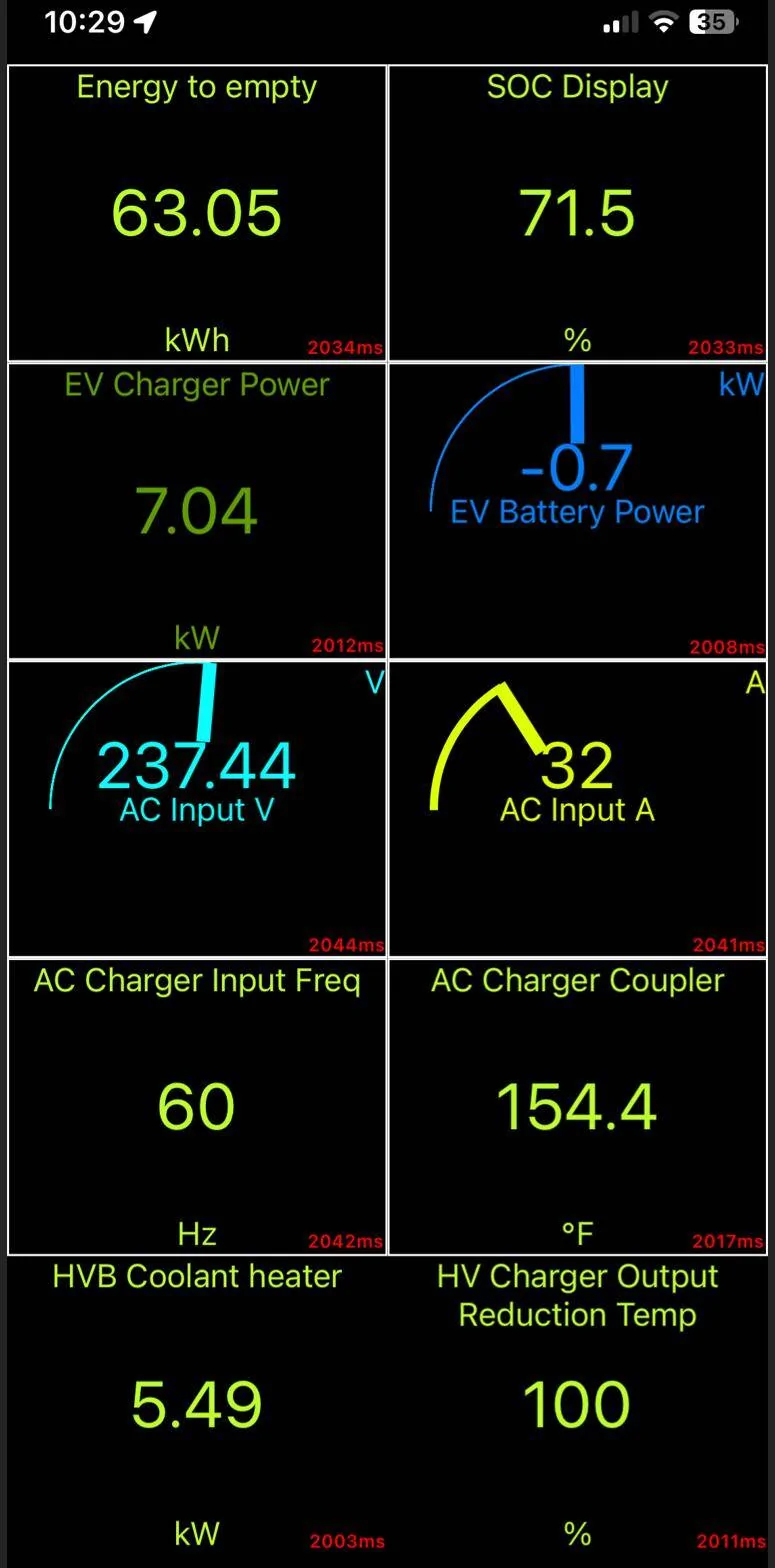

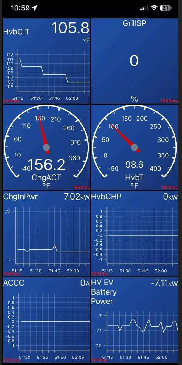

Here are a few scans that I used to construct the Excel file. This is when it was charging normally, although the inlet temp (upper left) is dropping, the HVB temp stays at 98.6 for until the AC compressor kicks on:
Ford Mustang Mach-E Power Up 6.x Poll 1703890481357
All of the input NRG was going into charging and the grill vents were closed.

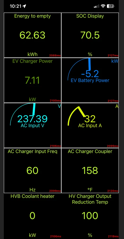

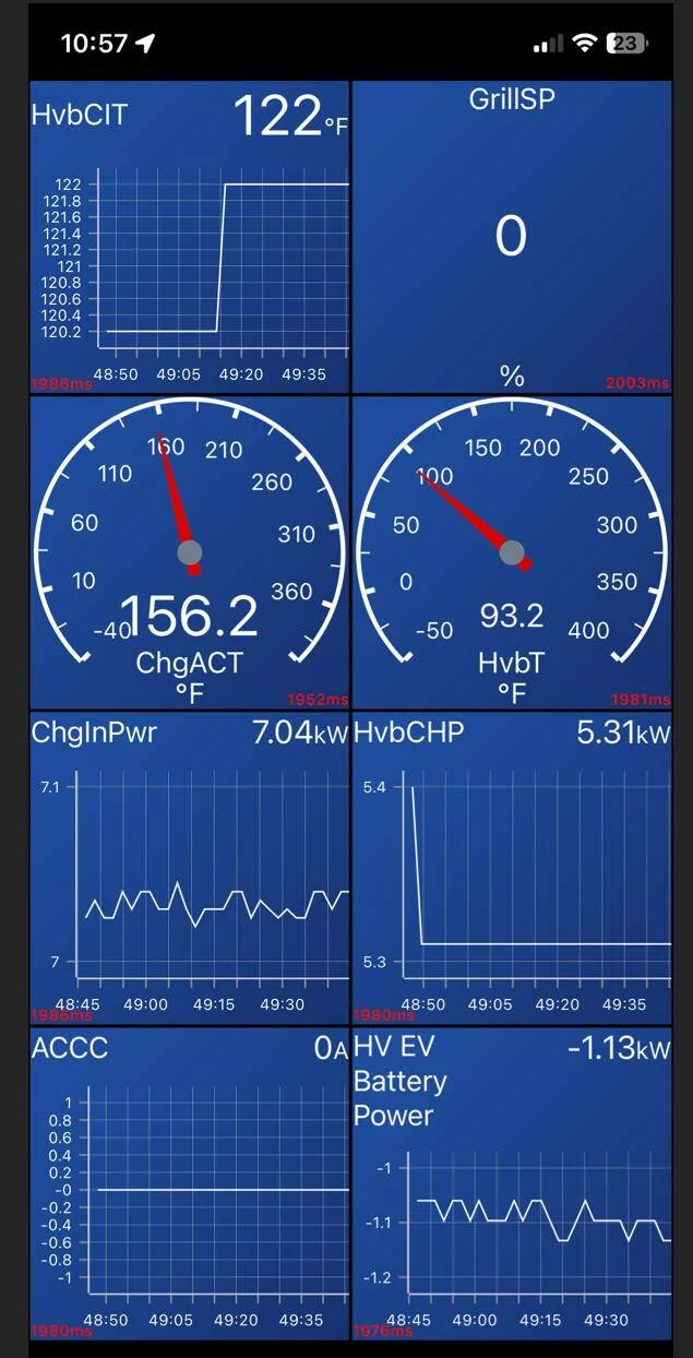

Here is what it looks like when the inlet heater is drawing over 5.3 kWh (no wonder I lost SOC with only 1.4 kWh) notice the bottom right charge - this is how much is going into the HVB.

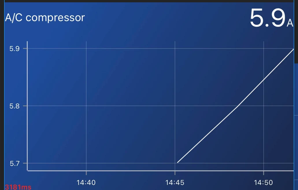

Here is the scan Pic for the AC Compressor Drawn ot as bad as the heater but it would suck up every amp (6) when I had the charger set at 1.4 kWh:
Ford Mustang Mach-E Power Up 6.x Poll 1703891094009
Ford Mustang Mach-E Power Up 6.x Poll 1703891138953
