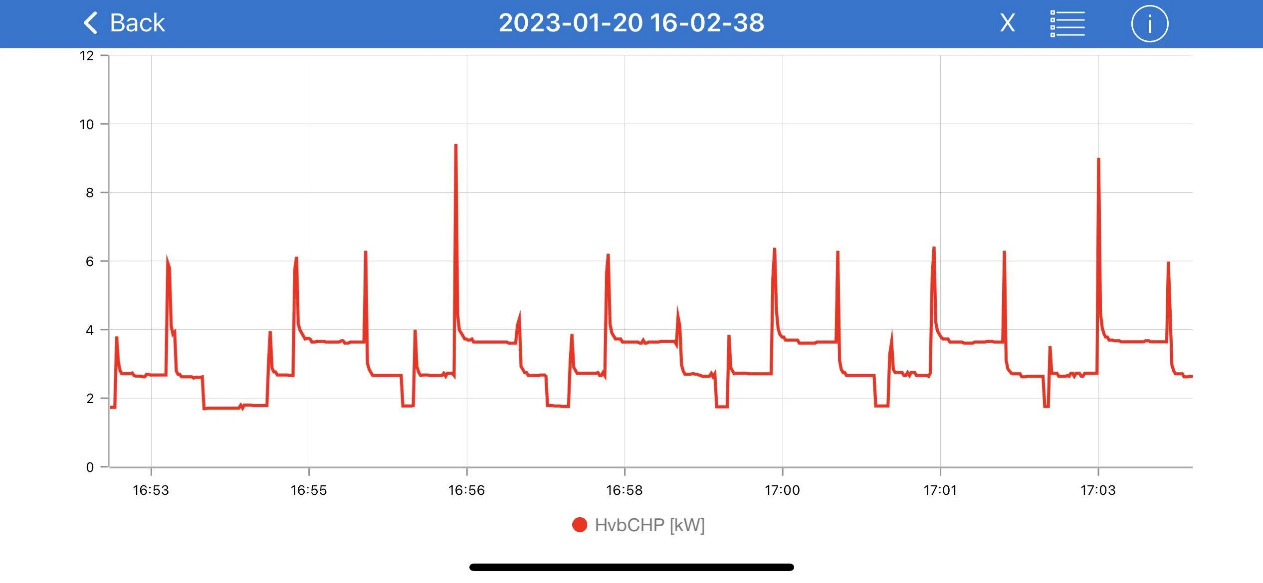

At 26°F outside I’m averaging about 3 kW of heater power with a 68°F setting (see graph). The maximum heater output is 5-6 kW depending on return temperature. That’s how I got ~2.5 kW remaining for battery heating. I’d be shocked if you could maintain 60°F inside with only 1 kW in single digits.

I guess I'll just have to take a winter vacation up north to test this out. For science!!
