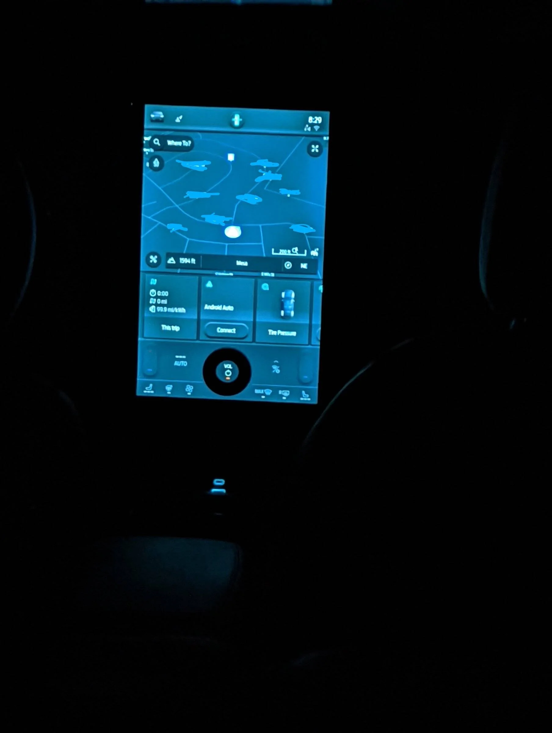

I went to see if anything else happened while I was gone and sure enough, SYNC was open with my profile even though the car was off and I hadn't opened any doors.
Ford Mustang Mach-E PowerUp-2.4.2 going out PXL_20220325_032953707~2
So I keyed in my door code again (PaaK didn't work ?), open and shut the door, and let it go back to sleep, screen off.
