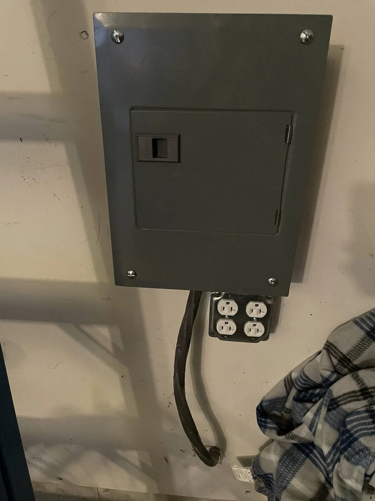

Not super exciting because I don’t have a charger yet but I managed to get a 100 amp panel installed in my garage from my main panel that’s in my basement and about 75 feet away. The actual exciting part? What would have cost me a couple thousand bucks ended up being completely free because of a favor for a friend. Now I need to shop for a charger.
