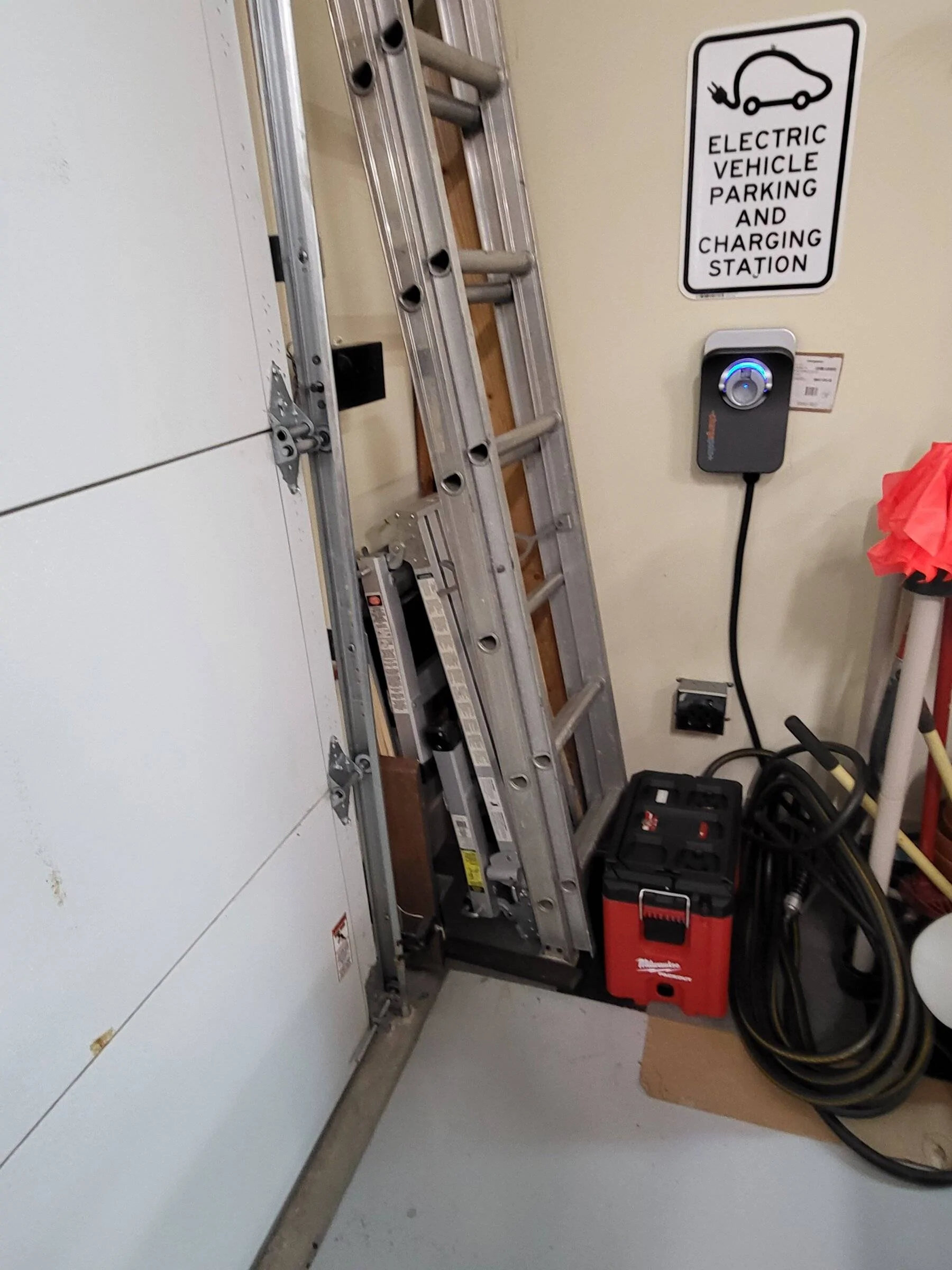

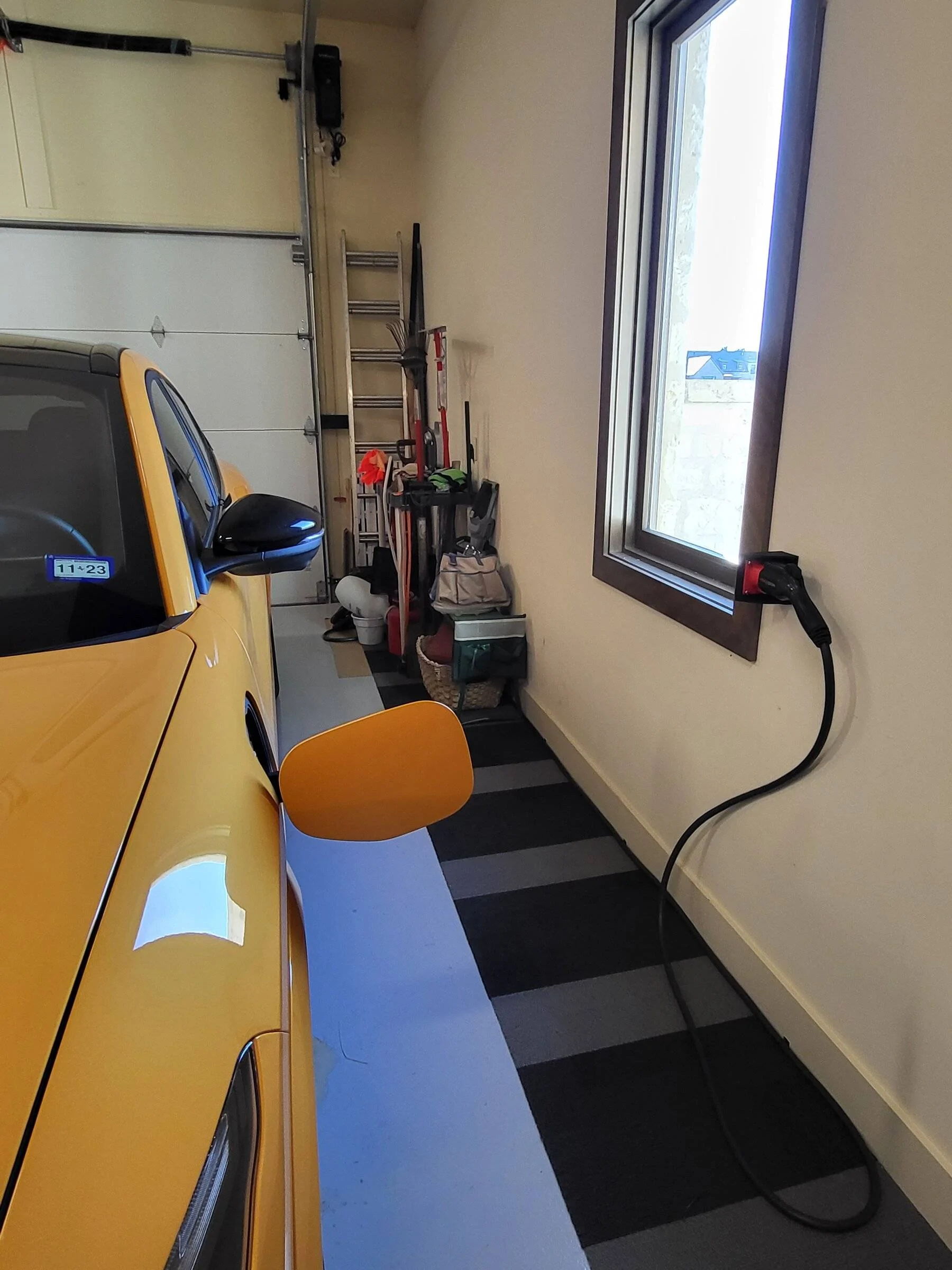

I have the ChargePoint Flex hardwire installed on a 60 amp circuit. I placed the unit near the garage door so that I could change either inside or outside if needed. I 3d printed a plug holder and placed on the wall next to where I normally park the car. Very handy to just reach over, grab the plug and insert in the charge port.
