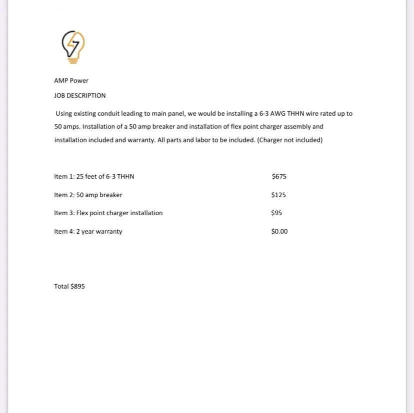

Running the wire and installing and installing the plug isn't the hard part. I have no clue how to put in the 50A breaker.
I got the first itemized quote in earlier today and the guy is trying to charge me $695 for 25' run of 6 gage THHN copper. I went back to Amazon and Home Dept and this should no more than a $100. I am really thrown off by the sticker shock and discrepancy in the pricing. Attaching a copy of the quote below, any insight is appreciated again.

Well they always overcharge on parts. You could buy the wiring and the wire puller for less than $100 then pay someone to just make the final connections. Does he plan on using the conduit as a ground since he only mentions 3 wires.
breakers just snap into place, assuming you have ample room in the panel. Usually you try to even out the loads on both sides.

That's the amounts that I had in mind. I did post the first itemized bid I got above here, labor's only about $100. A couple of ppl that swung by also referred to this a small job, so I would think timewise this should only 1-2 hrs.
My ballpark numbers are costs. You should expect any contractor to mark these up by some amount.

25 feet of 6-3 THHN, the 3 means 3 wires plus a ground = 4 wires.
I took THHN to mean single wires because that’s what you pull through conduit. I guess I should have read the top part. A 6-3 THHN complete cable makes no sense for conduit.
