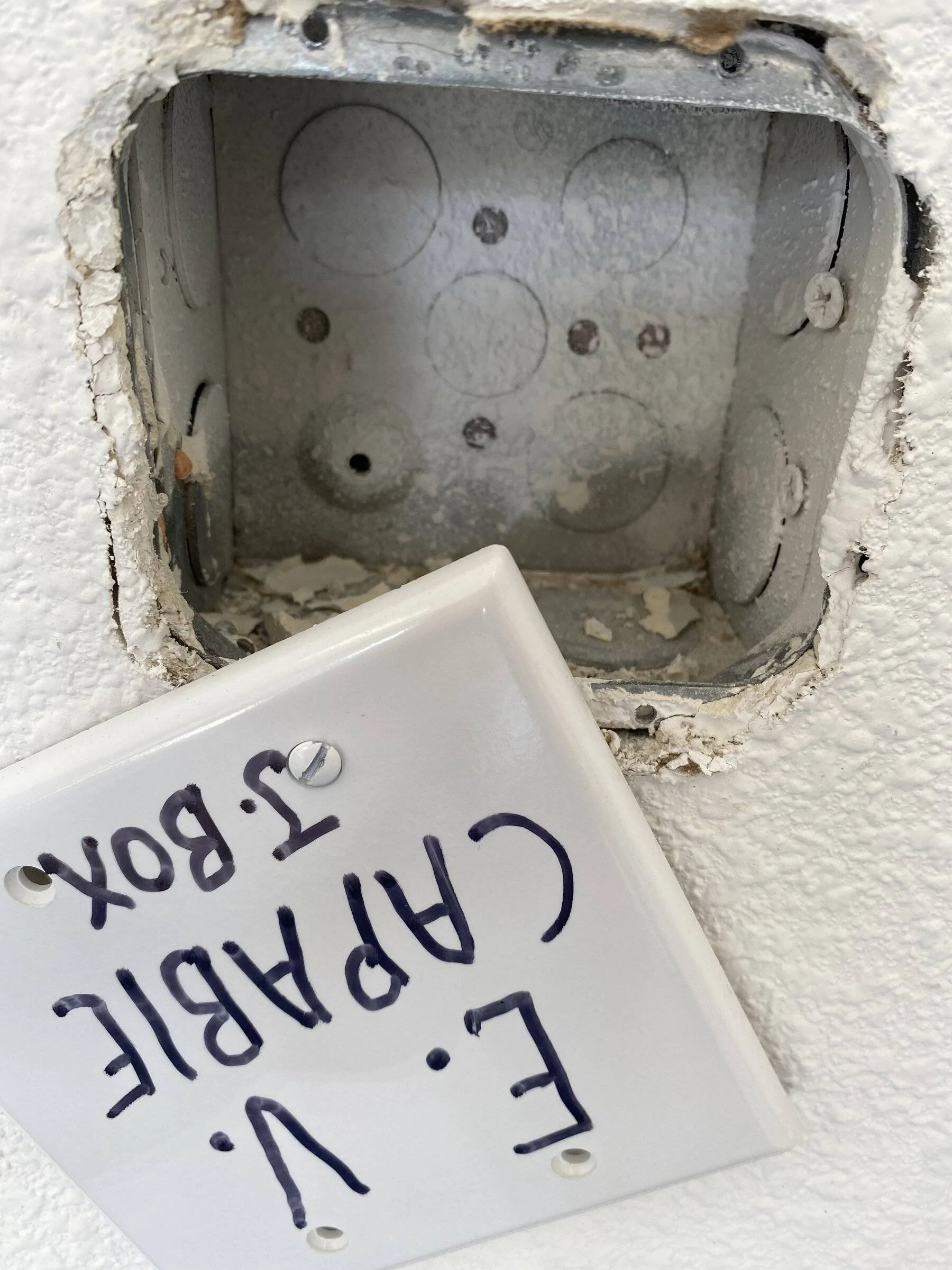

I was able to open up the slot and not sure if it gives me any more insight. Do I need to take this base plate off to understand which kind of plug the builders set me up for?
Also looking outside at the junction box for the garage I think I am only seeing 20 - 30 A setups.

thats just an empty Junction box, not pre-wired for anything.
You will need to have an electrician run wire between Jbox and a 50amp double-pole breaker in your Service panel, and add a NEMA 14-50 receptacle so you can use your Mobile Charger OR hardwire a charger of your choice.

And I cringe when I see electrical boxes mounted with drywall screws! ?

Why the screws side ways!!!!!!!????????
