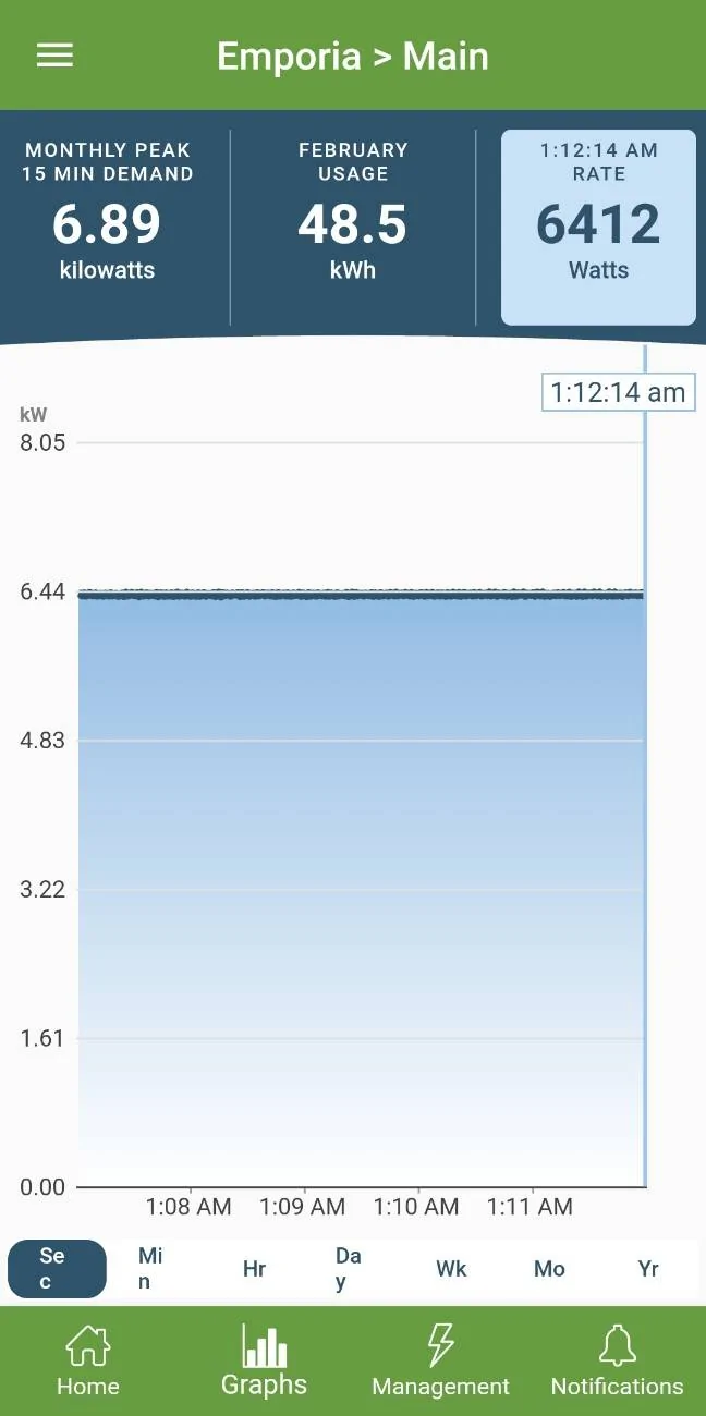

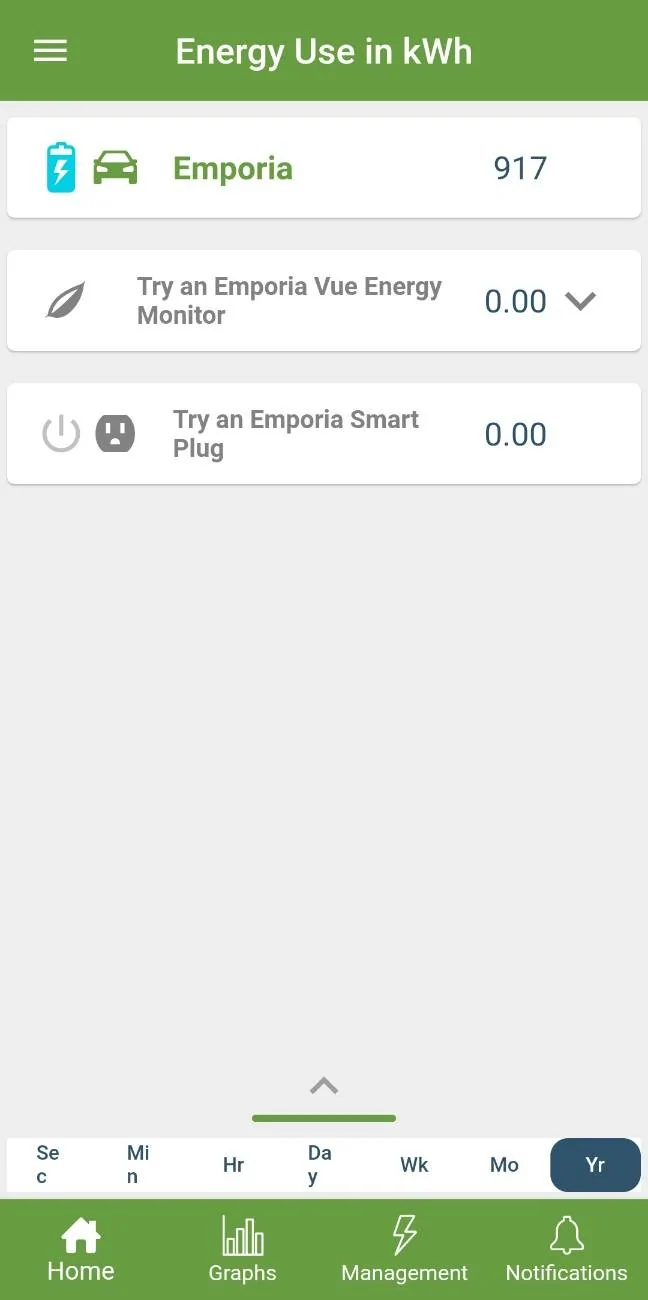

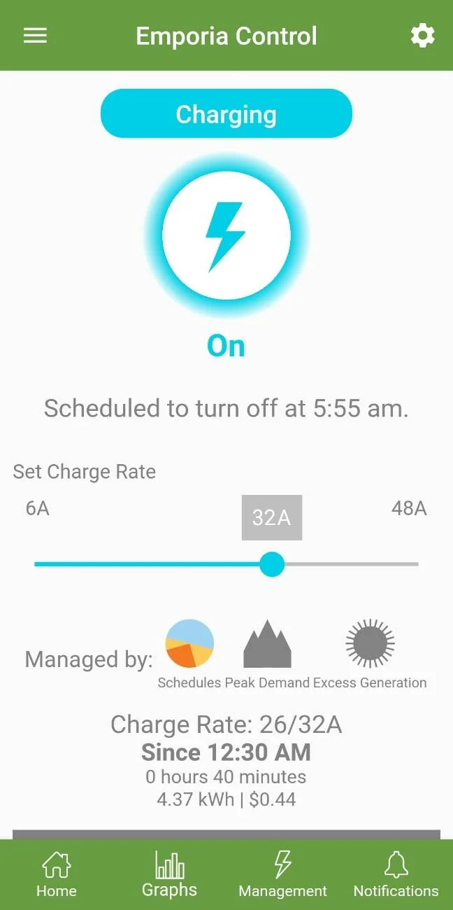

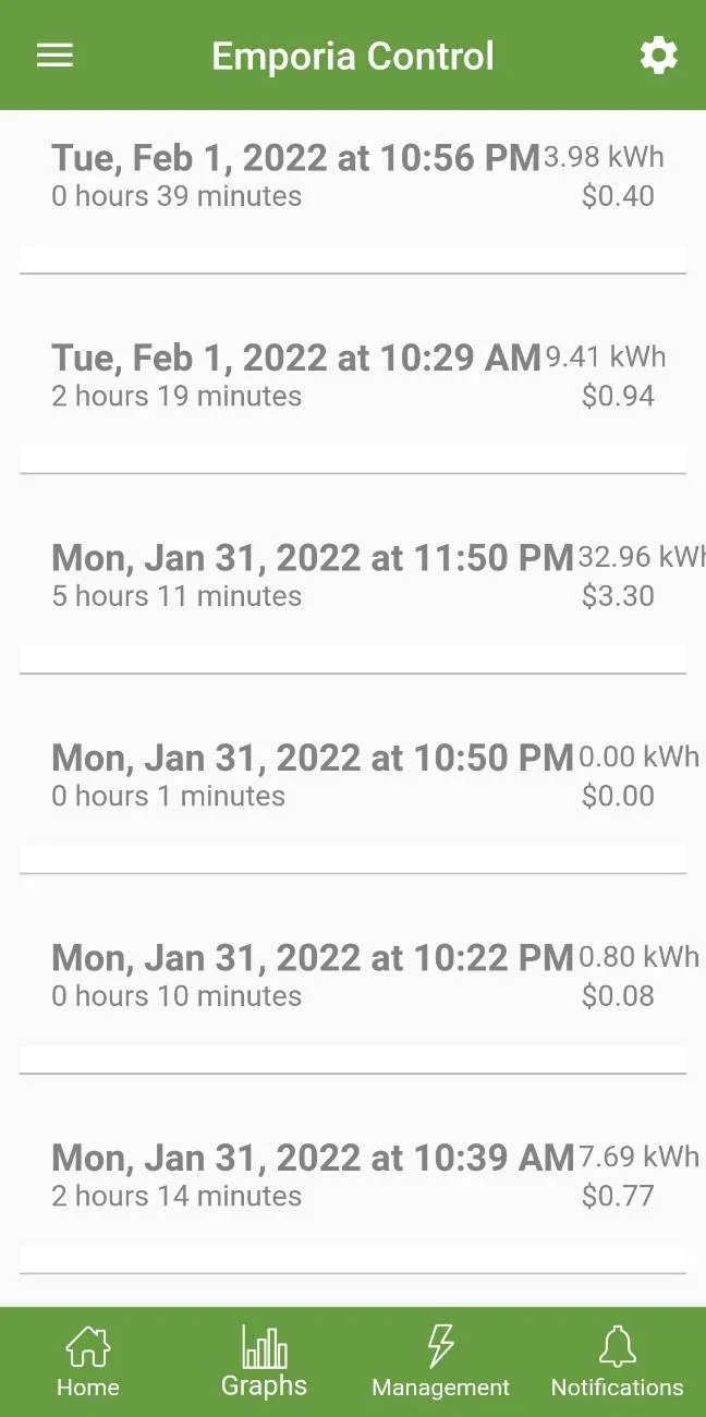

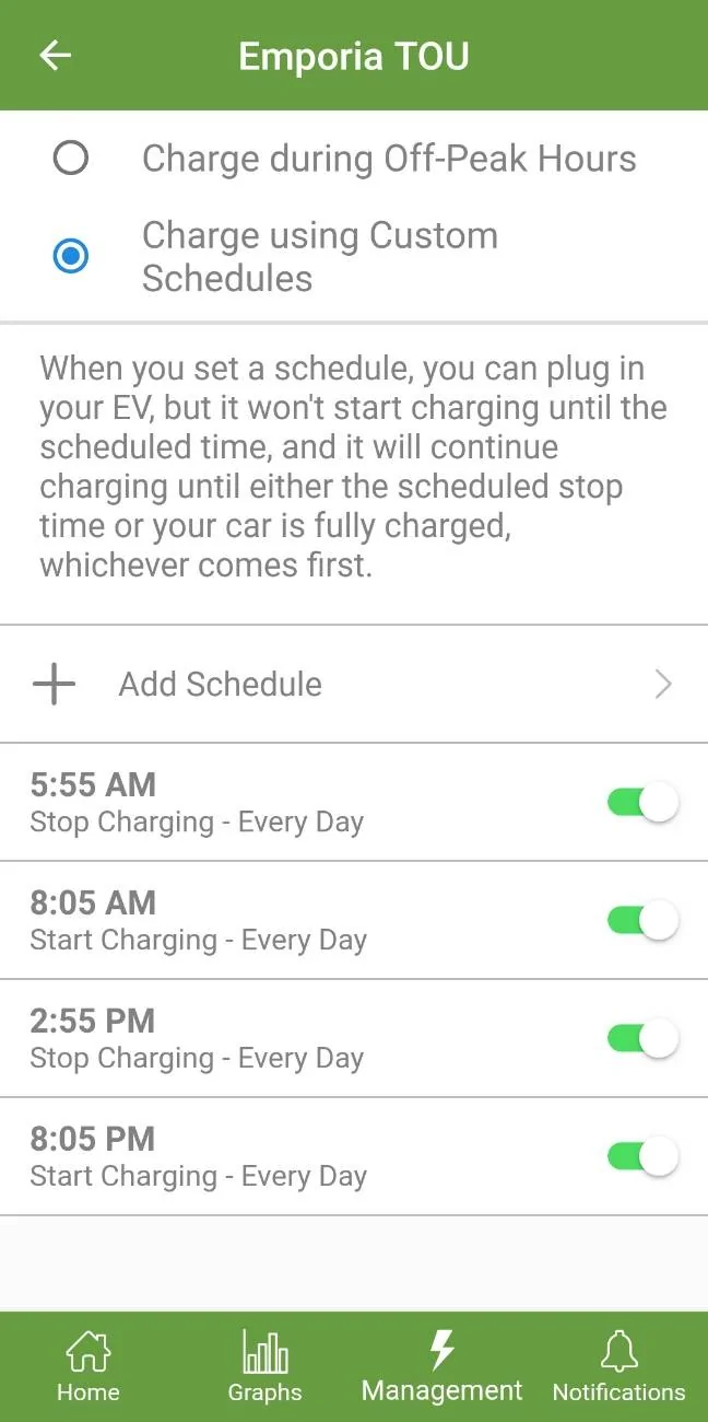

Ok, so I turned off my router to test if it works without WiFi and it functions normally. I have it set to not charge between 5:55-8:05. I plugged in my car at 8:03 and it waited until 8:05 and started charging. So even if it's not connected to WiFi, it'll function like a dumb EVSE. The caveat is you have to pair it with the App at first or it'll just charge at the default 10A. After you set it up, it will remember that setting even if you lose WiFi.

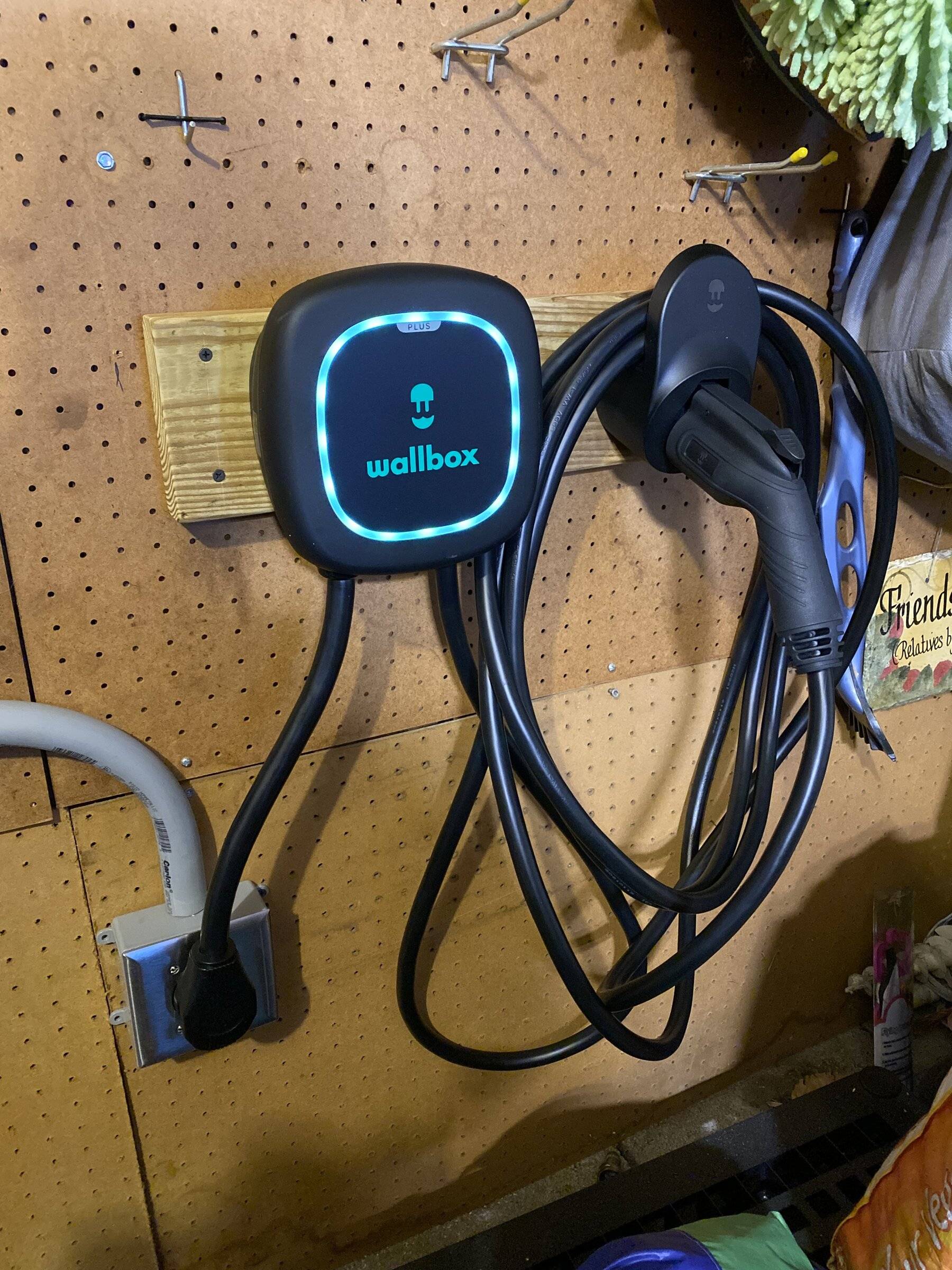

I bought the Wallbox 40. It’s great. Looks good (for those that care), has smart features, wifi, Bluetooth, great app, weatherproof, can throttle power with the app from 6A to 40A, great reviews, 3 year warranty. I’m very happy with it. One great feature is that you can have 2 units on one circuit and they will intelligently throttle the power to charge both cars. Great if you can’t add a separate 50-Amp circuit. They also have a 48 Amp version, but I stuck with the 40 & keep it set to 32A
Well, it does look pretty good compared to those seams on your pegboard. ?
