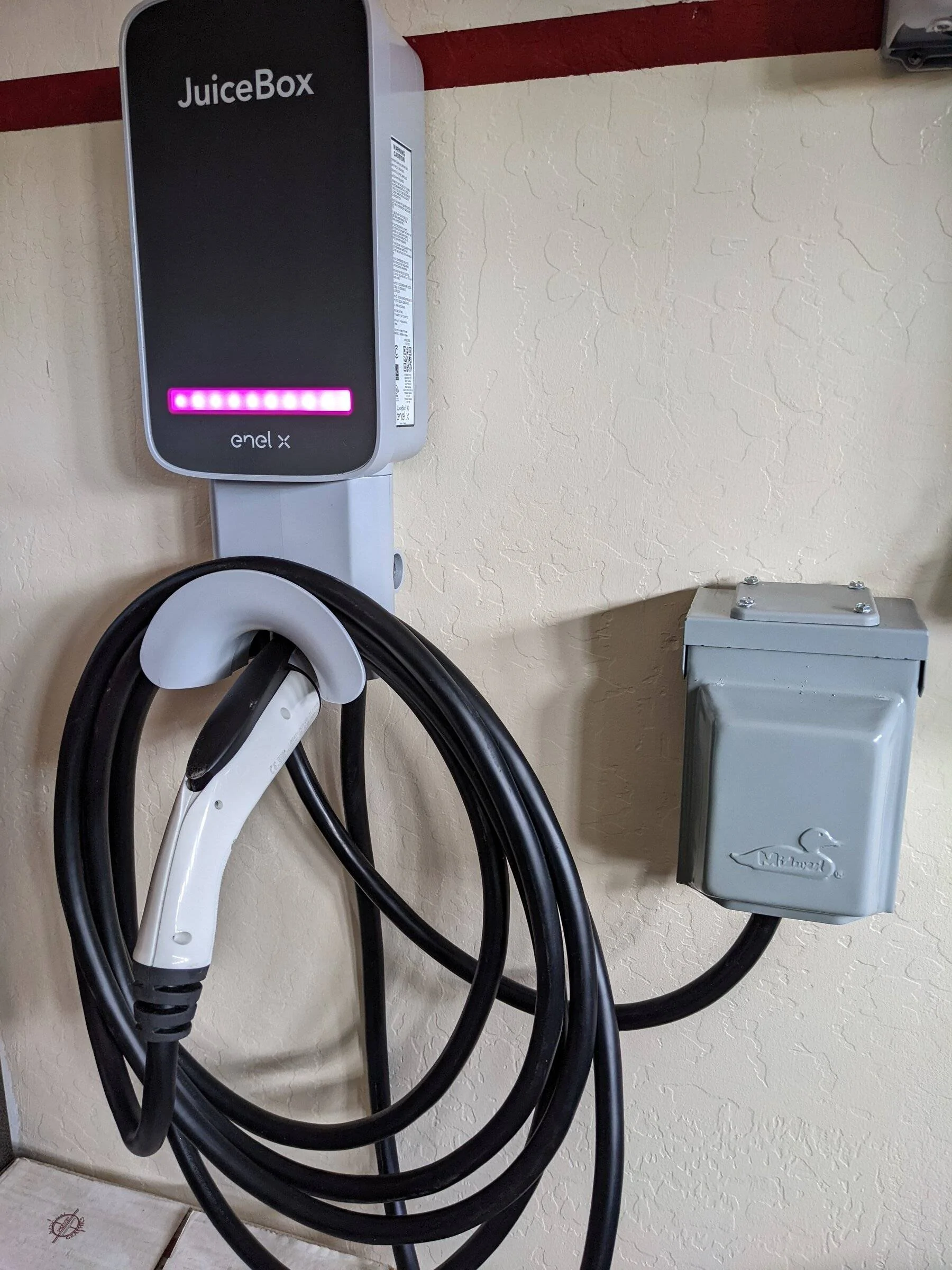

Just had a 240v line installed last week. Cost=$700. 50 amp installation for a 40 amp charger.
The electrician ran a 3 foot conduit line from the main circuit panel (which is outside) then drilled a hole into the garage and placed a nema 14-50 plug in the garage.
I used a licensed contractor.
Secondly, I choose a charger with a 25 foot cable. That gave me the flexibility to have the 240v line receptacle close to the main power panel reducing the cost by the electrician.
Good luck.

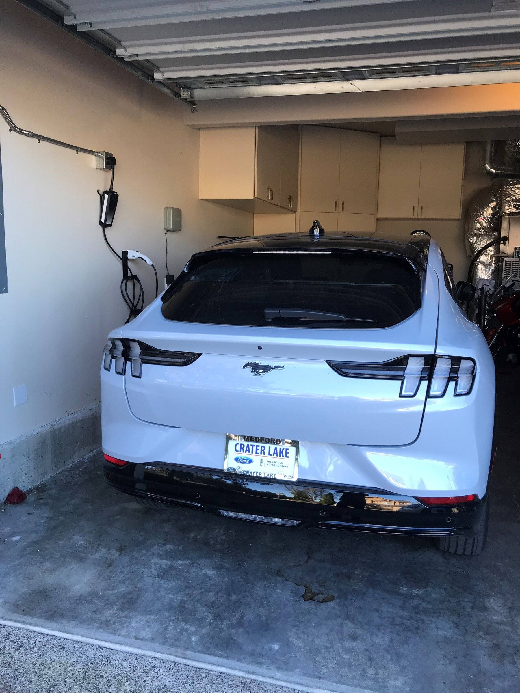

I had an electrician install a Nema 14-50 outlet in the garage and am using the Ford supplied charger that came with the car. It works just fine and even if I pull into the garage at 10 PM with a 20% charge the car is back up to 80% by 4 or 5 AM the next morning.
