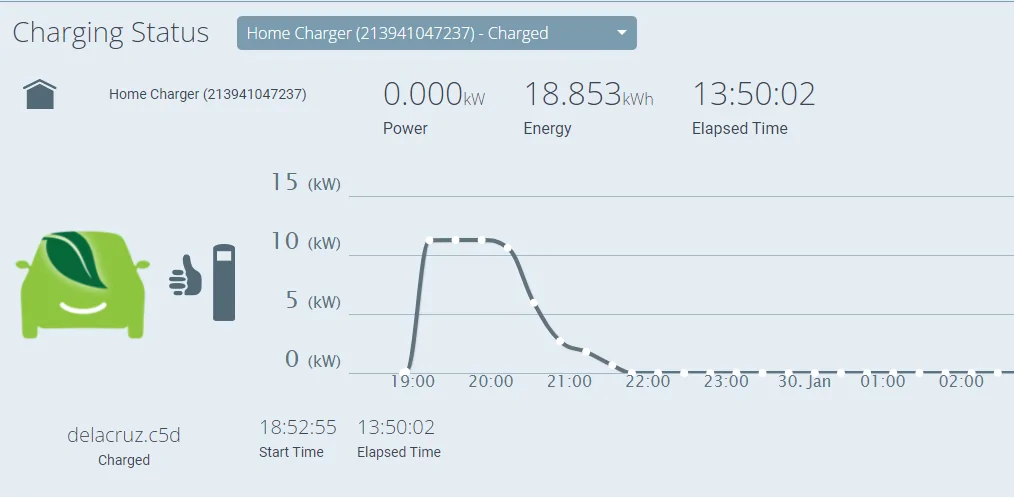

Honestly, the nicest thing about the ChargePoint is the charge graph. Data fascinates me in the dumbest way possible:
Ford Mustang Mach-E Which home charger? 1643554250797
I was charging to 100%, and at roughly 8:00 PM, you can see the power drop. That's when the car passed 90% SOC, and the charger in the car slowed down the power draw started to trickle charge/evened out the cells in the pack, or at least, that's what I think is going on.
